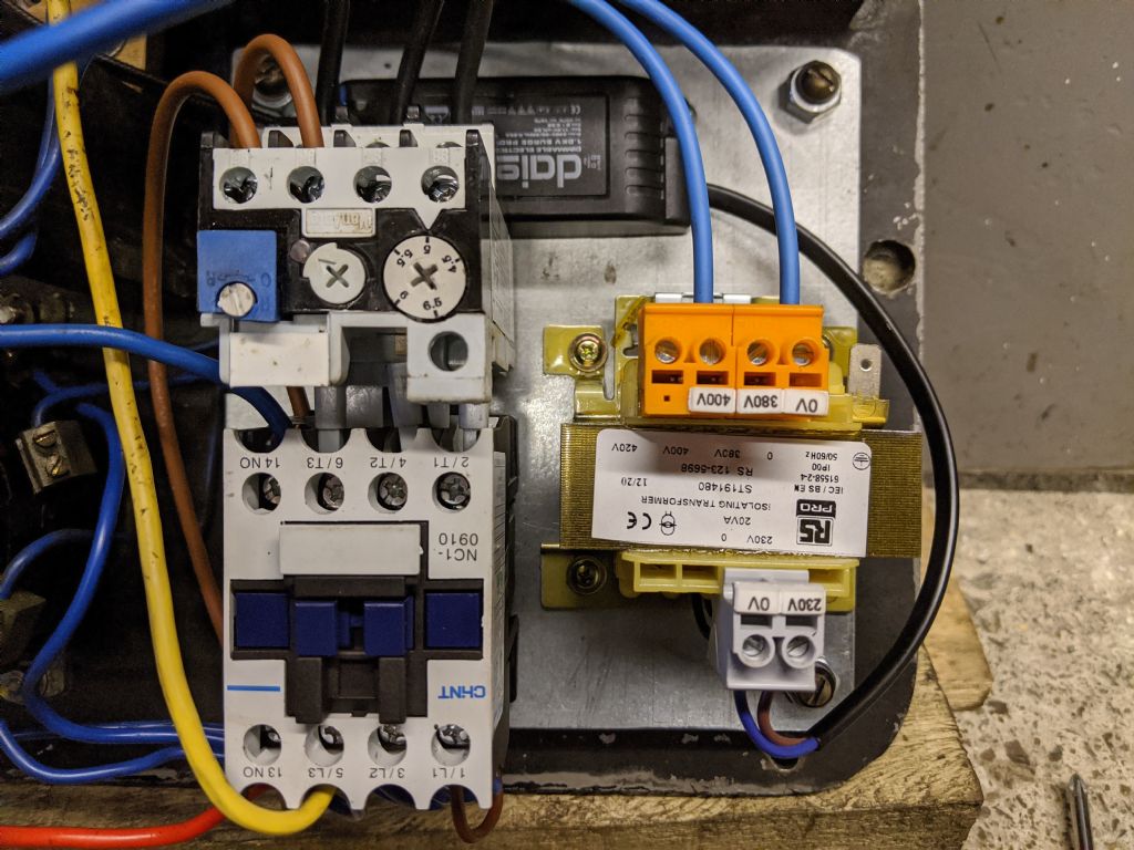

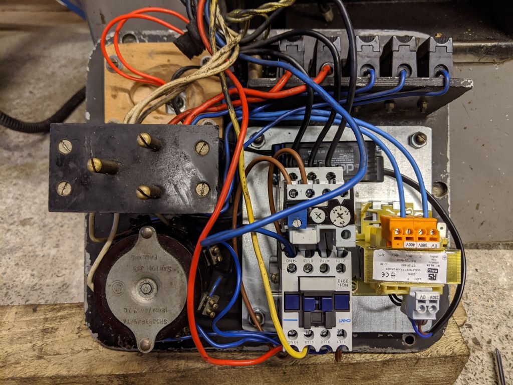

            Lighting transformer just arrived. I don't quite know how it needs to be wired

                Richard Kirkman 1
                  @richardkirkman1
                  Okay yes I have 2 wires to put in. So do I put one into the 415v hole and 1 into the 0v hole?
                  I have 4 holes in the orange bit I can use
                  0v 380v 400v 420v
                  And I have 2 wires from the slide lock fuses. So which go where?
                  I have the low voltage transformer attached to the top. That's fine since 2 holes for 2 cables is nice, I can do that
                  #464833
                  Phil Whitley
                    @philwhitley94135
                    2 wires from the slydloc fuses, one into 420 and one into 0V , watch out for cooling, both tramsformers tend to rum fairly warm, and the led units run qiote hot as they are somtomes capacitance mains droppers.

                          Richard Kirkman 1
                            @richardkirkman1
                            Any issues with this? Or does it all look fine
                            Also, how can I test this without having a bulb?
                            #465009
                            Phil Whitley
                              @philwhitley94135
                              looks good to me, can you check for voltage at the back of the lampholder, otherwise, you will have to be patient and wait for the bulb.
                              Phil
                              #465015
                              Phil Whitley
                                @philwhitley94135
                                Actually I would use the 420v hole to be on the safe side, phases from the phase convertor may not be perfectly balanced voltages!

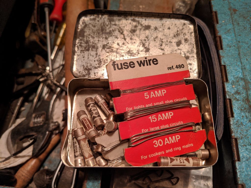

                                  I'm not getting continuity between the slide lock fuses for the lighting bit.
                                  I'm also not getting continuity over the transformer, but I think that's normal?
                                  #465115
                                  Phil Whitley
                                    @philwhitley94135
                                    Fuses blown? I think they are rewirable types, 5 a fusewire. If it never had the transformer fitted there is a possibility that there is no wire ever been fitted in the fuses.. Testing the transformer, you will get continuity between 0v and the tappings on the input side, and ov and 240 on the output side, there is no connection across the transformer,  the magneticc field created by the primary induces the output voltage in the secondary.

                                      Looks like my grandpa is helping from the great beyond. There's some fuse wire in his old tool box. I'll do that tomorrow
                                      I'll check for continuity between 0v and 240v tomorrow as well
                                      #465335
                                      Richard Kirkman 1
                                        @richardkirkman1
                                        Good progress today, fixed the fuses so they work now.

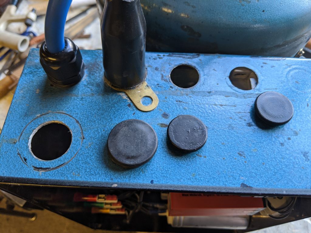

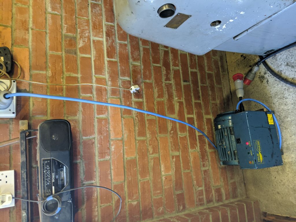

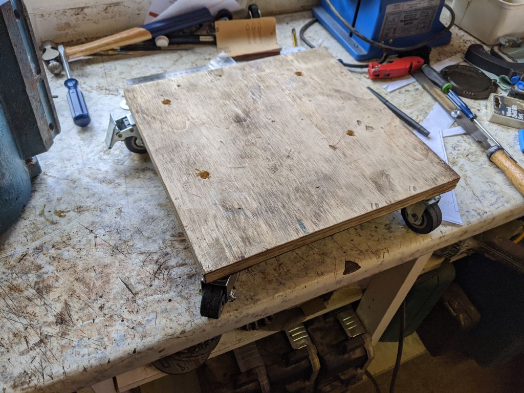

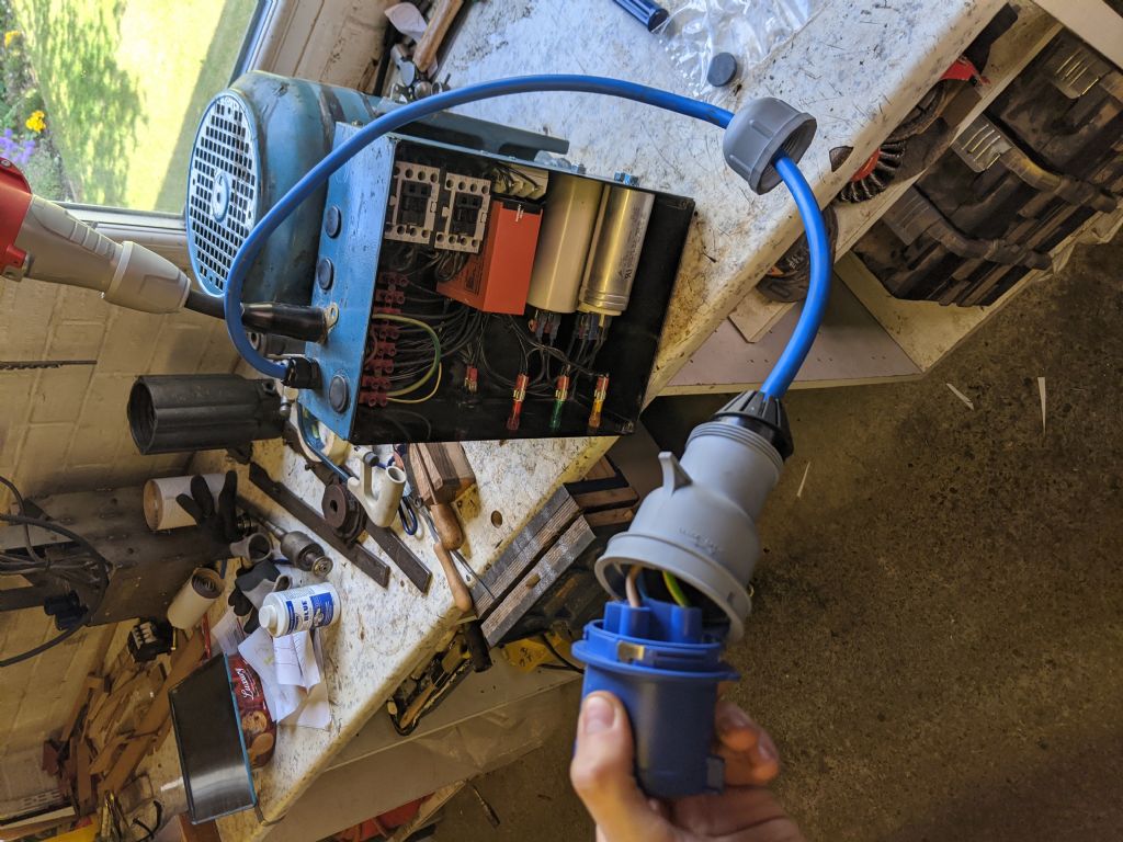

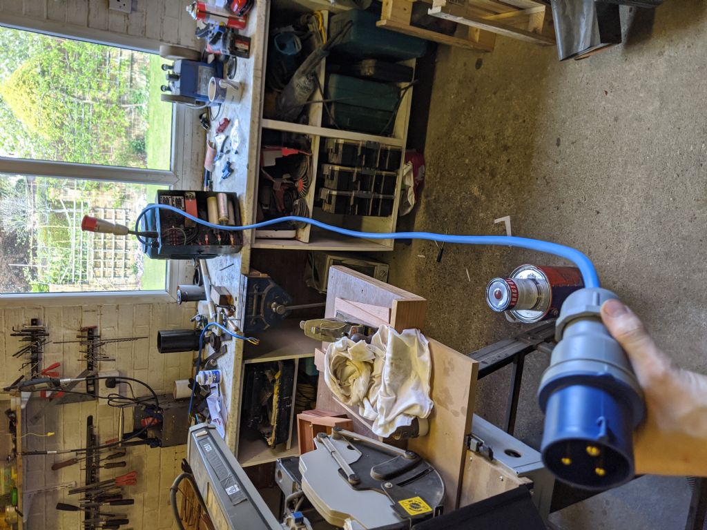

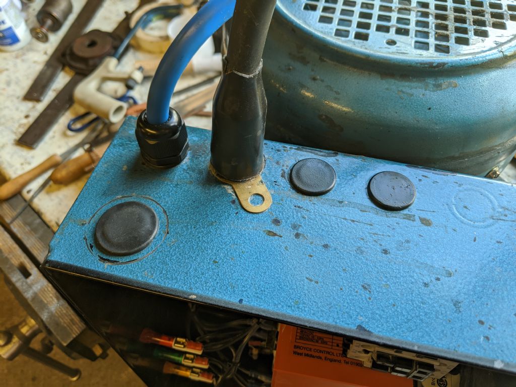

                                        Then the grommets and cable arrived for the phase converter so that's perfect now, it's on wheels as well so it can be moved around for sweeping and things.

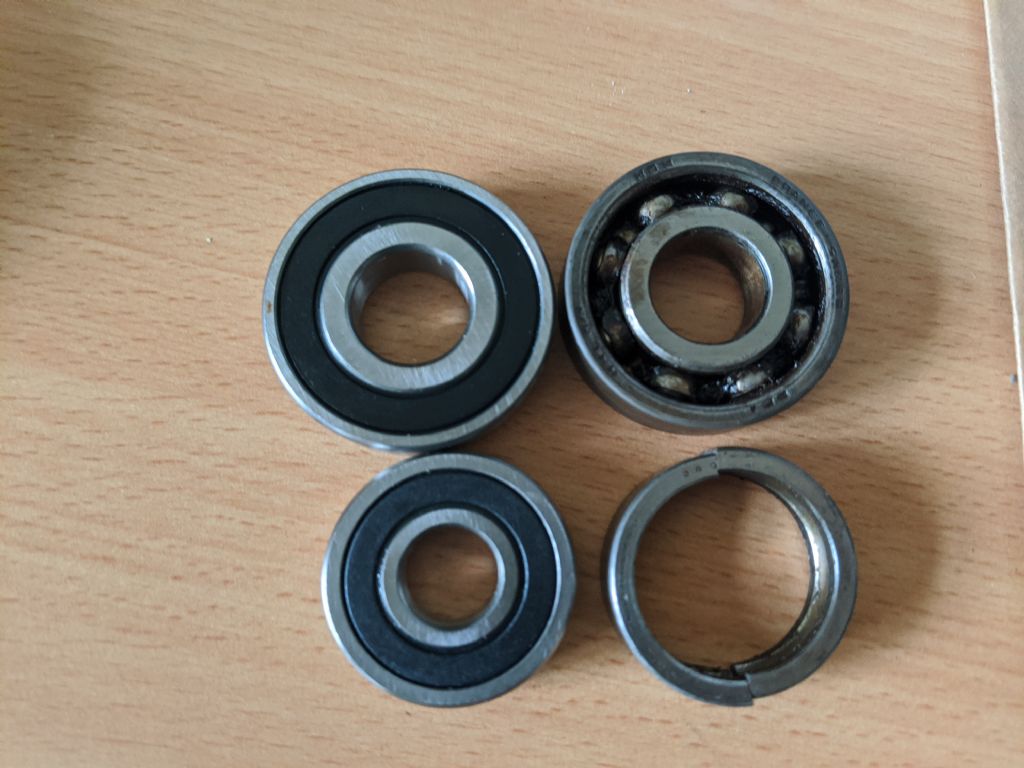

                                        Then the replacement bearings arrived
                                        So I cleaned the coolant pump properly and put it all back together

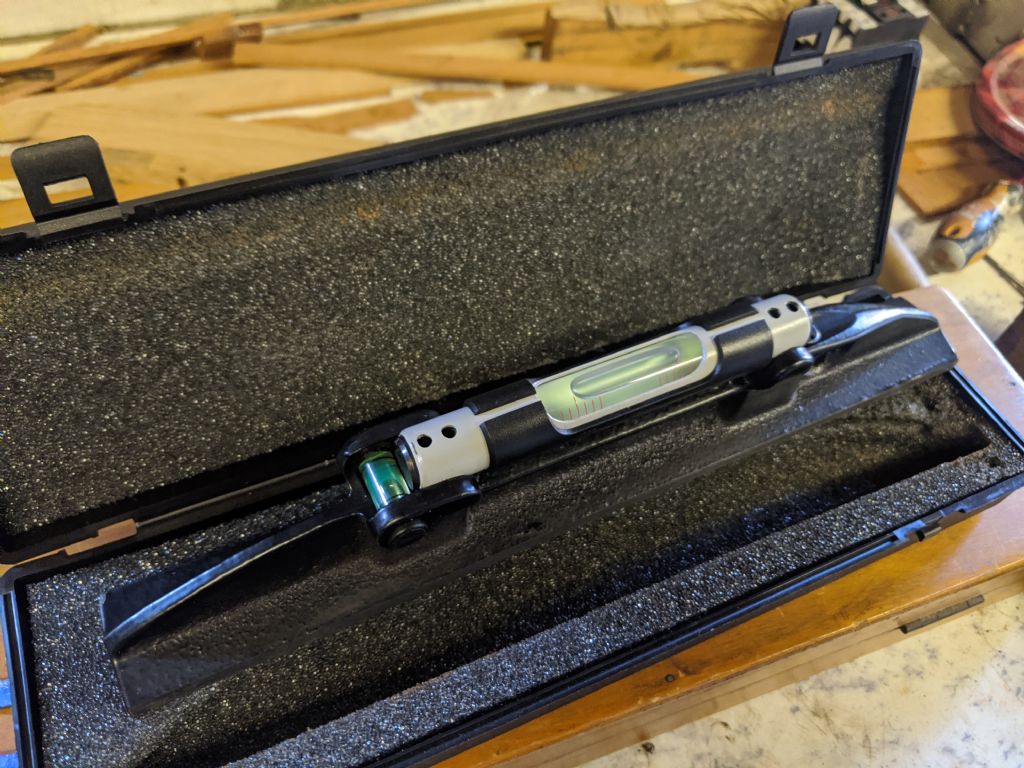

                                        Then, the precision level I found arrived as well. So I'll be able to measure the lathe bed when I get around to it
                                        The height gauge I ordered also arrived, but I've never used a height gauge like this before so I may have some questions once I've cleaned it up
                                        The coolant pump runs a lot quieter now
                                        Before new bearings
                                        After new bearings
                                        #465420
                                        Phil Whitley
                                          @philwhitley94135
                                          That sounds better, you've advanced a tech level!

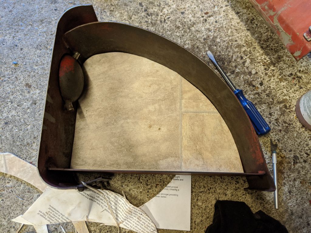

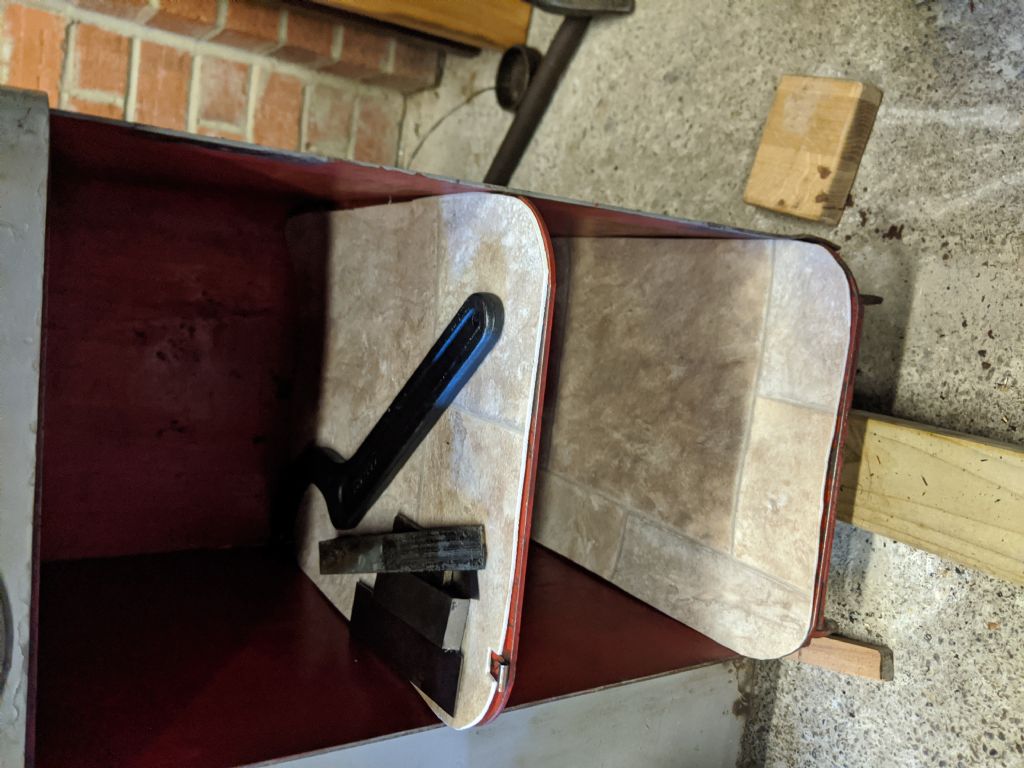

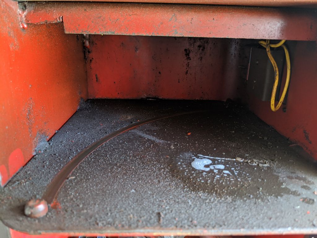

                                                I took the door and cupboard off to clean inside, then I cut some bits of lino to go in the drawer and shelves to make them a bit nicer to use. It works very well. I had some left over from putting it in my tool chest.
                                                Then I played around smacking the door and drawer with mallet to try and get them to close properly (there was more finess than that, but it was just playing)

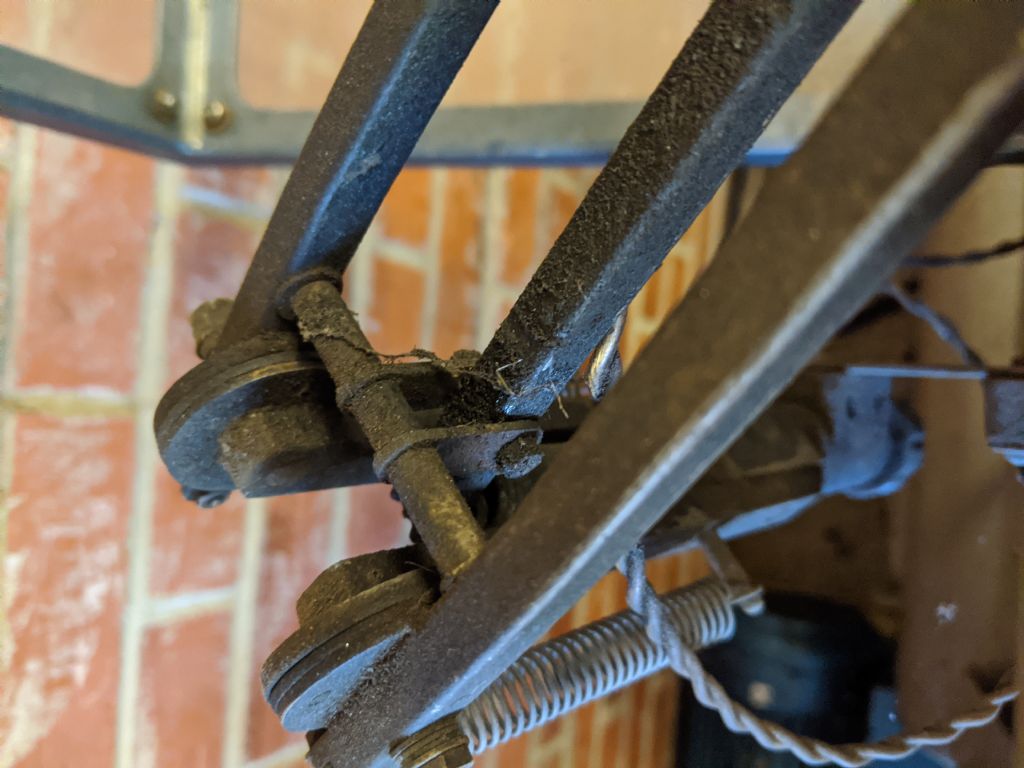

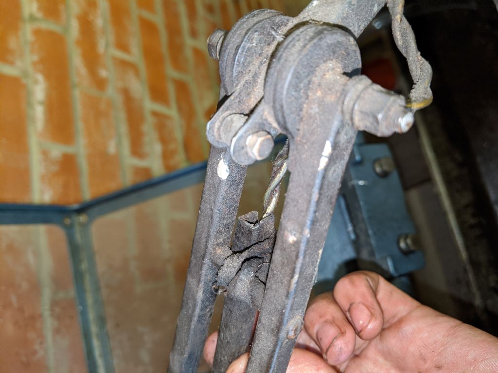

                                                Also, looking at the light, which needs a good clean, it might need some parts replacing or modifying. It seems that one of the arms has snapped. It still works fine and stays in place, but I think I may play with it as I clean it

                                                  WOW, that is the original Colchester angle poise lamp, now selling for a small fortune as a covetted item of "Industrial art" so named by a bunch of yuppies who call themselves antique dealers and specialise is industrial heritage items! Mine has a "common" MEM Memlite, which they only sell for £75.00! I am well green!
                                                  Phil.face 2
