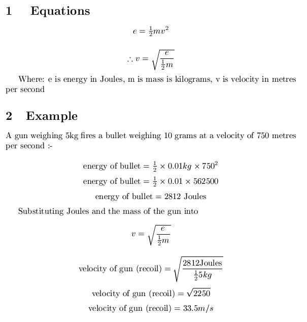

          Picking up on the challenge, with no apologies for working in MKS. (Dividing by 64 x 7000 indeed!)
          With thanks to Wikipedia for the approximate weights of the Lee Enfield and 303 bullet.
          From this I conclude that firing a Lee Enfield whilst holding the butt against the tip of one's nose would be a very bad idea! Has anyone who has done any shooting tried this?
          When the gun is held correctly, the mass of the soldier must become part of the system, helping to further reduce the effect of recoil, but it must still be quite a kick. This reminds me: for a few years I went to an Army Primary School in Malta that was part of a large Barracks. It had a firing range. Somehow we knew that many soldiers don't like firing practice and that some of them would bury live rounds rather than shoot them. We used to dig them up and try and set them off with small bonfires and rocks, never with any success. Ignorance is bliss!
          The same equations can be applied to the bottle rocket. The mass of the water is equivalent to the mass of the gun, and the mass of the bottle is equivalent to the mass of the bullet.
          As usual hoping I got the sums right!
          Edited By SillyOldDuffer on 09/10/2016 12:08:22

            Sorry, no. The same amount of momentum goes into bullet and gun. It's the average force generated by the charge over the time the charge is acting on projectile and gun in newton-seconds.
            p = mv
            so momentum of bullet = 0.01 x 750 = 7.5 newton-seconds
            momentum of gun = 7.5 newton-seconds
            velocity of gun = 7.5/5 = 1.5 m/s
            Which is rather less likely to rip your shoulder off your body…
            I remember doing this in school physics and it explains why most of the energy goes into the bullet. If you think about it the explosive force on bullet and gun is effectively the same, but the bullet moves much further and as energy = force x distance moved…

              Sackcloth and ashes again – I think you have a point about momentum. Not too sure about "most of the energy goes into the bullet" though, because every force has an equal and opposite reaction?
              Back to the drawing board for me. Where's that Physics Textbook gone, and why didn't I pay attention at school…

                    Regrettably, the evidence doesn't support my attempt at the recoil calculation. He's right and I'm wrong.
                    Much chastened the wretched duffer retreats to his workshop…
