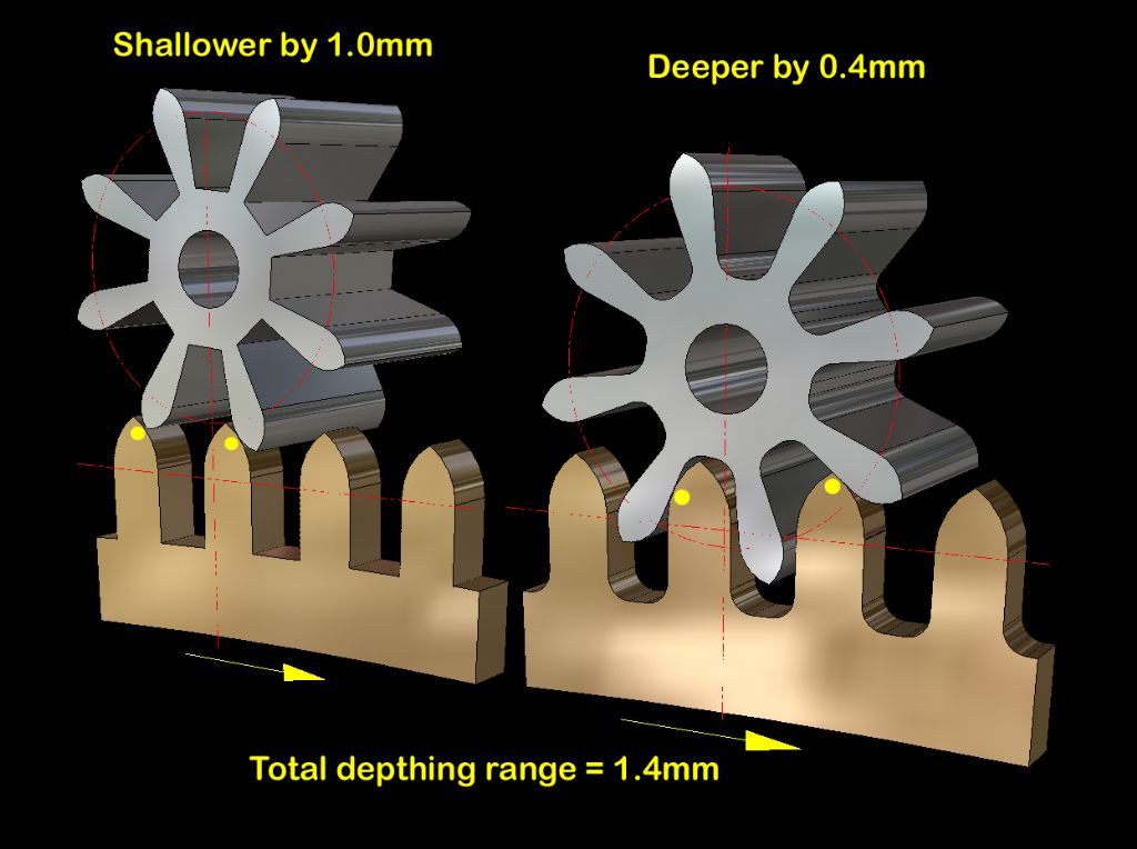

      Some final thoughts on cycloidal clock teeth
      #455104
      Sam Stones
        @samstones42903
        Apologies to those not-into-clocks.
        As with previous threads, I based the geometry of this wheel/pinion layout upon BS 978: Part 2 see…
        **LINK**
        and
        **LINK**
        In the previous threads on pinion/wheel meshing and depthing, I took it that the ‘optimum’ condition of meshing would occur when the respective PCD’s touched. Using CAD, (for the time being my easiest option), I decided to ‘go deeper’. An actual depthing exercise may prove this wrong.
        Without truncating the tips of the wheel teeth or deepening the pinion teeth (to weaken them even further), the limit to closing the gap (from optimum) was 0.445mm when the wheel teeth bottomed out.
        Having ducked the many hours of a full run through the fifteen pinion steps as before, my adjusted starting point revealed that at 0.4mm (0.045mm short of bottom), the trailing edge of the next wheel tooth was contacting the pinion tooth next in line.
        For reference, the yellow dots indicate where contact is made, and where jamming may occur.
        As a slight deviation, members may question the reason for ignoring root radii. Seen on the left of my illustration, un-radiused pinion teeth are so much weaker. Not only are they thinner at the root but the sharp notches invite premature failure. Even the (seemingly token) radius of Swiss Standard NHS 56704 appears insufficient.
        I welcome your answers.

                      In a former life of suffering endless report writing to which I was never fully tuned, we were encouraged to create a title that more than adequately posed the issue.
                      With a prompt from earlier, (good onya Michael) here’s my effort …
                      In clock making, how does the sweet-spot equate to the theory of cycloidal gear-meshing?
                      Before I reply to the above responses while risking repetition and appearing smug, my experience of clock building is a one-off skeleton clock designed by Mr John Stevens. I drilled the pivot holes into the plates before I made the wheels and pinions. Although I eventually owned a copy of ‘Watch and clock making and repairing’, by Mr W J Gazeley it was already too late to apply the recommended method of depthing.
                      Well may you shudder at the ugly tooth shapes I generated. Here’s the evidence …
                      … but it worked and they are not even cycloidal or involute.
                      Well, the clock ticked unaided first time around.
                      John, Jumping ahead, I would have been in deep poo had I been fitting ball bearings, and the clock didn’t work.
                      Thanks Michael on at least two counts. I forgot to mention that I had returned to applying the theory to the 290-8 wheel/pinion pair in the Wilding large wheel design, while continuing blindly to follow the BS 978 data. This latter item along with the Swiss Standard NHS 56702, 3, and 4 was presumably, developed with a great deal of cerebral input with an eye on economy. The A, B, C of tooth addenda you highlighted just adds further to the complexity of surpassing practical depthing with a theoretical solution. Also, your observations put succinctly as always, address what I’m getting at.
                      Roy, I fully align with your comments, if only I had more than CAD.
                      Martin, At a theoretical level, cos that’s all I’ve got, I imagine ‘ideal meshing’ to be a sort of sweet spot where, subjectively, the transfer of energy is both smooth and efficient. How it’s achieved at a theoretical level, I can only imagine the requirement of a high degree of complexity.
                      Doesn’t the variable level of friction (from [tooth] entry to exit), further complicate a definitive solution?
                      This, to some extent, repeats the questions – Is there (likely to be) much of a detectable difference between the theoretical pivot centres as per the standards and those for the sweet spot, wherever the latter may be?
                      What allowance for tooth wear is necessary? I’m really out of my depth (pun?) here.
