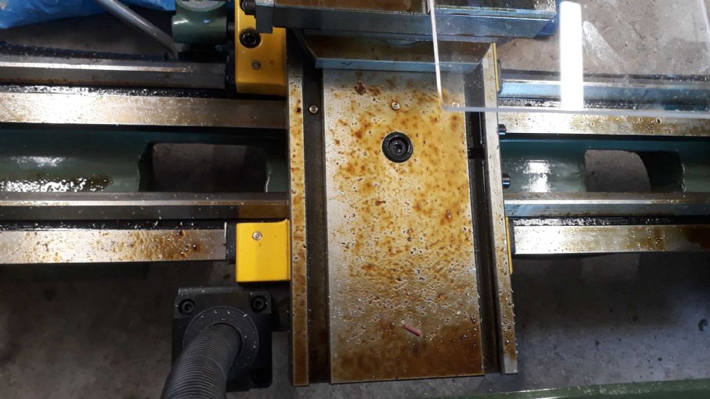

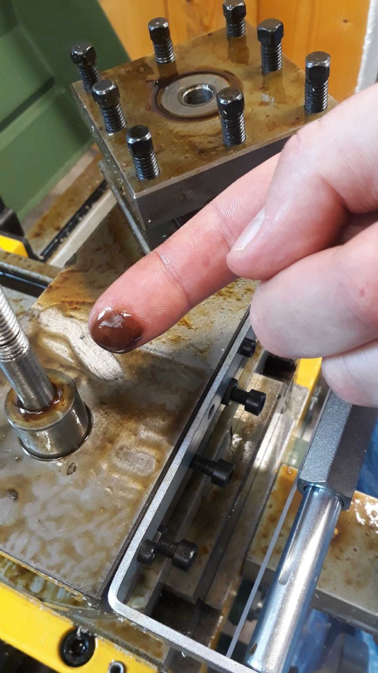

      Hi all, hopefully it's ok making a new thread for this – it is likely generally applicable to any new machine of Far Eastern origin…
      My new Chinese-made lathe has arrived smothered in a tasty mixture of grease and grit. I think I've seen this referred to as "chicken fat" on here? If so, this particular blend has a lot more grit in it than any chicken fat I've seen…
      Obviously this needs to be cleaned off. My question is, how far do you need to go? Anything that I can see or can be easily removed (eg: tail-stock) is a given – but if one assumes that this grit could be anywhere in the machine, then this suggests taking all the gears out and cleaning them, opening up the apron to clean the gears there, etc.
      How far is it prudent to go? My fear is getting things back together if taken to extremes…

                      Here's some pictures…
                      This could be totally normal or all I know. The superficial stuff that you can see doesn't bother me, that will all be cleaned up. I'll then open up the apron and see how it looks. If it's free of dirt/grit then I'll leave well enough alone…

                            Posted by Jed Martens on 31/07/2019 17:03:01:
                            Eeeeeuwww… that's a good deal worse than I think mine was in 2015. I never looked in the apron gearbox until the crossslide leadscrew shearpin fell into it in 2017 – then there was grit at the bottom but the gears didn't pick it up and the oil pool was clean (-ish angel)
