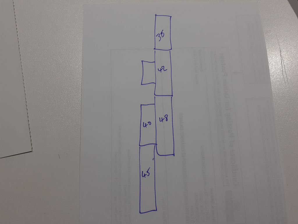

                                              If it is a 1.5mm pitch leadscrew then the chart gives the right ratio but you need a bit of cunning to work it out.
                                              36 on spindle drives the 42 = 0.857
                                              24 is there as a spacer so the 42 does not move about.
                                              42 drives the 48 = 0.875
                                              40 drives the 45 on the lead screw = 0.888
                                              So multiply thos etogether 0.857 x 0.875 x 0888 = 0.666
                                              0.666 x LS pitch of 1.5 = 1
                                              Sketch shows there should be no clash of gears

                                              #518862
                                              Ian Mellors
                                                @ianmellors72388
                                                Nice one! I'll give it a go, still trying to stuff Christmas in the loft (which is where my workshop is too)

                                                    Brian Wood
                                                      @brianwood45127
                                                      Jason,
                                                      Well done, I hadn't figured on gears being used as spacers, missed it completely
                                                      In the meantime I have worked out a greatly simplified chart for all the metric ratios quoted on the machine chart
                                                      I can't present a properly drawn out table so Ian will have to construct one for himself from these values
