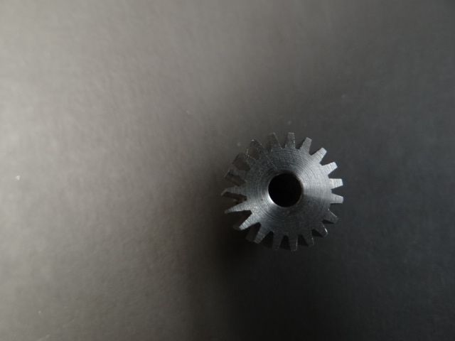

      This week's educational project was my first attempt to cut a gear. I made a fly-cutter formed to an approximation of the Meccano gear and attempted to reproduce Meccano Pinion 26. (19 teeth on a 13.7mm diameter blank, 38 or 40DP.)
      I eventually produced this flawed item.
      Most of what's wrong with the gear is due to mistakes and/or the inadequacies of my highly amateur attempt at making a form-tool.
      But the picture shows that the gear is cut far more deeply on side than the other, indicating a serious run-out problem.

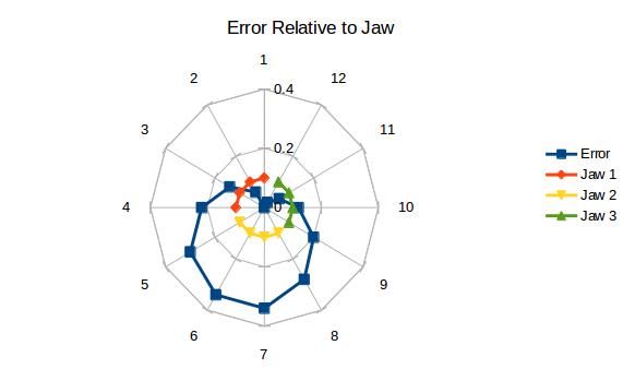

      The error is about 0.35mm. Tests with a dial indicator show that It's not due to to misalignment of the chuck on its adaptor, or to misalignment of the adaptor to the rotary table. The error is only serious on rod held by the chuck's jaws.
      Graphing the error relative to jaw position shows that jaw 2 is slack. I was able to drastically reduce the run-out by shimming the gear blank holder at jaw2 with some aluminium cut from a fizzy drinks can.

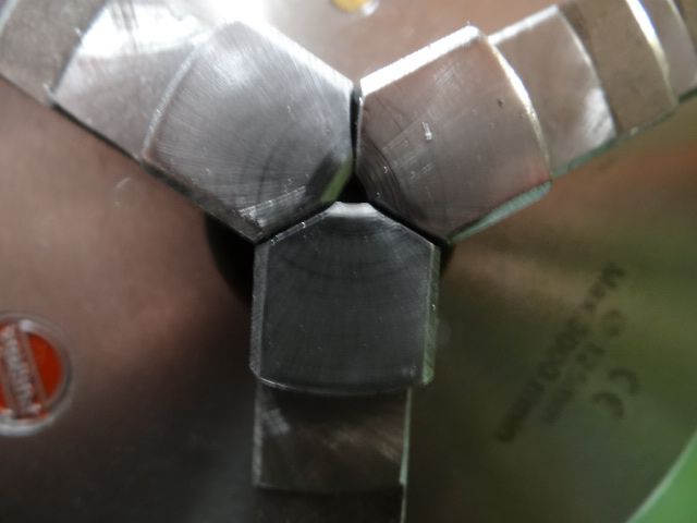

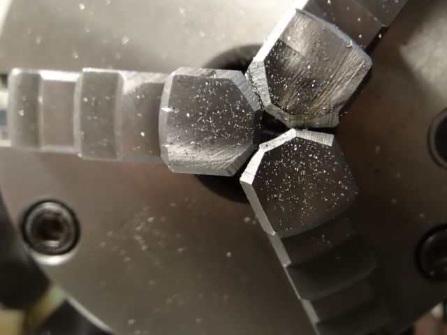

                            Quick lack of progress report with special thanks to the two Michaels. I'm going to have a good look at the scrolls later, but the chief suspect now is the jaw grinding. If this is the fault, it means that Inspector Clouseau here has been using a squiffy chuck for over 2 years without noticing!
                            This picture is of the jaws in my lathe. The chuck is satisfactory and you can see that there's a reasonable triangle where the jaws meet. (Jaw 2 is on the left.)
                            Next picture is the offending Rotary Table Chuck, where the jaws meet in a noticeably coarse triangle.
                            Ian P's suggestion about using a different technique has considerable appeal and reminds me again that there's usually more than one way of skinning a cat. And now I wonder how much of the quality work I admire so much is produced by people who know how to overcome the shortcomings of their tools, not by using high-end kit? If that's the name of the game I still have lots to learn!
