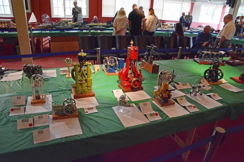

              Mark,
              I guess it very much depends on what you want to do with your lathe. I've probably become notorious by now for my love for my Myford, it suits very well what I like to make – various model stationary engines and some forays into 3 1/2" locos. BUT, I knew the provenance of my second hand Myford from new. If I were starting again I would go for exactly the lathe you have suggested and I think the milling attachment which fits on the back of the bed would also be very satisfactory. If these types of lathes are good enough for JasonB then they are certainly good enough for me.
              Some of Jason's work at the recent MEX:
              HTH,
              Rod
