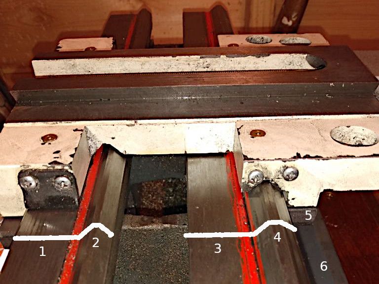

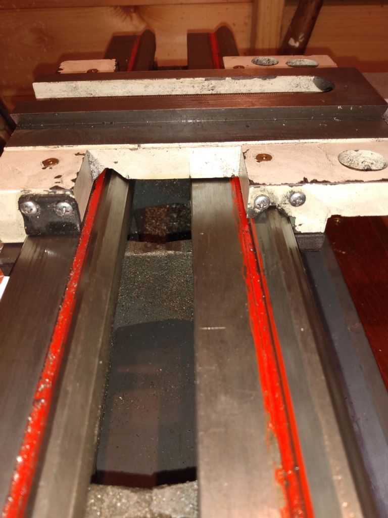

        is this how the apron should sit on bed. the right one looks ok but left seems in wrong place. any help please
        #533648
        Ian Parkin
          @ianparkin39383
          I’m sure that it looks ok your tailstock locates on the left hand “v”
          #533649

            At a guess I would say that the cross slide is using one trapezoidal way and one flat way. The tailstock will use the other pair of ways. The fact that that configuration has the way wipers points me in this direction.

              Hi Julian welcome to the forum. The side nearest to the operator should run on the inverted V rail and the far side shoukd just run on the flat surface both with a plate to hold down the saddle casting. The tailstock runs on the rear V rail and front flat surface with a clamp plate central to hold it down and clamp down.

                On my mini lathe, and my big one (12" swing over bed Warco BH600 / Chester Craftsman lookalike ) that is how the Saddle and Tailstock locate.
                Saddle locates on Front prismatic way and sits on Rear flat way.
                Tailstock locates on Rear prismatic way and sits on Fronf flat way.
                Looks as if you have a wiper missing from the Prismatic side of the Saddle.
                Possibly Warco or Chester Hobbystore can provide replacement?

                  Just looked at my own Warco WM250 (made in the Weiss factory in Shenzen, China) and the carriage locates exactly as the above members have described, so yours is correct
                  Re missing bedway wiper, you need to rectify that asap or swaf will get inbetween the carriage and bed and cause damage – you can make your own bed wipers easily, just get hold of some 3-4mm dense felt

                          The Chinese lathe bed and saddle in the photo looks like it could be one of the 180 or 210 lathes, so 7 or 8 inch swing with 13,14 or 16 inches between centres.
                          It is certainly sat correctly. The underside of the saddle has a V way cast into it on the left side of the image which has plenty of clearance around the tailstock V guidway formed on the bed to ensure it does not touch it, as well as clearance over the flat tailstock guidway on the right, and so only contacts the V guide on the far right and the flat guidway on the far left of the image. This is typical of lathes with these type of bedways.

                                  The reason for asking question is I have adjusted the plates on saddle there good but I can twist saddle from left to right it is a bit hard to explain. Hope you can understand
                                  #533767
                                  Dave Halford
                                    @davehalford22513
                                    The rear gib plate should stop the saddle lifting at the rear. The front one is normally part of the saddle lock.
                                    With these adjusted properly the saddle should not be able to lift and twist on the ways. Could you have mixed up the gib plates?

                                      Some of those Chinese lathes have a rather dicky adjusting system on those two lift plates, aka gib plates, that can need careful adjustment. There are typically two bolts that clamp the plate down and two others that work against them to stop the plate clamping down all the way solid. The two latter screws have to be adjusted so when tightening the two clamping screws down, you end up with about one thou clearance which will stop excess movement. A better fix can be to eliminate the extra two adjusting screws and set the plates to the correct position using shims.
                                      Otherwise, the saddle should be sitting down on the inverted V and should not be able to pivot. If it can, somehting is stopping it sitting down firmly. Look for grit, swarf, burrs or even the way wipers stopping full contact between saddle and V way.
                                      YOu could put a thin smear of bearing blue on the lathe bed and rub the saddle back and forth a couple times to get a reading on where the two parts are contacting. Should be along the full length and width of  both the flanks of the V way.

                                        I think the skewing is either bad wear or some swarf under the saddle, perhaps due to lost wiper. Is the flat way next to the V side showing any sign of contact? A bit of swarf here lifting the saddle will prevent contact with the V.
                                        You said above "plates" there will be one underneath at the rear, but where else?

                                          The plates should be adjusted so that the Saddle moves freely, but without slack. I E only just enough for a running clearance.
                                          As soon as the Saddle is clamped to the bed, it should be pulled down onto the prismatic way, for a positive location.
                                          In a similar way, when the Tailstock is clamped, it will be pulled down and accurately located.

                                            If you look at the OP picture, you can see two gibs front and back beneath the saddle, they are quite chunky. The front one seems to be marking (different colour band) what might be the top of the rack mounting. So maybe it's keeping the saddle from seating on the front way.

                                              Well spotted! It certainly does look in the picture like the gib plate there is dragging on the bed and would wuoild be lifting up the saddle in the process. Looks like the gib is too thick for that space available.

                                                  Not convinced, believe might be a perspective error, my interpretation:-
                                                  1. Rear flat that saddle runs on
                                                  2. Small prismatic way for tailstock
                                                  3. Front flat for tailstock
                                                  4. Large prismatic way for saddle
                                                  5. Front gib strip
                                                  6. Leadscrew cover or chip tray
                                                  I could of course be seeing thingswink

                                                    I don't like the way the rear gib strip sticks out from underneath the saddle

                                                      Could it be that the gibs have been incorrectly replaced in the wrong places? (ie Front should be where the Back is, and vice versa? )
                                                      Changing over might improve the ability to adjust.
