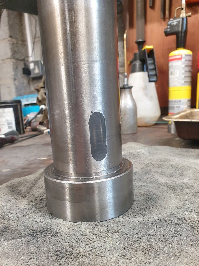

So after finishing the table and the surface plate being free again I placed the head on it sitting on the vertical saddle ways to see how that sits in relation to the quill.
Again, something of a shock.. with the quill extended a little under 5 inches and the indicator set to 0 nearest the head there was 0.04mm drop at the most extended part. Not bat at all.
However, I did notice when I was cleaning everything that when clean there was a bit more play in the quill to head bore than I though there should be. Lifting the quill gently takes the measurement from -0.04 to +0.12 at the nearly 5 inches extension. at 2 inches extension this drops significantly to 0.06 over all play.
Not bad really and if there is any extension of the quill required then the locks will be used.

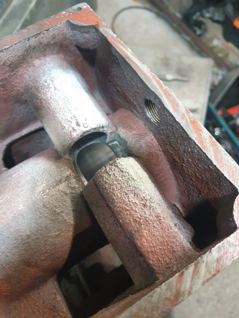

Now there's another thing.. the quill locks, the 2 brass slugs that come together on the quill are just machined with a taper that clamp to the quill barrel. Why on earth would you have a flat clamping a cylinder??
Another job.. machine the flats of the locks to a radius that matches the quill.. surely that will hold far better.

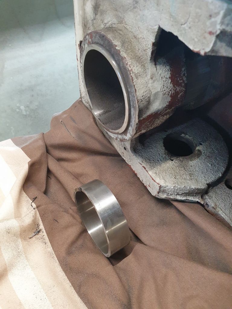

As for the quill to head bore play, it occurred to me that there is a perfect solution readily available and is done in multiple automotive machine shops all over the country. Fit a piston liner and hone to suit.
Westwood Cylinder Liners in Worcestershire do a liner – WCL 16CFL that is 74mm bore, 5mm wall thickness so no problem there and 238mm long with a flange. No idea of price but might look into that as getting the head bored and fitting the liner is a very common and straight forward job.. just cos it's not an engine block shouldn't be a problem (I hope!), it is an easy enough set up. Liner can then be fitted and bored to suit the quill (just shy of 75mm).
I can then open out the areas for the quill guide pin, pinion, lock etc easy enough with a die grinder and burr.
Only issue is I have to decide on this before doing the column as that has to be the final adjustment to true everything else up I suppose.. Dear oh dear.. every day there is a decision to male ay!

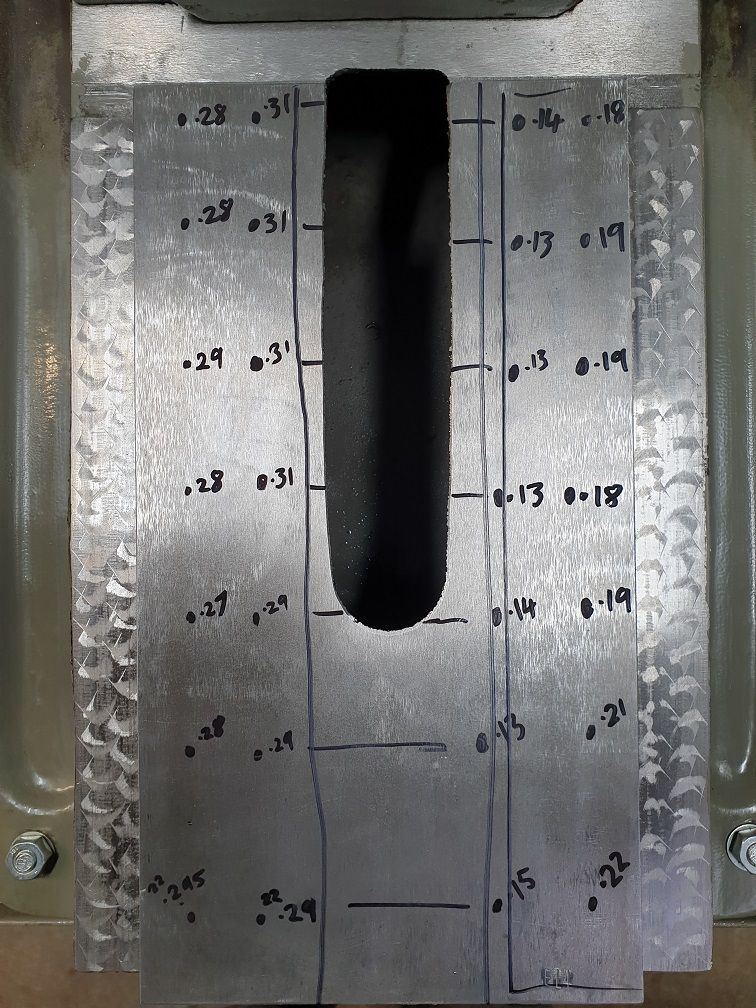

So in between shivering and trying to fit some celotex (other brands are available!) to the roof of the garage as I'm finally getting round to adding some insulation I have now managed to 'map' the base ways in a rough way.

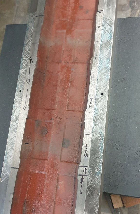

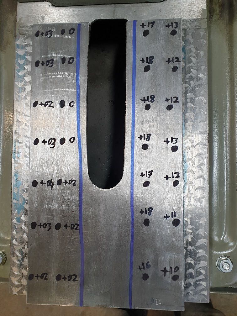

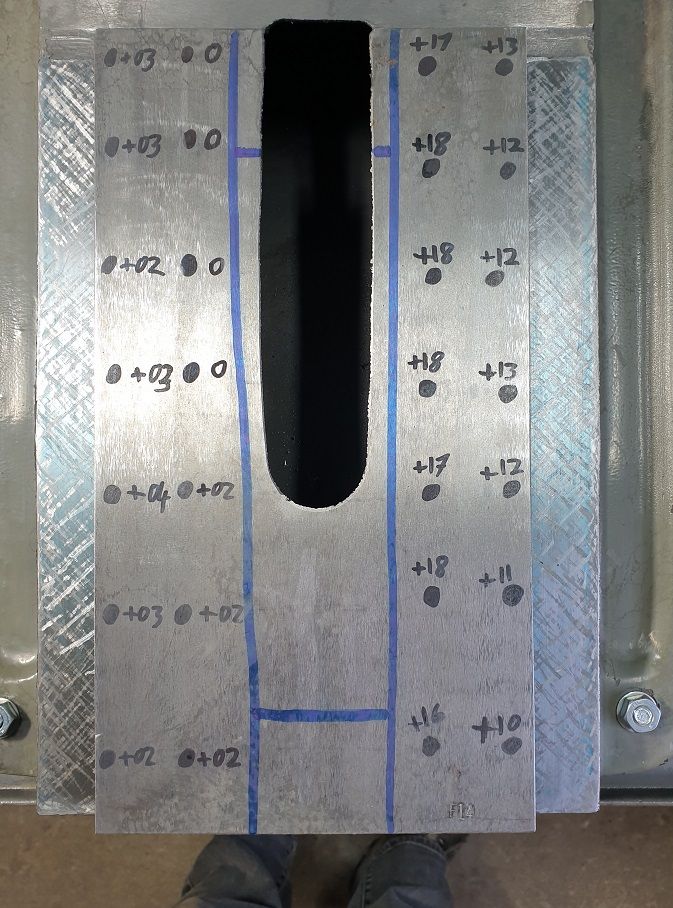

Making the assumption that the 'ground' (I use the term loosely!) surface between the base ways was intended as the reference surface to build the thing I used that to depth mic the ways. the base of the depth mic is wide enough to take a measurement close in by the dovetail and also out towards the edge of the ways.
The results ether mean I have a huge amount of scraping to do or there is a significant difference between the plane of the ways and the 'ground' surface.
Here are the depth's from the ground surface, just the decimal of the mm is there.
So, taking the .31 as the lowest point I re numbered using that as the 0 mark.
I also then took a heavy print and that seems to match up with the numbers pretty well so I have reasonable confidence in my measurements.
PS… If anyone sees cockups in my maths please let me know!
Back to insulating when the rest of the boards arrive then some scraping I suppose!
I think there is supposed to be clearance between that ground surface and the table above it. So, don't spend any time working to get it flat.
Martin C
Hi Martin, sorry, I should have been clearer, I have just written the measurements on the top surface to allow for taking a print and working our after scraping etc, they don't refer to the ground surface but points on the ways 22.** mm down from the 'ground' surface so my intention is to bring those 2 ways flat and co planer as best I can.
I've re-read your post and see what you are planning now. In that case I think you need to be careful using that surface as a reference plane. The level you used on the ground surface can bridge over low spots that a depth mic will not. Not knowing the order the surfaces of the base were originally machined in or how well the casting was aged before machining it puts its quality as a reference surface in doubt. I think you need to check the height of the scraped surface relative to the surface plate it is resting on. Shim it (or use machine jacks) so that three corners are the same height then take your measurements to find how the scrapped surfaces relate to those 3 corners. Put support under the fourth corner as well to avoid droop of any sort in the base casting.

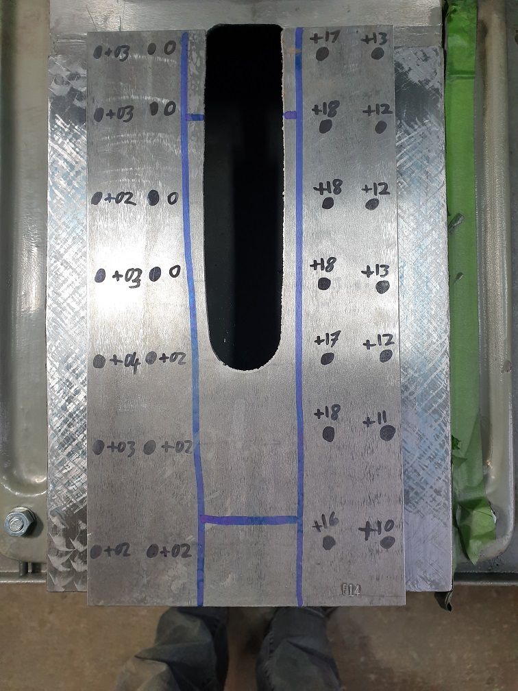

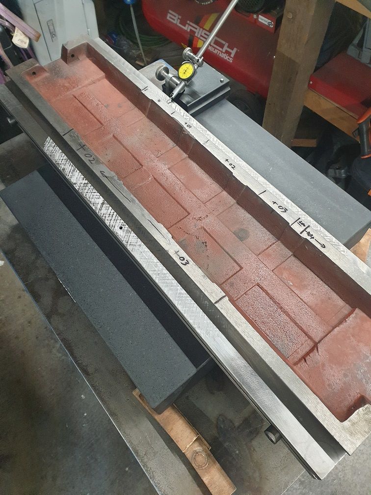

Unfortunately the initial measurements I took as depths form the 'reference' surface must have been pretty good as the amount of material that needed removing from the r/h side in order to start getting a sensible print was daft..
I started very light as I have done through out, mainly due to a lack of confidence but I ended up getting all neanderthal on the thing… eventually blue started appearing on both sides of both ways.. I thought I was going daft!
Just using the freshly checked saddle to print, I just did the centre section, placing it in situ and gently sliding it between the blue 'horizontal' lines marked on the face then once that was done, stepped it out to bring down the rear and front sections of the face until the blue on the already scraped section began to expand towards the higher bits then just went really careful until no matter where I placed the saddle with a light bluing I got a decent print. Same process as the table really.. seemed to work OK!
Here was the centre section almost done..
And here is the whole thing almost done.
I've given up trying to take pics of the finished article, with a very light print and shiny metal there is nothing to see so basically it looks similar to this but with a more consistent and shorter scrape pattern rather than the rough that is here.

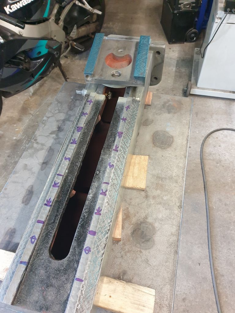

Arfnoon all..!

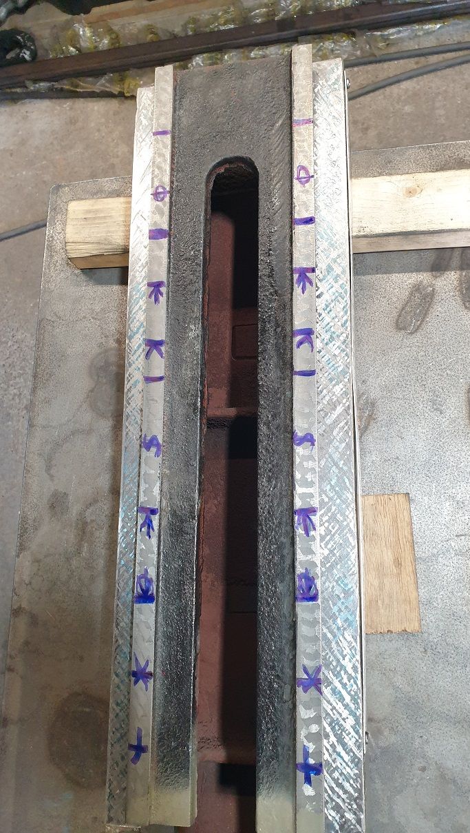

I hade a go at using the Column saddle to print to the column ways just to get an idea of how they are.
Re checked the saddle on the surface plate and gave it a light stoning .. all was good.
Inked her up and went for it.
Oh dear… I've seen straighter roundabouts!
I placed the saddle at various points on the column and just just a short rub back and for (about an inch only) so as to just look at the localised area.
At a guess I would say between 0 and 5% contact.. I say 0 as there were large areas that I simply wouldn't print.
No choice really but to go for it. Print, scrape move a couple of inches, print, scrape move etc etc.
I didn't concentrate on any one area at a time so as not to go too far and ruin the whole thing as an area further down may have brought the low area into the ball park so just kept working up and down until I had a reasonable print.
Here is a pic that I have set up with heavy ink (so it would photo!) just to show my method with the saddle and all the 'hieroglyphics' I was using to keep a reference on where I was moving up and down the column – it might make more sense to someone thinking about it…
At this stage I was just chasing the blue high spots to try to bring it even both sides.
This is getting close now, there were only a couple more goes to get decent prints regardless where on the column I placed the saddle so now I only have to try to scrape a few oil pockets into it and it's done (again, heavy ink set up and multiple prints just to be able to take the pic!).

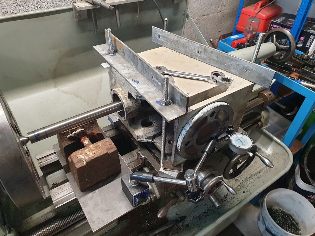

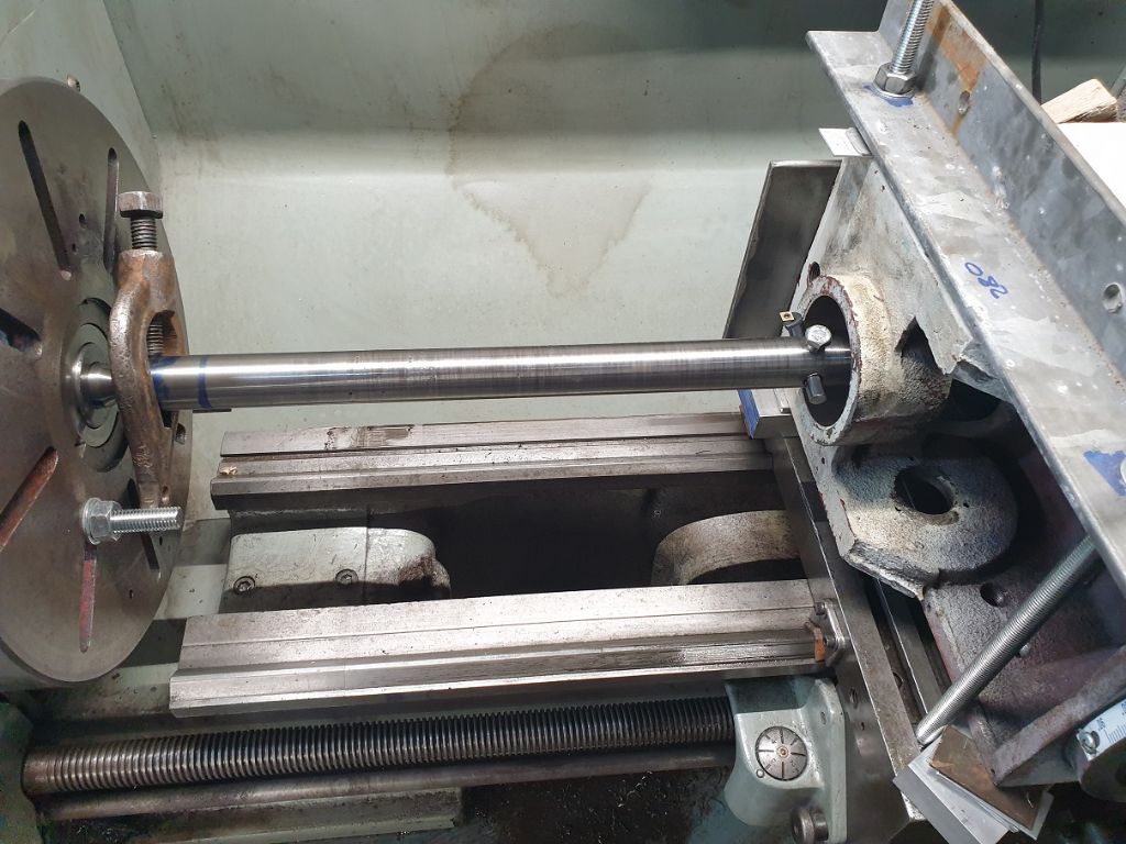

Well, after trying to get some prices for boring out the mill head and fit a liner to address the quill not being a great fit in the sleeve it seems that most places don't really want to do it (the're all busy to be fair) and the quotes I did were unfortunately a little unaffordable for me.
So.. if you don't try you don't learn I suppose..!

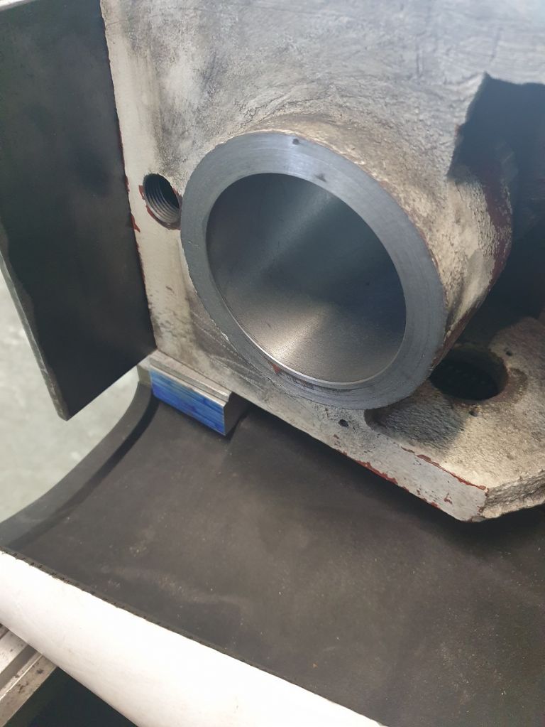

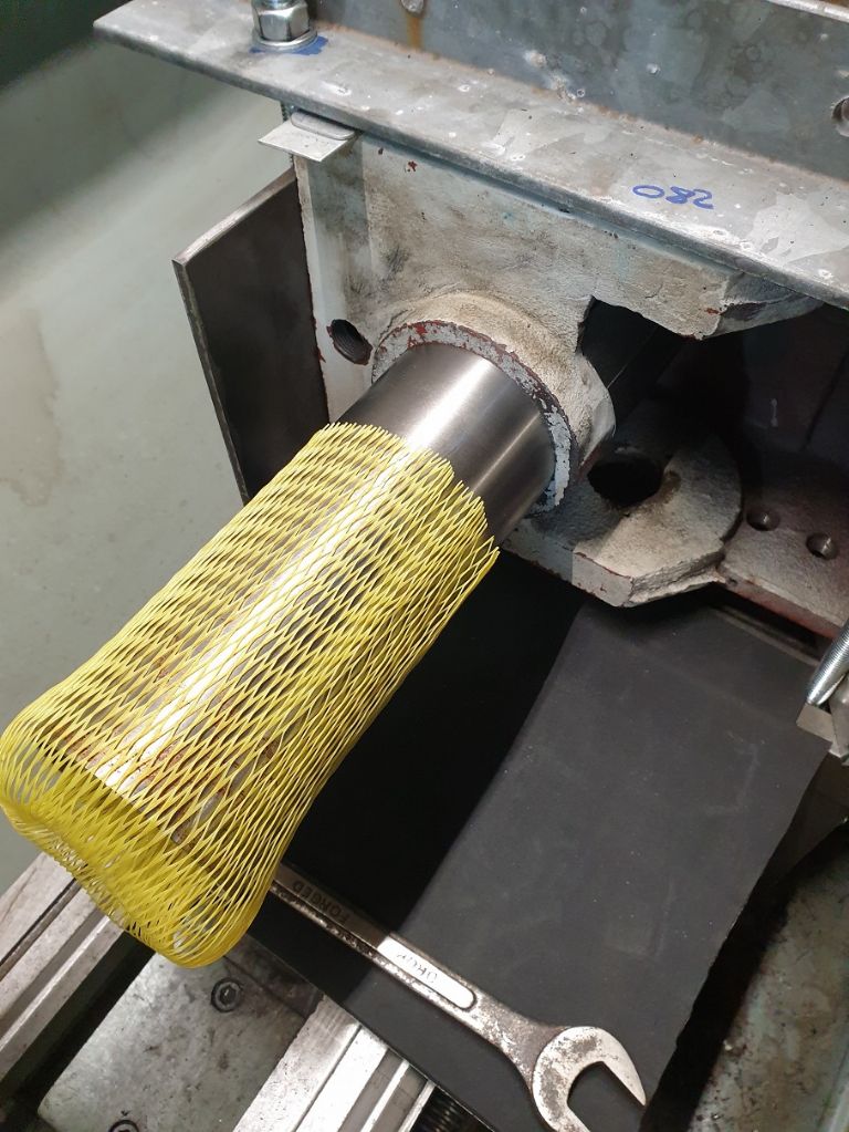

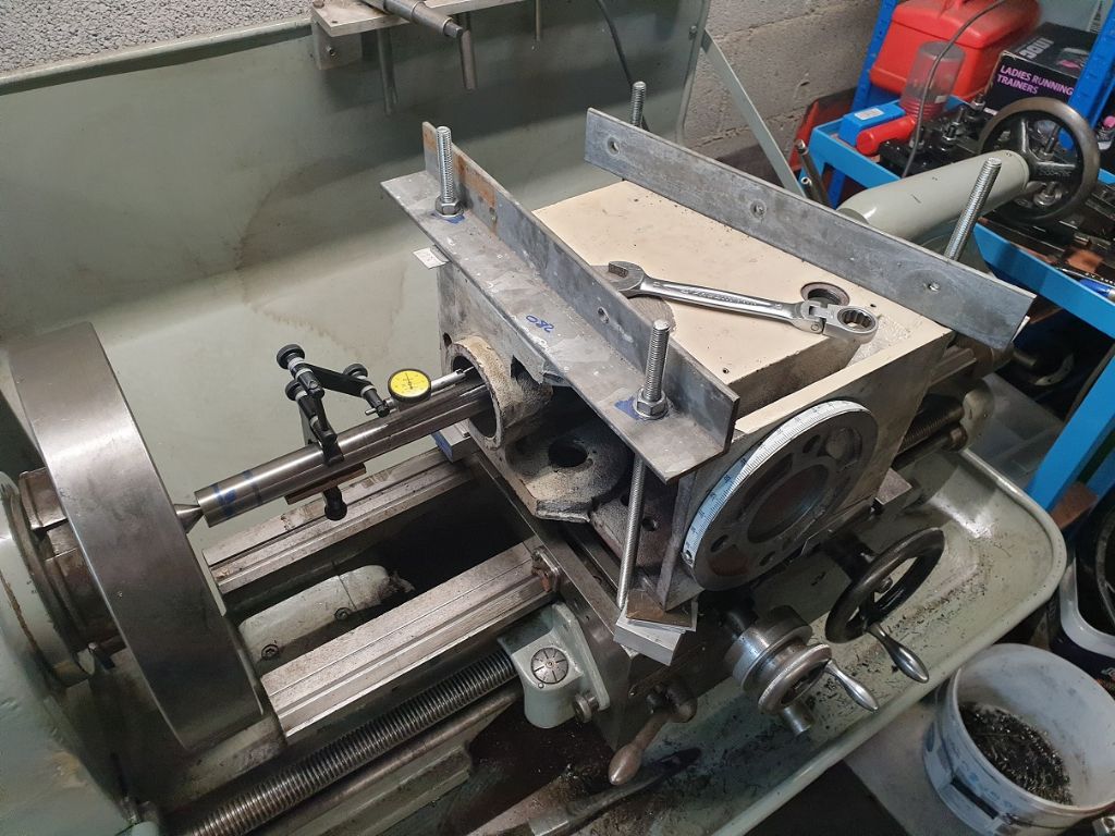

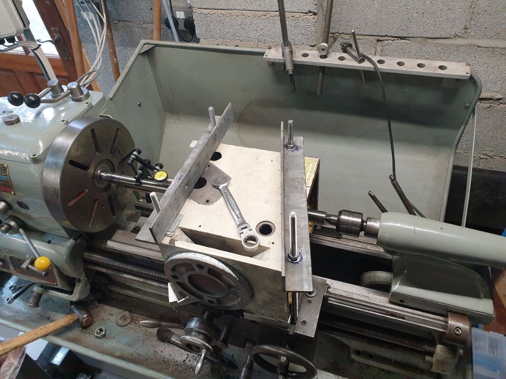

Had an old landrover half shaft that I thought would make a good line boring bar so made use of that.
Cut down a 10mm boring bar so it would do the job.
I've set the mill head on the lathe saddle with the cross slide removed and spent more hours than I care to mention packing, shimming and tapping it into position.
There is just enough room on the bed for the whole operation to be completed on the unworn area of the lathe bed, not that there is much but it is measurable in the normal area close to chuck.
Got a plate set up against the back of the mill head so I have a reference to set the cutter depth increments.
Got the head set so the bore will be true to the head mounting face ( I hope!)
The cutter will run in the normal lathe rotation so it is on the down stroke on the apron side as that is the 'loosest', the rear of the saddle has full length under support so the cut will end roughly in the position in the last photo – by taking the knobs off the tail stock handles it passes them perfectly!
Bar is set up between centres to I can remove it for measuring.
If there is anything I have missed or got wrong I would very much appreciate any advice..!
Here are a couple of pics of the set up.
Cheers..!

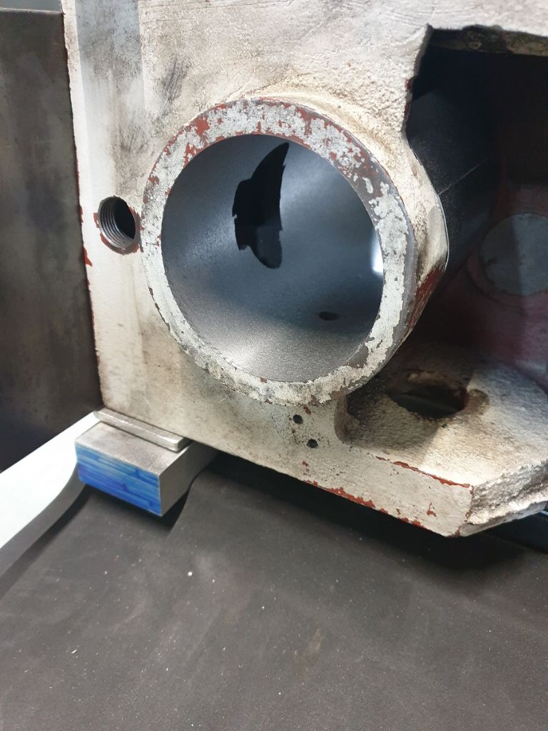

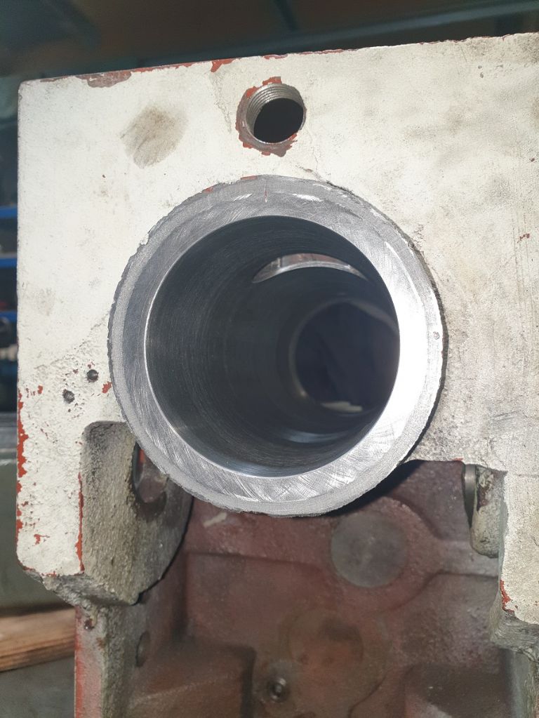

Aftnoon..!
A little progress, things are very slow now I'm 1 handed for a bit post surgery but we're getting there.. (but then they said that about British Rail!).

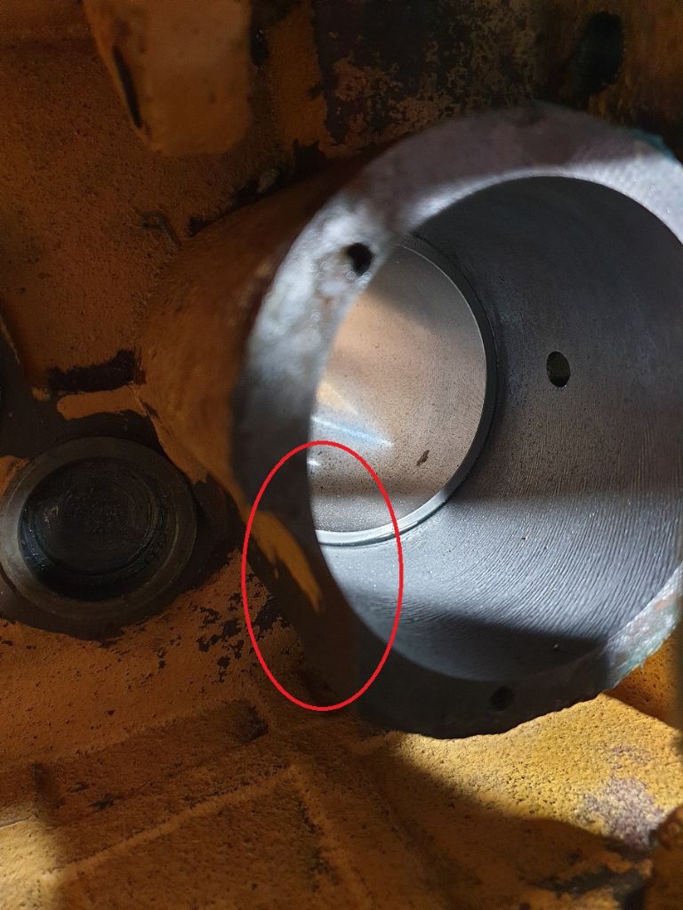

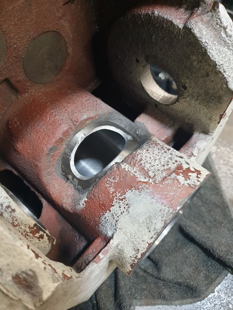

Boring went remarkably well, hit all the numbers I wanted to. While the head stock was still mounted in the lathe I got the liner out of the freezer and with the liner against the face plate used the carriage (and tail stock for the last bit) to press it into the head. Went in perfectly although I stopped short as the top end of the bore has a really thin section for clearance to 1 of the gear shafts, I didn't want to be cracking it for the sake of losing about 1 inch of the liner.
And the thin bit, after boring it's only about 2 mm thick..
Some odd what I can only assume are chatter patterns in the very top end of the original bore but not an issue, it was fine once the cutting had more meat around it.
Liner now fitted, bored and honed..
The sleeve may need another very light honing as the Quill needs a little touch to fall out on it's own but going to leave as is until I try it. I did warm the quill up by about 20' C to make sure it would still move to allow for any expansion due to bearing temp increase and it did .. just! Well happy with that.
I've now opened up the ports for the Quill lock and the pinion gear, that also seemed to go pretty well,
Finished (possibly!) bore and ports.. just a drill hole or 2 for guide pin and lube etc to do but essentially that is done.. not only surprised my self but learnt a lot in the process so a good exercise !
Fly cutter in the lathe to face the end.. had a bit of chatter on the last cut so will need a wee bit more stoning to dress that out.. (below)

It's taking a while to get through this, unfortunately a wrist injury seems to be going backwards not forwards so trying to do everything pretty much 1 handed is just slowing everything down a bit. I was a righty but now pretty well a lefty.. wonderful how the body adapts!
There obviously needs to be some play in the quill to allow free movement, but mine was pretty excessive, no issue for milling as the quill would be locked but when drilling, the distance down to the end of the bit amplified the problem.
As there was no obvious or measurable ware on the 2 small contact rings (machining marks barley touched) in the quill sleeve and nothing on the quill I decided to do something about it. It was just made really poorly.
It has worked fantastic as well as given me much more confidence and now instead of 2 short contact rings fairly close together low down the bore I have pretty well full length support to the quill.. a huge difference, looking forward to trying it but at this rate that will be some time!

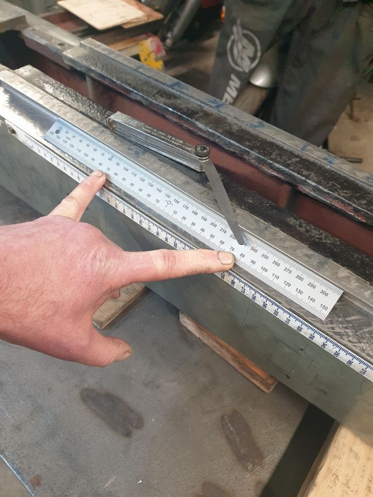

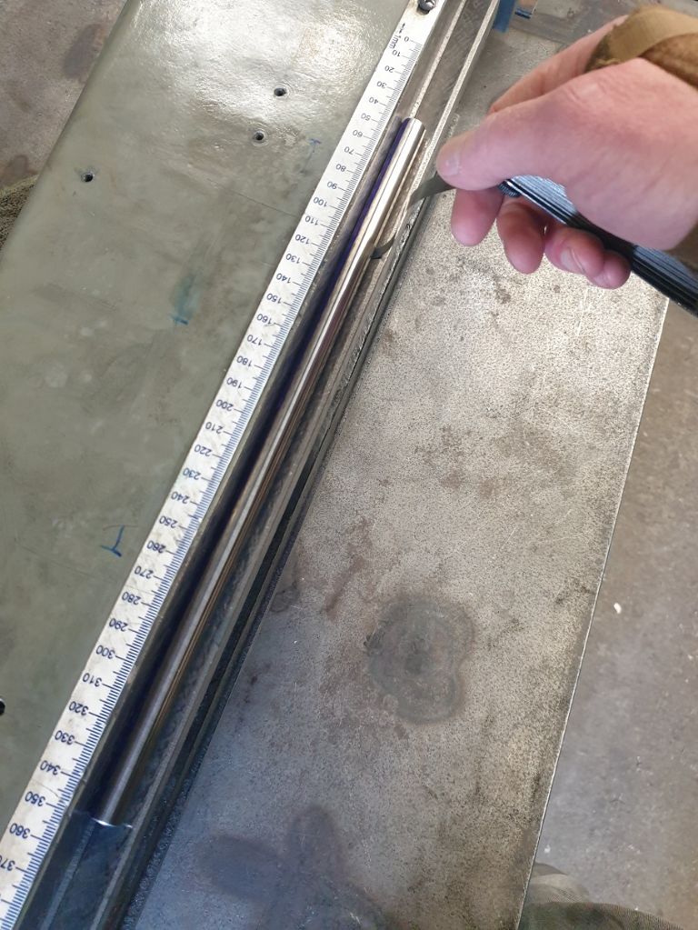

How to measure the flatness and parallelism of dovetails without a dovetail straight edge and a mic big enough.
When I first got the mill I had real problems adjusting the vertical slide gib. Tight (ish) then proper loose, and nowhere in between. no matter what I did I could get nothing consistent. Even in the tightest area the gib was inserted way to far and would need a serious shim.
As the column is still on the work table I thought I would put a light blue on the saddle sliding dovetail and see what it looked like. No point in taking a pic as it was as flat as the Pennines.
I did try to scrape some of the lumps down a bit just to get a little more even contact before trying to get some sort of measurements and also an idea of how thick a shim would be needed.
The best I could do to to measure was using a pair of 10mm carbide end mills (need 12 or 13 really) and my Mitutoyo vernier (I have learnt to trust it fairly well, its good but no Mic).
I thought I was being kift as there was a narrowing of well over 10 thou in the mid area.
I placed the saddle on the column at the top area and inserted the gib so just nipped and no play. Measured the stick out of the gib. Then same further down, etc etc. in the mid section the gib sticks out over an inch more than at the top or bottom.
I'm reasonably confident that the slide ways are pretty flat as placing the (blued) saddle anywhere on the column produces a full print, I appreciate it's not perfect but all I could do so I believe the issue is with the dovetails.
Going to have to get the thinking cap on and work out a way to get at least 1 dovetail flat then at least I have a starting point.
The other thing, the dovetail angle, as best as I can measure, scribing on to paper, angle gauge etc etc is 53 Deg.. I've never seen a 53 Deg cutter and can not find one on the interweb ?? If I could, I'm sure the column could be mounted some how on a mill and skim cut the dovetails.
Oh for a camel back .. no chance of affording one !
Not much point in continuing until I can sort this.. I suppose I did say I liked a chalenge!
Any suggestions greatly appreciated!

Had a thought on a way to find out if it was 1 side or both or at least to maybe prove that I'm not measuring kift..
I took my cleanest thin straight edge I could quickly lay my hands on, balanced it on the surface plate with a light behind and then gently stoned it until it would sit on its edge with no light showing under the edge.
Laid it against the dovetail with a pair of end mills behind for repeatability and a consistent angle as close to 90 deg to the dovetail as possible.
Repeated each side in several positions to confirm repeatability… it seemed to show something I can work with!
On the non gib side, no mater where I set it I could not get a 1 thou feeler gauge between edge and dovetail, this is the side I did a wee bit of scraping on.
On the Gib Side, in the mid section in the same area I was showing the biggest reduction in when measuring with end mills and calliper, also where the biggest protrusion of the gib was when trying it in the saddle I could easily get a 0.07 / 2.8 thou feeler gauge in the gap and this reduced towards either end of the column.
At least I have something to work with… I think!
The above laughing, tutting, head shaking etc may now commence…
Getting creative with the dovetails..
Really didn't like the ruler, it gave an idea but no good really.
Not having a camel back or any kind of master to be able to print the dovetails has caused much head scratching..
I did email Clive Lamb for a price on an 18" (or his nearest size) camel back to do flats and dovetails and despite being a good price compared to everything I see second hand it was out of reach for me I'm afraid (am saving up though!) – he said the foundry had put prices up around 50% !
So all I needed to do was get 1 side flat then use that to measure to the other to get them parallel.
I had a fresh length of ground silver steel 1/2" rod, Ideal side for contact with the mid point of the dovetail, rolled it on the surface plate with a light behind and at 1 point it was in perfect contact along its whole length so I put a sharpie mark on the opposite side so I could lay it in the dovetail in the correct position and used a feeler gauge to find the variation.
Seemed to work pretty well so I used it to check the corresponding dovetail on the saddle and fortunately the non gib side needed almost do scraping to get it bob on. Then used that in the same way as I did doing the flat ways, i.e. start at the lowest area, print it to find the high spots, move a couple of inches to one side or t'other and repeat until regardless of where the on the column I printed I had a full length print.. I may be wrong but I don't see how there can be any variation then (certainly not enough to make any difference to me!). Kept checking with the ground rod just as a check that was I was doing was working.
Far from ideal but it seems to have worked!
I can now measure to the other side to get parallel.
I'm still baffled as to how the whole thing could have been so far out but it certainly explained why when I got the thing and tried to do some cuts, particularly fly cutting, it gave such poor and random results.
