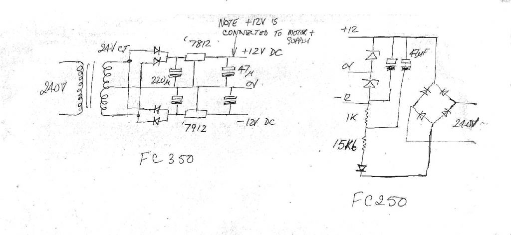

      I am advised the transformer has open circuited causing failure of my mill to work.
      The numbering shown on the transformer is :-  FT3515-220-14DP
      If anyone can suggest where a replacement for this component may be
      obtained I would be most grateful.

            Hi Deril ,
                          Having reverse engineered a FC250J/240v controller of a minilathe
            a short while  ago , and having had  a quick look at a photo of the F350 type of controller in    mini mills
            I would expect a 6va transformer with a center taped 24v secondary would work
            maplin may have one that electrically will do , but you will more likely have to go to rs components ,  rapid  or  cpc for one to fit the board
            I would expect any machine supplier like chester .,machine mart etc only to sell
            a new pcb .
             if you can measure the size and pin spacing of your transformer i’ll try to
            give you some part numbers
             you will see 3 of my photos are scans of the circuit i drew from my controller
                                           John Swift

                  Ok, so there is a transformer after all, but your diagrams don’t show it. So where is it?
                  Regards,
                  Peter
                  #53530
                  john swift 1
                    @johnswift1
                    Hi Peter
                                  the speed control on the older mini lathes do not have one  !
                    at the left hand side of the diagram for the main board
                    you will see  two  12v zenner diodes ( D6 D7 ) and dropper resistors   R40 and R41
                    provide a simple  low voltage supply for the two ics used to control the speed
                    on your controller you have an extra circuit to monitor the motor current
                    the third relay you have extra demands more power
                    hence the transformer and 12 regulators you have
                    sorry for any confusion
                    if you need the circuit for you controller I’ll draw and up-load the extra bits not on
                    the FC250 controller but on the FC350 controller
                     ps     do you have the new board with the surface mount components
                              or the older through hole wire ended components
                              so I can look for a picture of your board
                    Edited By john swift 1 on 18/07/2010 12:13:22

                        just for information Peter I’ve added the diagram below

                                    the ideal way to use the 78xx and 79xx  1 amp regulators as in my simple diagram
                                    is to add a normally reverse biased diodes  from input to output  ( 1N4001 type will do )
                                    and another  one  from output to the ground/ reference terninal on each regulator.

                                        After looking at the Les J info I think the output of the transformer should be 15V as it is followed by the voltage regulators for 12V. We will see.
                                        I wonder if the regulator shown on the schematic as KA9712 has the 9 and 7 transposed?
                                        #53590
                                        john swift 1
                                          @johnswift1
                                          Hi Deril
                                                         two things to consider  :-
                                          1,   small transformers output can 10 or 15 % larger  off load , than at maximum load
                                          2,   12v rms when rectified will give you up to 16.9 v dc ( 12 x 1.414 ) across C11 & C12
                                                  on the diagram supplied by Les
                                                   the diagram indicates this voltage  drops to 15v with the load on the power supply
                                                   this is about the minimum for the regulators to work
                                                  If I remember correcly the 1 amp regulators need an input of 2 or 3 volts more
                                                  than the expected output
                                                   I think the negative regulator will be KA7912
                                          If you search 7812 and 7912 you will find a large number of data sheets
                                              eg National semicondutor part start with LM , fairchild  parts with  uA
                                          note – if the transformer output is too high , the regulators will run too hot without heatsinks
                                                      the metal tab on the 7812 is connected to ground but
                                                      the metal tab on the 7912 is connected to the input !
                                                      in this case the transformer does not provide mains isolation
                                          the +12v is connected to the rectified mains from bridge rectifier B1
                                                                                 John Swift

                                                             I think a 12 – 0 – 12 V transformer will probably be correct. With a capacitor input filter (Which is what the circuit  is.) the DC output will be near the peak voltage of the sinewave which will be 1.414 x 12 = 16.97 The actual value will be a little less than this due to the voltage drop across the diodes and winding resistance. I think you are correct that the 7 and 9 are transposed.
