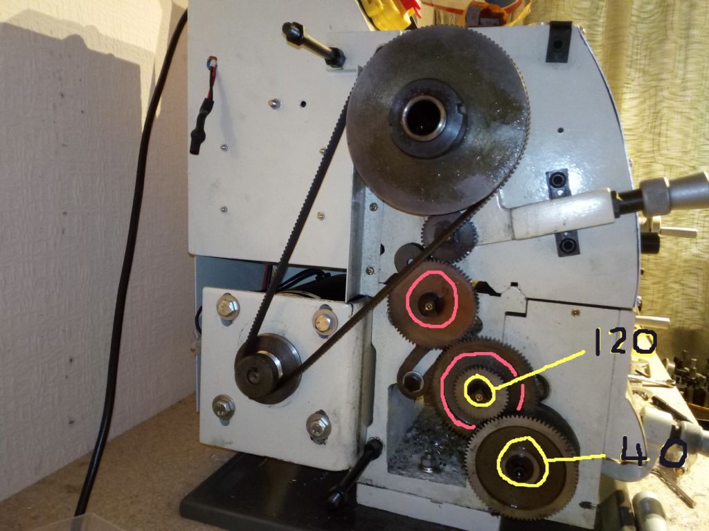

                          Ian Skeldon 2
                            @ianskeldon2
                            This is the back end of my DB10,
                            #363907
                            Ian Skeldon 2
                              @ianskeldon2
                              Am I right in thinking that if I put the 126 tooth wheel on 'A' and the 70 tooth wheel on 'B' I can cut a thread with 1.8 pitch, which is very close to the 1.82 required?
                              If not, I have got something wrong in my understanding of the ratios and this is also quite likely !
                              #363919
                              Les Jones 1
                                @lesjones1
                                Hi Ian,
                                You are correct with what you say but the gerbox must also be in position 1. The 1.8mm pitch will give a TPI value of 25.4/1.8 = 14.11 TPI A 127 tooth gear in place of the 126 tooth gear will give a pitch of 127/70 = 1.814285714285714. This converts to 25.4/1.814285714285714 = 14 TPI. The 126 tooth gear will only give the same result as as the method I suggested in my post at 08:52 on 23/7/18 (gearbox set to 9 ans a 120 tooth in position A driving a 40 tooth in position B.) Just out of interest I worked out all the gearbox ratios
                                1 1 : 1
                                2 1 : 0.924
                                3 1 : 0.858
                                4 1 : 0.80
                                5 1 : 0.75
                                6 1 : 0.706
                                7 1 : 0.667
                                8 1 : 0.632
                                9 1 : 0.60
                                These values were calculated using the table from Martin's post at 17:00 on 23/7/18.
                                I could not work out anything closer using any of these ratios.
                                Les.
                                Edited By Les Jones 1 on 25/07/2018 22:51:47

                                  Ian Skeldon 2
                                    @ianskeldon2
                                    Les and Martin thank you, I will count the teeth on that gear and let you know the outcome but now cleaned up, it is definitely stamped 126, strange I agree, but with chinese machinery, who knows ?
                                    #364029
                                    Ian Skeldon 2
                                      @ianskeldon2
                                      Well teeth counted, 120 as first thought, I have ground the six down and I think it has been stamped twice, once with a 6 and then again with a 0 ?
                                      I will try the 120 to 40 gearing a go. Thanks again.

                                                  Ian Skeldon 2
                                                    @ianskeldon2
                                                    Posted by Michael Gilligan on 28/07/2018 18:50:59:
                                                    Posted by Ian Skeldon 2 on 28/07/2018 17:44:15:
                                                    … I could buy a metal 127 tooth wheel of ebay …
                                                    Ian,
                                                    With apologies if I have missed it … Have you checked what diameter [and width] of '127' would fit in the space available?
                                                    I have a large steel '127' which I was keeping for one of those infamous future projects … but if it's a suitable size, perhaps we could agree a price.
                                                    Hi Michael,
                                                    The 120 tooth gear that came supplied does fit, but only just, it's a fiddle to get it on. Having said that, I think I have got it wrong. I have cut a test thread (external) and am getting about 22 tpi. I have uploaded a photo showing the new gearing. Red gears unchanged, other gears shown and numbered, any ideas what have I got wrong?
                                                    Thanks,
                                                    Ian
                                                    #364396
                                                    Ian Skeldon 2
                                                      @ianskeldon2
                                                      Managed to spot the mistake, I need the gearbox selector in position 9, not 1, doh…..
