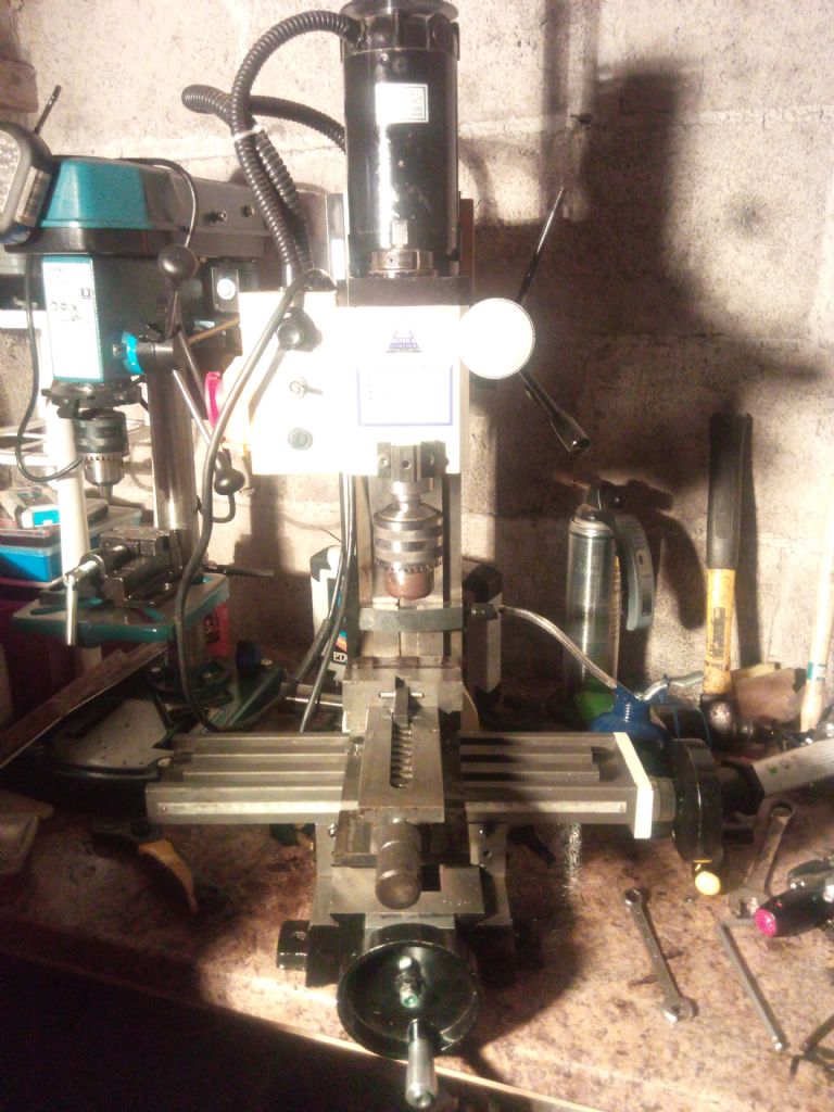

        As it stands of last night, crappy quality pic. I really like this idea in the link(what Ketan said). http://robertsprojects.blogspot.ie/2013/04/mini-mill-solid-column-conversion.html?m=1
        Just attaching the column. Only problem I see is trying to figure out how to mount the base in the ML7 to machine the rear of the base flat lol. I made a quick wheel handle for the Y as it was missing. Also need bellows and a gib lock for the X. I need to take the gib out of the Z and have a look at that, then its tramming everything and make some cuts

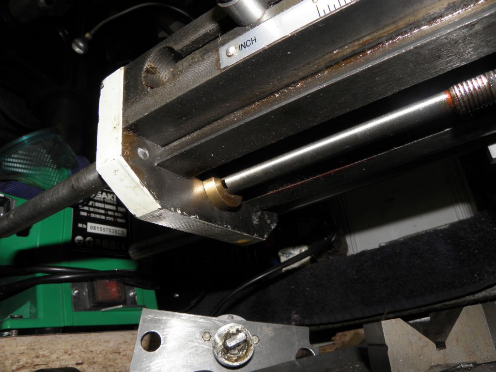

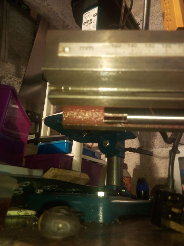

            Another thing a noticed is the lead screw for X doesn't come all the way up to the edge of the table. It still has the full range of movement though (300mm)

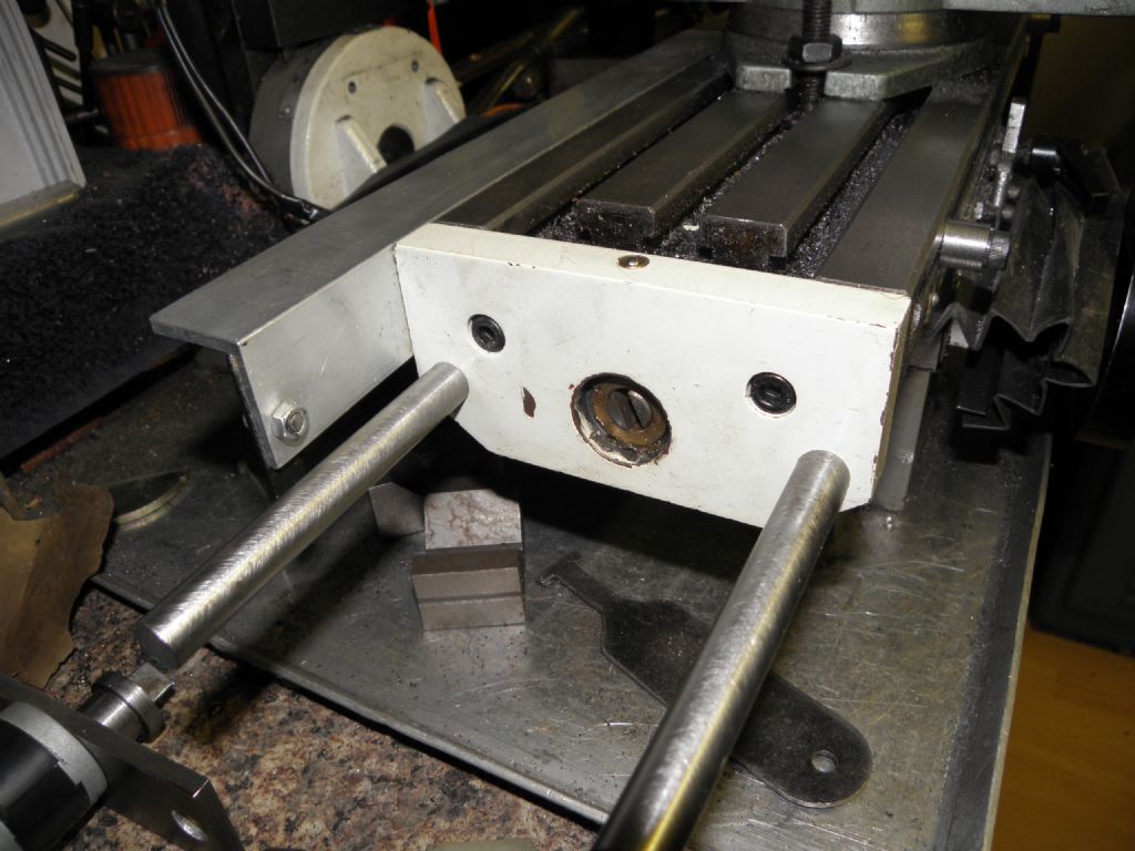

              Hi John. I think you have a couple of parts missing there.
              1. The end plate.
              2. The lead screw length adaptor which I believe was fitted on some of the extended table versions of this mill.

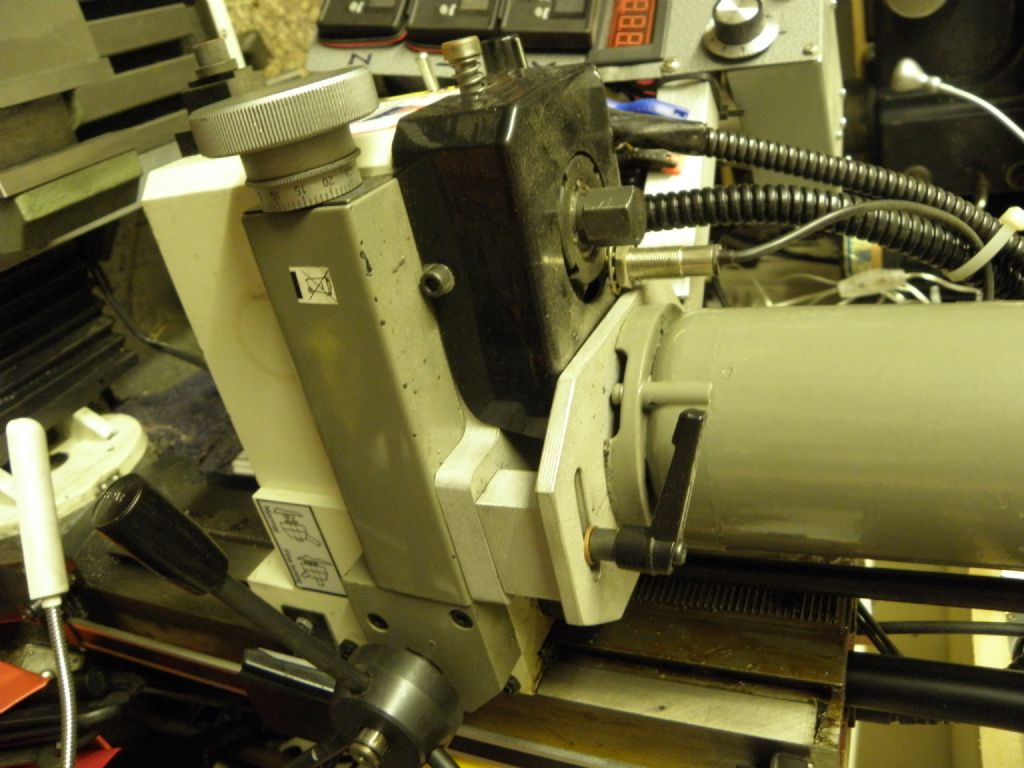

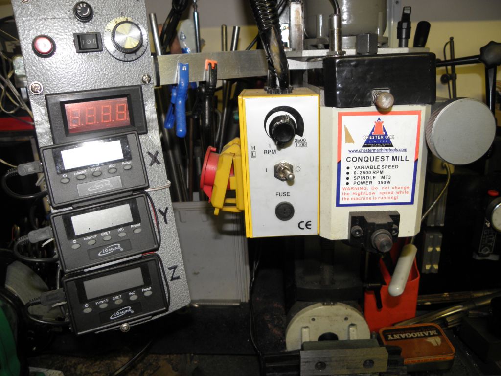

              Here are some photos of my mill I took a while ago. A few things have changed but you should get the idea.
              My lead screw came full length as standard. I use the slot in the end for the table drive motor. The 2 S/S 12mm bars on the end plate are what the table feed motor assembly is mounted  on. The top control panel is for table motor speed and direction & speed indication. You can see the speed sensor behind the drawbar nut. I have now made a new control panel & the DRO scales are attached to a bluetooth sender and viewed on a tablet using Yuri's software. If you want measurement let me know.

                That’s a nice big motor , what board is running it? So your lead screw , is it one machined part , is is there an extension on the end of it to bring it out to the end of the table ? I can machine up a new end plate by copying the other side. I was looking up the Bluetooth dro, I’ll also do this in time , I have adruino uno r3 sitting idle.

                    The main motor is the one supplied with the mill.
                    The Table feed motor was from Ebay. 12vdc with 60rpm all metal reduction gearbox. £14
                    The controller for it is a 12dc reversible PWM type also from Ebay. £9
                    The speed readout was another Ebay purchase. £6
                    I use a PC 600 watt power supply for the 12vdc
                    The red button on the control panel in the previous post is to fast traverse without changing the speed settings.
                    The lead screw is as supplied full length with the mill. I am sure that the early longer bed mill had an adaptor to extend the length of the original shorter lead screw. It would be easy to make one and pin to lead screw if you have a lathe.
