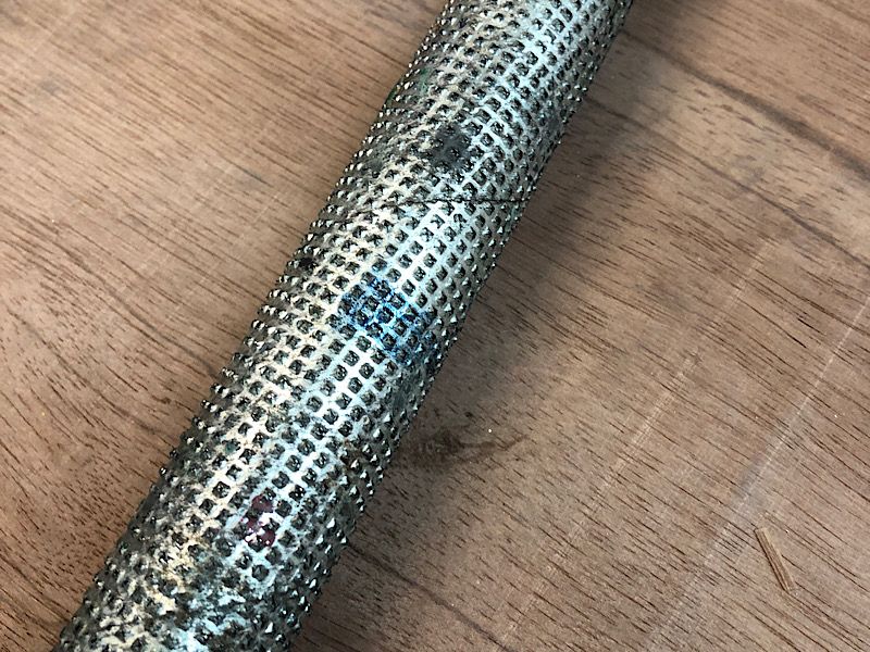

      i have 10 shafts 20mm dia and 1200 long made of alloy and they had a strip of like cheese grater/lemon zester type material wound round the shaft in a spiral.
      this is the take up shaft on a printing press for a wash up roll which is like very strong kitchen roll..the operator winds the material round the shaft and the rough surface grabs the material and allows it to be rolled up on the discard roller.
      the zester type stuff had fallen off them all
      ive knurled a few of them to see if that works..with some success
      but the operators want it like original…. really grabby..
      where could i get such strip material ?

            the prongs are too long for this application
            ill try and get a photo of one tommorow off the press.
            the zester type of strip is thin stainless with a grid of square punching from behind making little pyramids of sharp points which grab the roll

                        ..one used get given a bit to roughen the tube with in puncture repair kits..

                          Puncture repair kits! That's the place. You'd need quite a few to cover all those rollers frown
                          The perforated strip I've found by Googling has nice round holes, but knocking a square punch through might raise the edges enough to provide the necessary grip. Pretty boring job though…

                            Ian, see P24 of this pdf
                            UK contact details HERE
                            Good luck, hope you're keeping well over there
                            Bill

                              Here’s a pic of the roll in question
                              it doesn’t need to be wound round a straight stip of it would suffice 504f8a58-64de-40b8-9d66-4feb683f0658.jpeg

                                Bill
                                you ARE on the ball thats exactly what i need
                                how did you find that?
