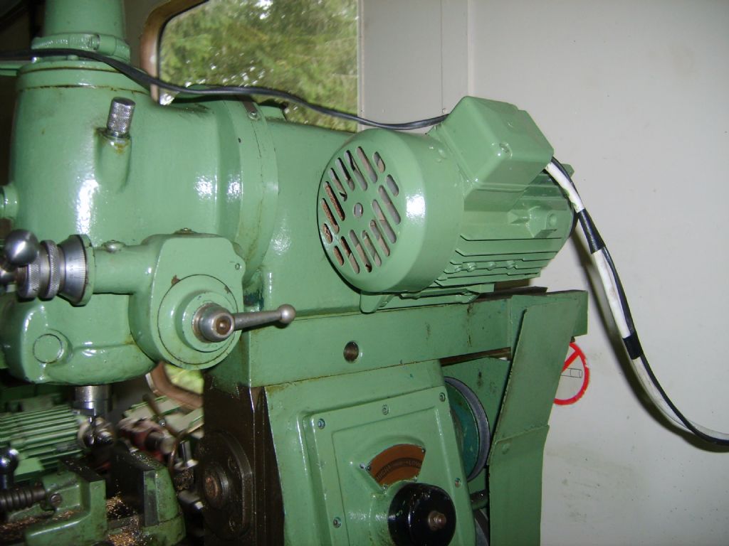

                            Hello Frank,
                            Having the same problem with regard to the weight of the vertical head, I made a lifting block from a piece of 3" sq.
                            18" long mild steel. Having machined the dove tails I also drilled some lightening holes in the support.
                            I also fitted a separate motor for the vertical head driven thro a VFD . This set up removes the need to reset the drive belt.

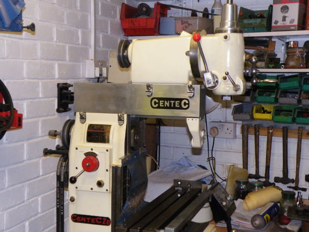

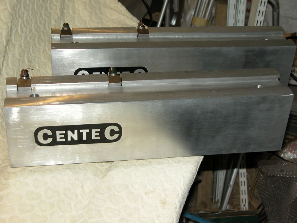

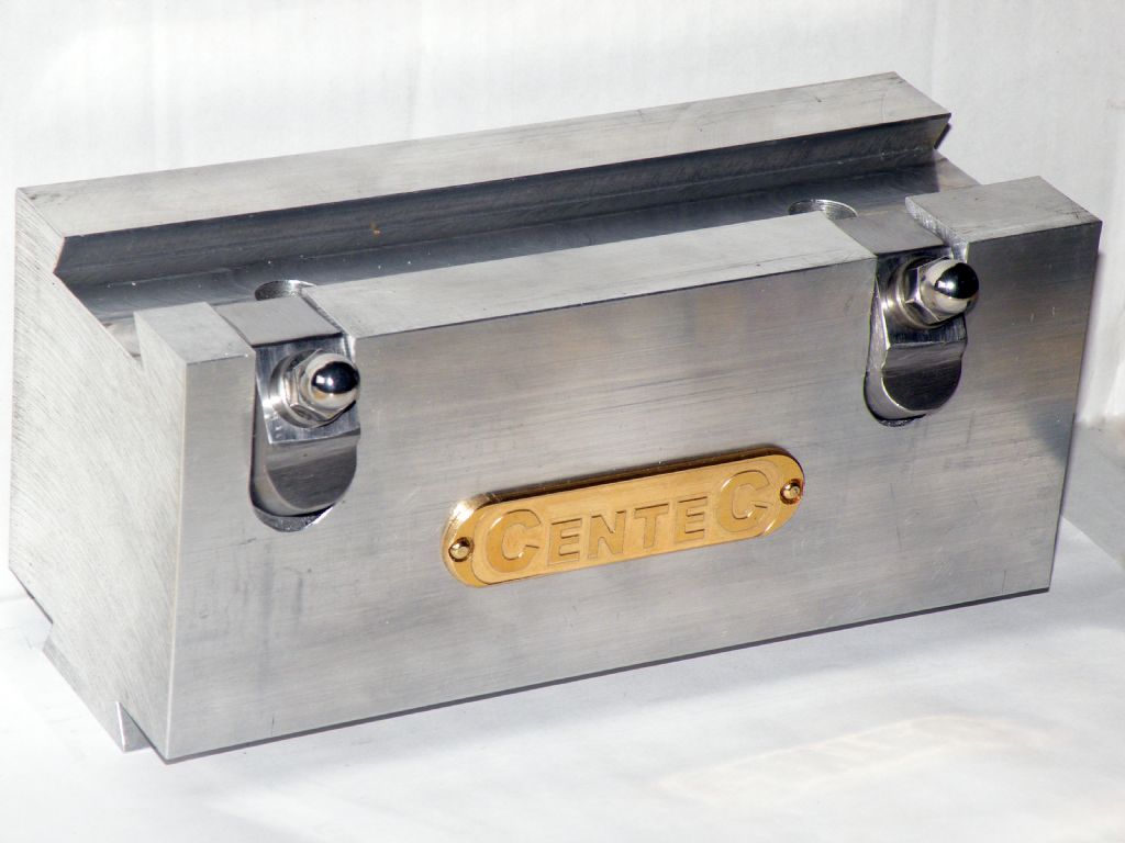

                                      I've made about 20 Centec raising blocks, only two of which were "short" ones, meaning they had to be removed in order to use the m/c for horizontal milling. The remaining 18 were "long" ones which were slid rearwards for vertical milling and slid forwards (with the VH still attached) to act as the overarm.
                                      All were made from 6082T6 aluminium alloy, and have performed really well. I've had no complaints at all, but was surprised to find that, because Centecs were made in two separate factories, there are slight differences in the sizes of the dovetails.
                                      Cutting the dovetails is easy, but time consuming and tedious, but making the retaining fingers and cutting the pockets was a challenge.
                                      Long raising blocksShort raising block

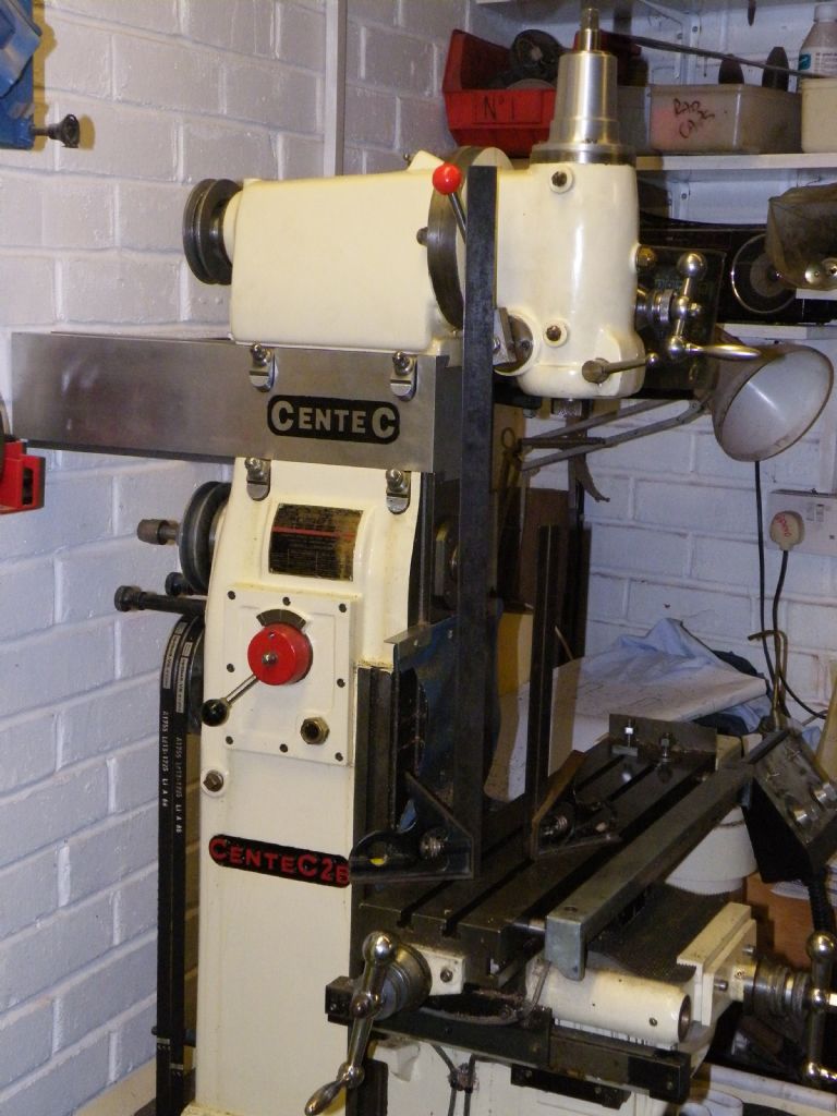

                                                Martin,
                                                You don't need a raising block if you don't have a Vertical Head.
                                                These pictures show how the long block is used.
                                                Long block retractedLong block extended
