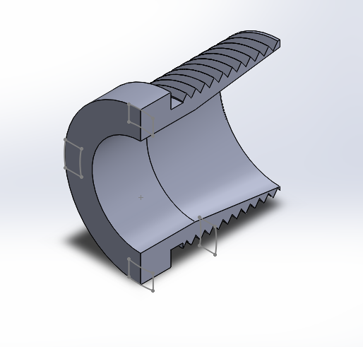

      Now for something unrelated to that big lathe I keep spamming about.
      I want to make a bearing that screws into its housing (22×1.5 thread) for a tapered shaft. It would have crenalations on the part facing towards but I messed up solidworks somehow so pretend those are there to help screw it in.
      What materials are suitable for making this? Phosphor bronce seems the standard bearing material but is relatively expensive. I considered that cast iron stock is significantly cheaper and lathe spindles, assuming they are adequately oiled, seem to use cast iron housings for bearings with success.

            From your other posts it seems you will be cutting both threads with taps and dies, it will be very difficult to get the accuracy and concentricity that will be needed to keep the bearing lined up in the tapped hole.
            Also without some form of locking nut the bearing will be able to move in teh threaded hole as you will be unlikely to get 100% thread engagement. Also whats to stop it unscrewing?
            Hollow cast bearing bronze will be a bit cheaper than solid but still same problems as above, though at about 1" dia and 1" long cost difference won't be worth worrying about.

              The model of your bush is very thin at the end of the taper and looks like the thread almost breaks thru.
              A thread is not good for maintaining concentricity.   Can you reduce the length of the thread and add a locating boss (slightly bigger than the thread OD) for locating the bush on centre ? Similar system used on a lathe spindle for locating a chuck or face plate.

                I was wondering if it need a locking nut or the thrust from the shaft working on the taper would keep in locked in place. Lock nut is the plan though. I thought by machining the thread relief to leave a dead flat face that might be enough to locate it but I will add in a locating boss in too.
                And yeah after I cut the thread in the model I realized there's less than a mm of material at the end. Will have to make the taper shallower (just gotta hope I don't make a morse taper by accident).
