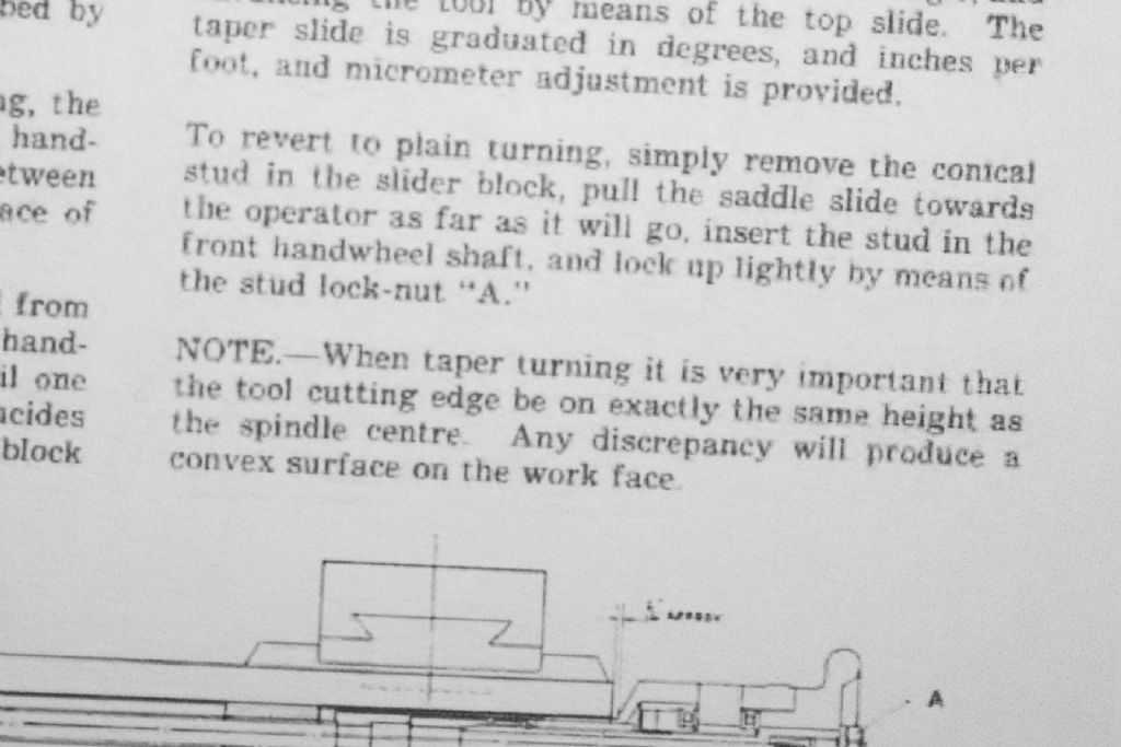

      I wonder if George Thomas ever tried to produce a standard 60 degree taper on the end of a centre with the tool height off centre. Anyone with a brain cell would be able to understand what the outcome would be.

          old mart
            @oldmart
            An extract from Smart & browns instructions for their model A toolroom lathe:
