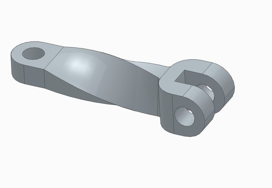

      The Clevis connector you didn't know you needed. smile d

                #642921
                  Getting close with Alibre, external fillets and chamfers omitted 'cos I can't be bothered

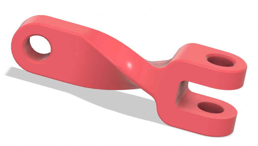

                    Here's what I did with Fusion…

                      #642965

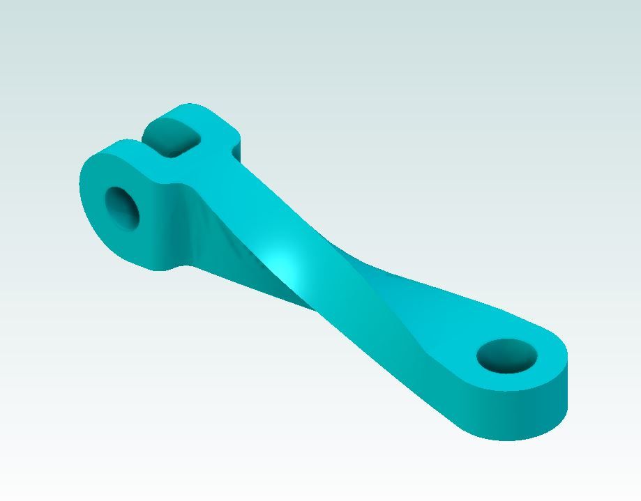

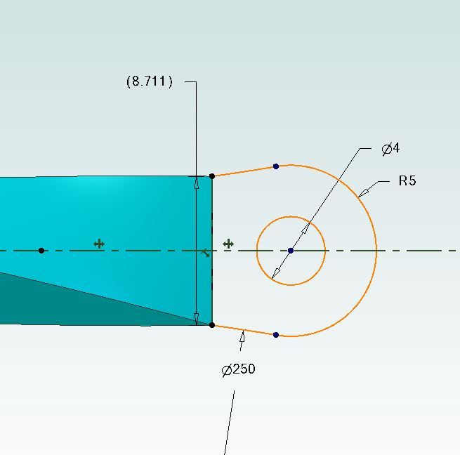

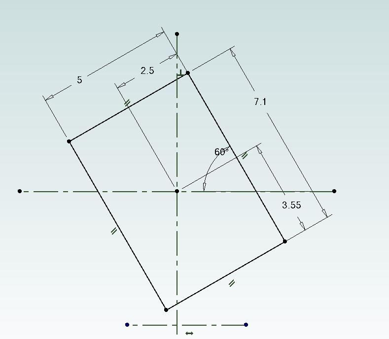

                        This is Solid Edge.
                        The twist, which I expected to be the hard part, is easy. Rounding is usually trivial in SE but not this example! I can't get the tool to follow the edges all the way round. Might be doing it wrong – there's a bunch of settings I haven't tried, and don't understand.
                        #642974
                          Gary and Dave look to have taken the easy route with a straight ctr section rather than the dogbone that Martin and I have done with the 125mm radius which did need quite a bit more work in Alibre than MOI to get it to twist than a straight section would

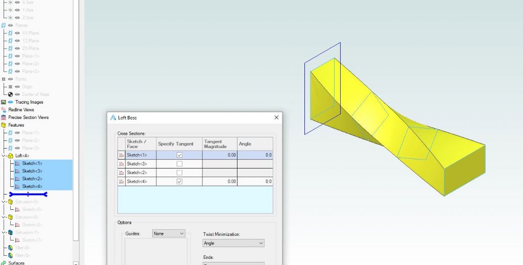

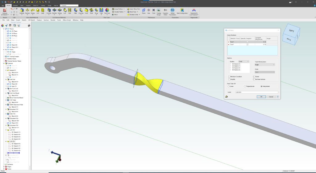

                                        #643041
                                        Nick Hughes

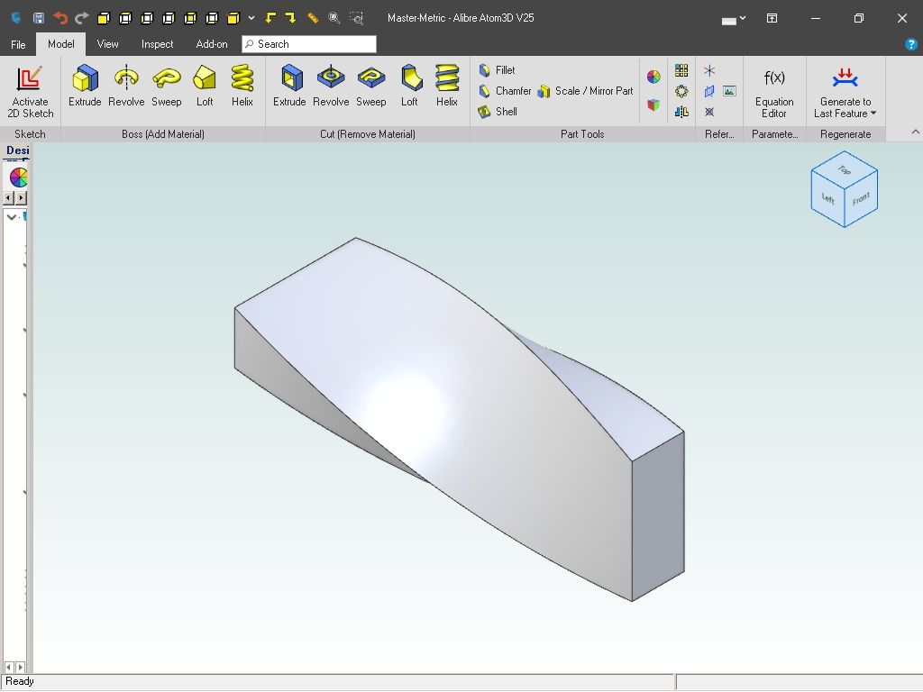

                                          @nickhughes97026
                                          Another method in Alibre, is to Loft using two rectangles and four 3D Guide curves (straight lines in this case). These guide curves connect each corner (Vertex ?) of the first rectangle, to the corresponding twisted corner on the second rectangle.
                                          Note that this may not work in versions earlier than V25.
                                          Edited By Nick Hughes on 29/04/2023 10:52:28

                                            Have you done that in Alibre Atom 3D Nick?
                                            #643062
                                            Ady1
                                              @ady1
                                              Looks like 3D sketch which is in the expert and pro versions
                                              If they'd put that into Atom 3D it would have been CAD bargain of the year
                                              Edited By Ady1 on 29/04/2023 12:00:56
                                              #643067
                                              Nick Hughes
                                                @nickhughes97026
                                                Yep done using Alibre Expert.
                                                Edited By Nick Hughes on 29/04/2023 12:38:47

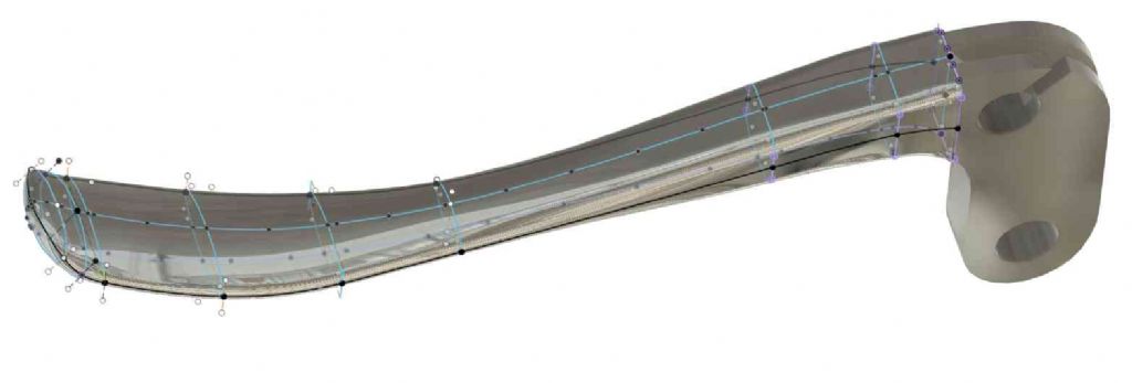

                                                  Rail guided lofts are very useful when reverse engineering compound shapes. This is a motorcycle handlebar lever modelled in F360.
