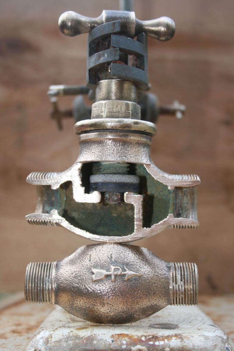

            A globe valve is more suited to fluid flow regulation than other valve designs. Globe valves generally have a tapered seat deisgn, the fluid flow is directed downwards onto the valve plug and exits from the seat downwards, This type of valve is most suited to flow regulation.

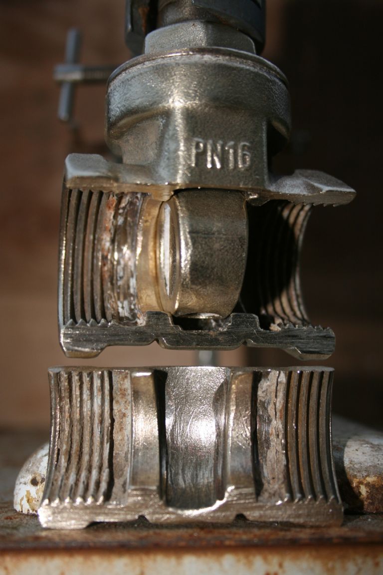

            Another valve design which is generally used where a full bypass is required is a parallel gate valve, these are not suited to fluid flow regulation as when partially closed, the point of wear between the seat and the gate eventually causes leakage.

              An interesting definition, Coalburner.
              I suppose your first picture is the globe valve, the second one what you call parallel gate valve (although it seems to consist of a tapered plug).
              How do you call in England a valve consisting of a rotating ball with a hole across it? Not a globe valve then?

                  I would call a globe valve, one shaped like a globe, it could have and simple non-return flap or clack mechanism inside, hence the globe shape.
                  In Coalburner’s pics, I would call the first one a stop valve, although I think the flow is shown going in the wrong direction, and the second one just a gate valve, and they do normally have a tapered, gate seating into a tapered slidway. I must agree with Coalburner that gate valves do leak after a time of use when they are closed and can only control flow rates in a rough-n-ready manner.

                    in typical Blue Peter tradition, a couple I’ve prepaired ealyer.
                    This top pic is a stop valve, which can be seen is like that depicted in Coalburners first pic, and on the body of the cut away section is an arrow showing the direction of flow, making it uni-directional.
                    The bottom pic is a typical gate valve. You may just about make out the wear on one of the edges of the gate and the corrosponding seat edges, which allow them to leak after a while in service. These valves are bi-directional.
