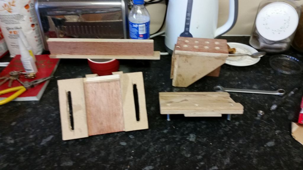

      My attempt to build a hand shaper, based on the desogn by F T Leightwood
      #398961
      Carl Walker
        @carlwalker

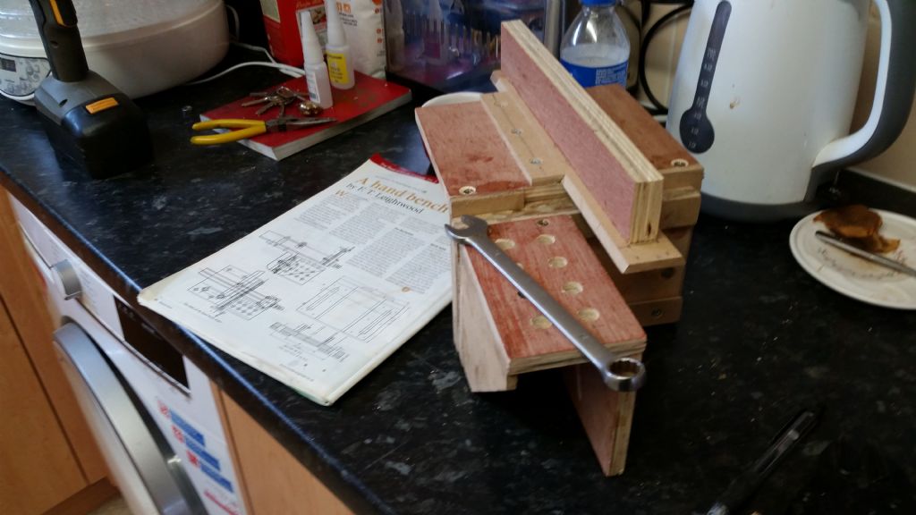

        Hello all,
        I've been reading a lot about shapers recently, and it re-kindled my on and off desire to own one for myself. I don't have room for a normal size powered version, so a hand operated one is the option I am going for. I remembered reading an article in the Best of Model Engineer Volume 3, a reprint from June 9, 1949, entitled "A hand bench shaper" by F T Leightwood.
        I had dismissed this article when I first read it, as being unsuitable due to the materials needed (6" x 5" x 1/2" steel angle), techniques (welding), and equipment needed to build (The author used a full sized shaper owned by a friend for some of the machining).
        However, recently I have been rethinking, and I wondered if it would be possible – or reasonable – to build it using aluminium and/or steel plate, screwing or bolting parts together instead of welding, etc.
        So I decided to build a mock-up using plywood and MDF, screwed and glued together, with M8 threaded rod for the slide controls. It is coming along nicely, and has proved the concept that it would be possible to make one of these shapers by built-up methods. I've not finished the mock-up yet, but have made the main components, and will be finishing it off over the next week or so, before starting to build one for real. Making the mock-up version has shown me a few things, one being helping visualise how to make and assemble the shaper, another being just how small this shaper is, considering it has around a 6" ram travel!
        As soon as I figure out how to add pictures, I'll upload some pictures of what I have achieved so far
        Cheers
        Ricky Walker
        edit: Sorry, thread title should be "build a.". not "build as "
        Edited By Ricky Walker on 06/03/2019 14:47:43

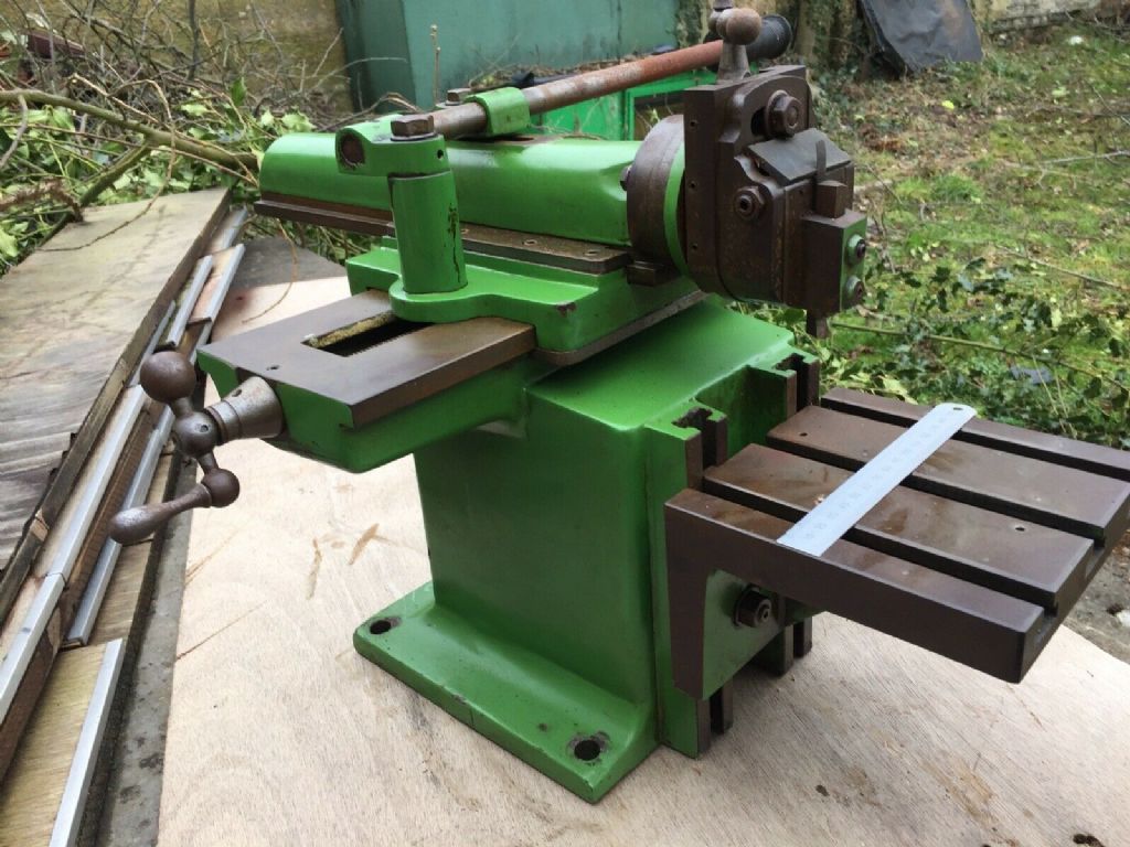

          Google "Gingery shaper" – it'll save you hours of woodwork, if you insist on making your own. Or just buy a Perfecto or Adept one.  Picture of my Perfecto (motorised) below – it wasn't very expensive:

              Hi John,

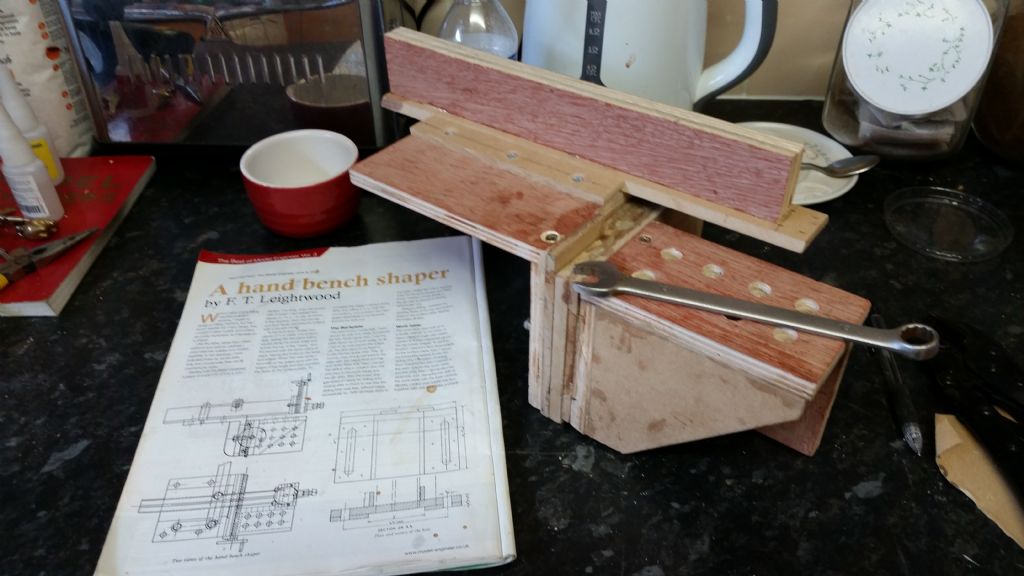

              I have the set of Gingery books, and have got as far as building a furnace, not used it in anger yet, I am hoping to do so this summer Building the Gingery shaper is one of the options I looked at, and I may still do that – I'll probably want a powered shaper at some point
              I've managed to get the pictures uploaded into an album, so here they are, hopefully:
              First picturre showing the thing assembled.
              From a different angle, showing the ram more clearly.
              The parts separated, clockwise from top left: Ram (not complete), worktable – still needs holes drilling on side, worktable slide, and main base.
              The ram still needs the head and clapper box making, and I haven't started on the slide screws yet. Also, I still have to make the operating arm and linkages. Then I have to start again doing it all in metal
              Making this version in wood has really helped me in working out any design changes I want to make on the metal version, and it looks cool too! First step I'll be ordering some 1/2" thick alloy for the main base plates. I have decided to make this from a mixture of aluminium and steel – steel where the dovetail ways are involved, alloy for most of the rest of it.
              The machine tools I will be using are a Warco mini lathe, and a Clarke CMD10 micro mill/drill. I'll post pictures as my build progresses. And who knows, we may end up with a working shaper at the end of it all !
              Ricky

                          Today I made the cross feed screw for the worktable on my shaper mock up. Tomorrow I'll be travelling from Hull to Dartford to collect the hand operated shaper I won on eBay I;ll still be building this design though, as it is smaller than the one I have bought.
                          Here is a pic of the one I have bought:
                          Should be interesting, and will help me to build the one I have started

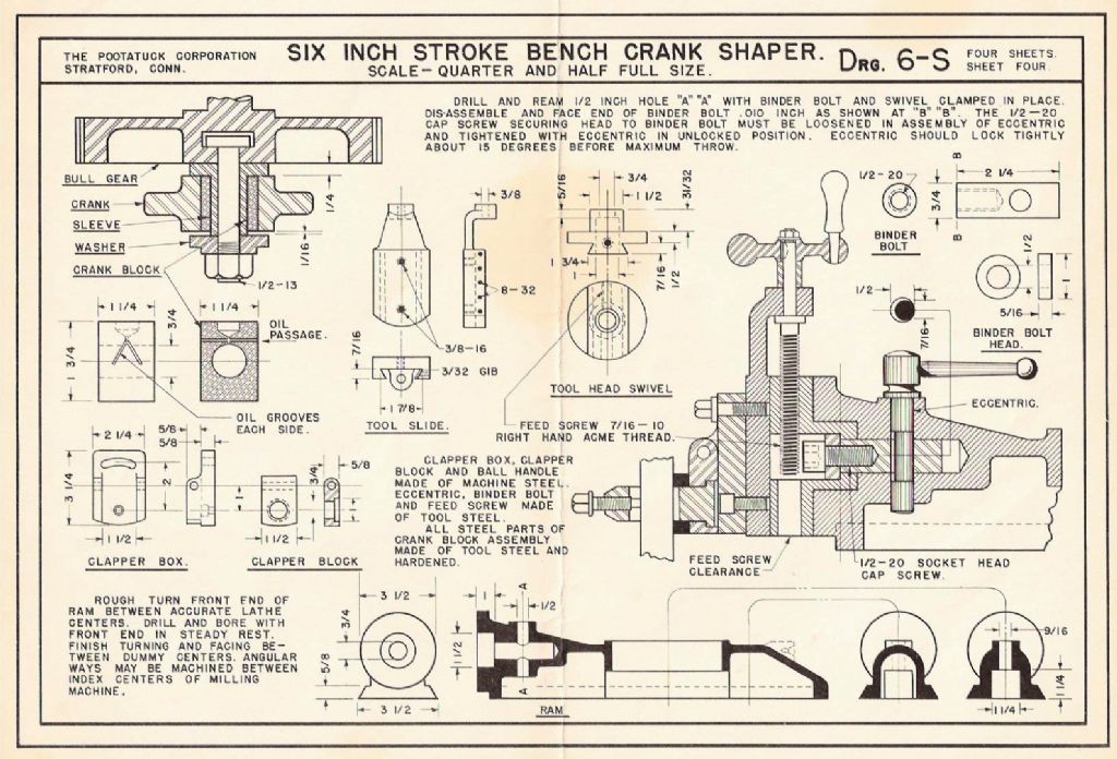

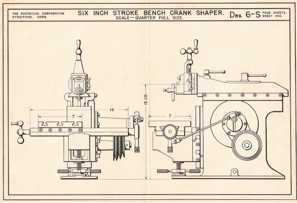

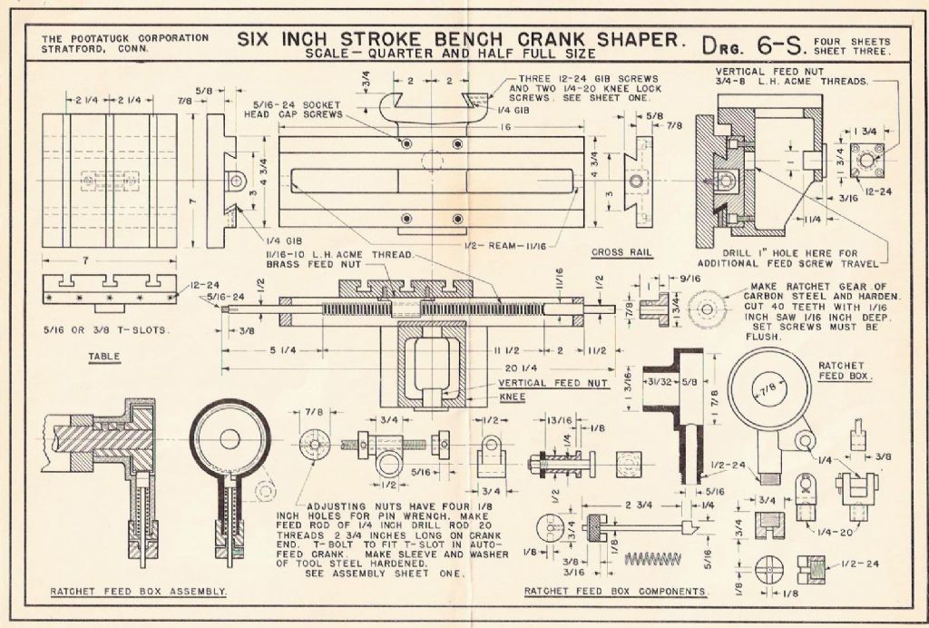

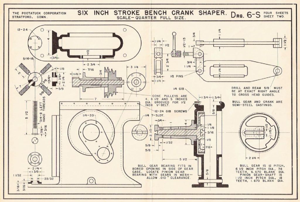

                              Have you seen this design for a shaper ?
                              #399671
                              Carl Walker
                                @carlwalker
                                Hi Paul Lousick,
                                I'd not seen that one before, now it is part of my collection of plans
                                Cheers
                                Ricly

                                  Really pleased with the one I bought, no maker's name on it, and it doesn't match any of the ones I looked at on the shapers archive site i found (lathes .co.uk, or something like that) so I'll be trying to find out what make it is over the next few weeks
                                  I just couldn't believe how much traffic there was around the M25, especially as it is Sunday! Got the shaper home now, I just need some more space to magically appear, so I have somewhere to keep it
                                  Ricky
