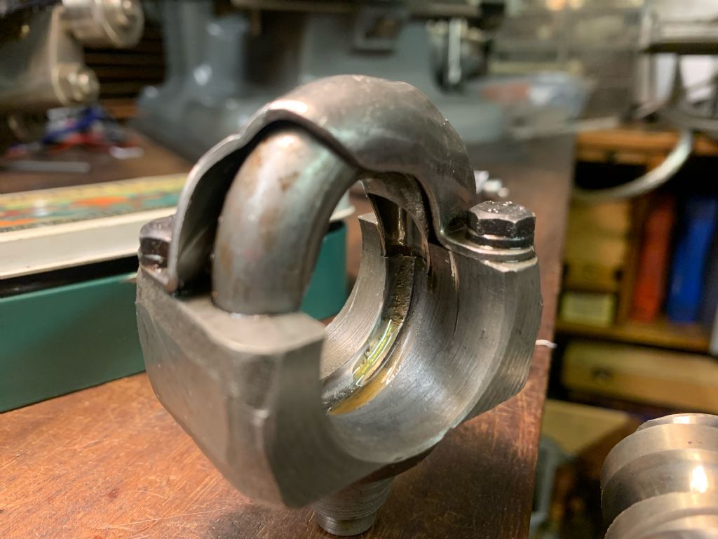

I am currently overhauling my Land rover series 2a steering, (it tried to dictate its preferred direction, which was exciting!)

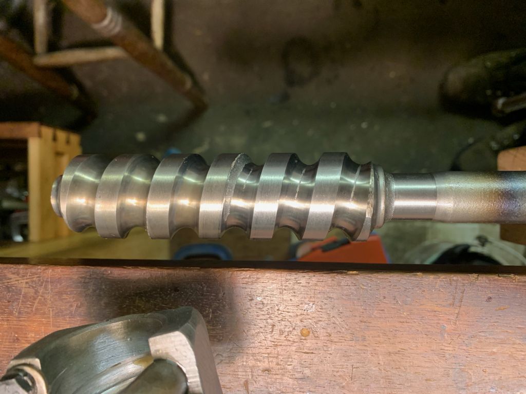

I am nearly there with sorting why it did that, my attention is now on the steering box. As I am sure some on here know, they work on recirculating ball. A course "worm" with a single "thread" nut made up of a ball bearings.

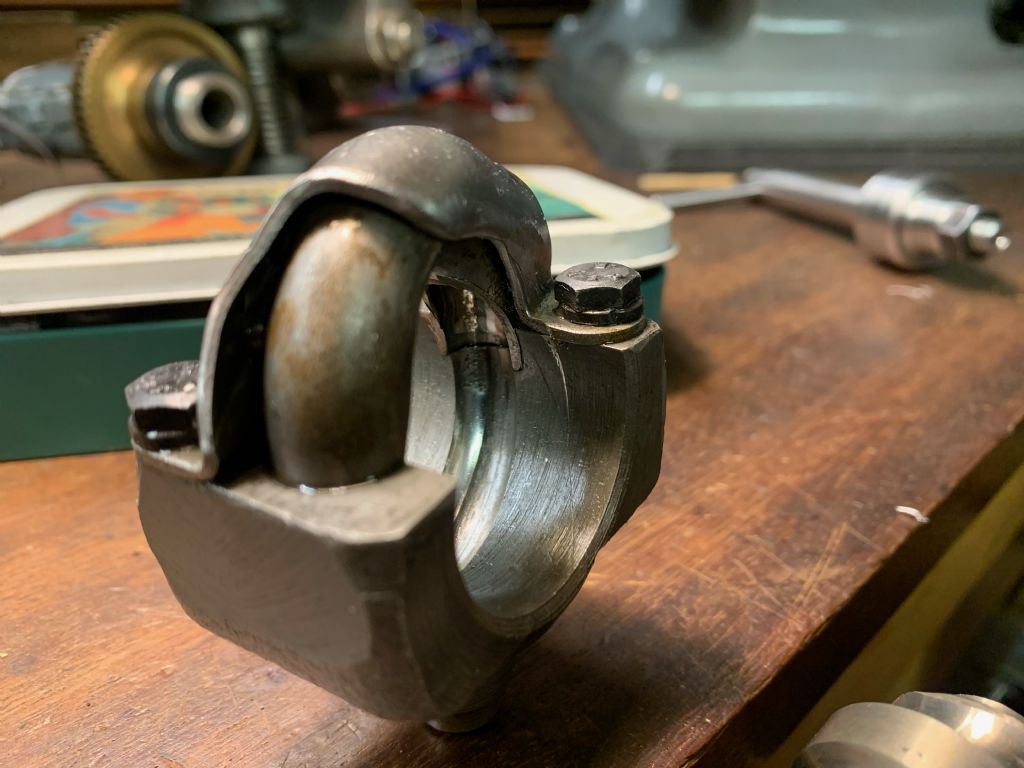

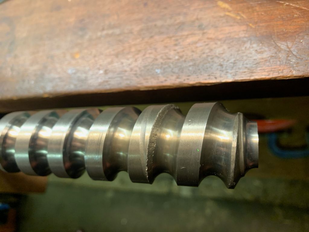

They have a nasty habit of doing this:
Now to rectify this is not the cheapest thing on the planet, and pattern parts are of dubious quality. I have no worry over cost of reconditioning but I would like to prevent the above from happening again in a short space of time. (I know when set up correctly it shouldn't but I would like to know what is peoples opinions on my suggestion)
What would the implications be of replacing the hardened steel balls that travel up and down the worm with phosphor bronze balls?
The worm and nut I belive are hardened and it all sits in an oil bath.
I hope that makes sense and I look forward to your opinions
