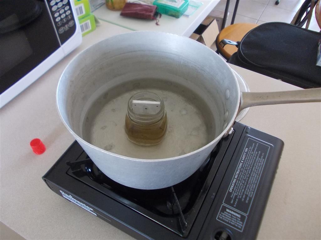

        I broke a 1.5mm drill bit while drilling aluminium ; it was almost through but not quite as there is a ''pimple'' on the other side. I have soaked the work piece in a saturated Alum solution for the past week but nothing is happening.
        I then bought an old aluminium sauce pan to heat things up and get it moving but still nothing is happening.
        I have previously used Alum to dissolve a broken M2 tap that was stuck in brass. It took a month at room temperature but it eventually dissolved the tap. I did not have to heat it up. That was a through hole so perhaps the Alum could react on the broken tap from both ends.

                                          Brian John
                                            @brianjohn93961
                                            Howard : this is a freshly made batch from the same packet of alum.
                                            It is soaking in a small glass jar. The glass jar was placed in the aluminium saucepan in a water bath to raise the temperature.
