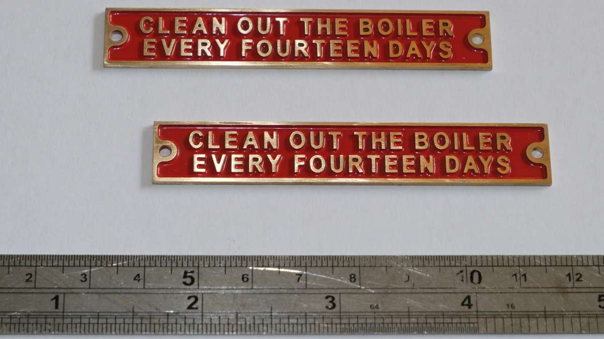

          Julie Ann
            @julieann
            I can confirm that CZ120 engraving brass machines beautifully as it contains 2% lead; clean and no burrs:
            Washout_Plates
            Plates CNC milled with a 0.5mm diameter cutter and painted with etch prime followed by coach enamel.
            Julie
