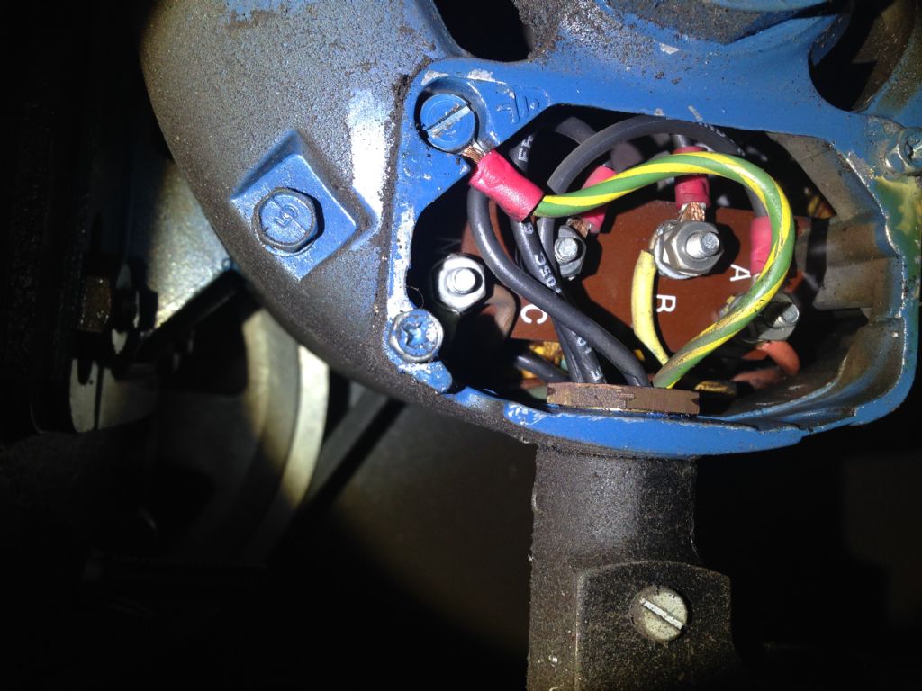

        image.jpegHi chaps I've just got myself a lovely little Boxford Shaper, I need some advice with the motor I would like to run it of one of my inverters, but not sure about the wiring on this one , any advice would be welcome.

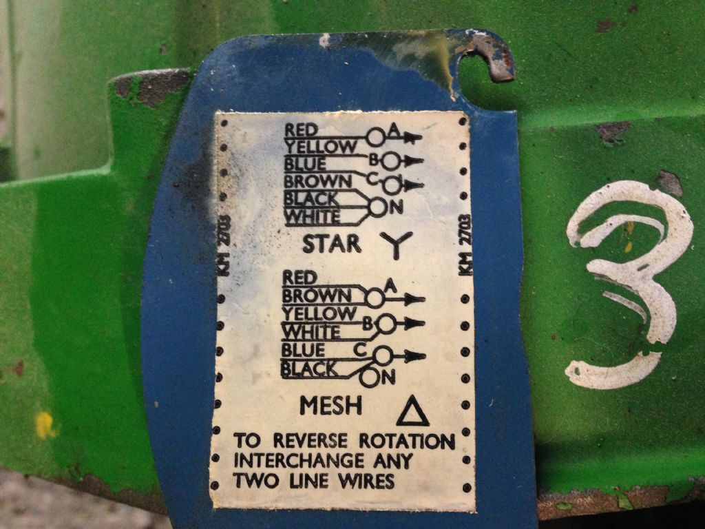

          Hi Alan,
          Wire it in what they term as Mesh, more commonly termed Delta and it should run fine from an inverter of the correct KW rating. Not sure what that would be as my boxford had its motor replaced with a single phase when I bought it.

            As Graeme says, remove the wires from the N terminal and reconnect them as per diagram, leaving N terminal unused.
            This will wire it in Delta and it will run from your inverter. I used an inverter on my shaper and it was fine.

                    I've been asked if I can cut a couple of key ways with the shaper and I think I will, my question is I don't have a tool made to do it yet any advice on style would be handy or a photo even better, I have an idea how to go about it but the more info the better me thinks, By the way Robbo I have the wiring done on the motor just need to connect the inverter wires into the back then it will be time to play? I mean test of course.
