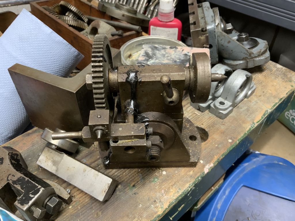

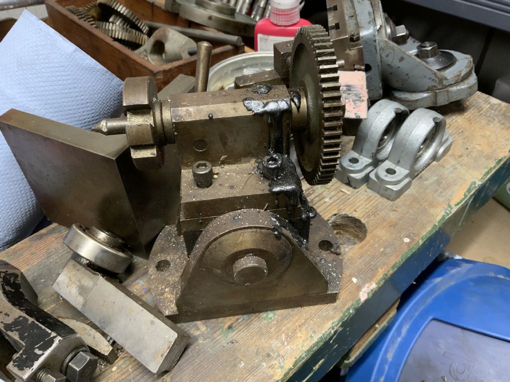

                                        9fb011e0-1399-46e1-a10d-9e32e1e05252.jpeg6abbb512-85cc-4a06-b487-318c8a08d742.jpegHi just going through some of the inherited parts I have. I have no idea what these are for ? I’m sure you guys will know?

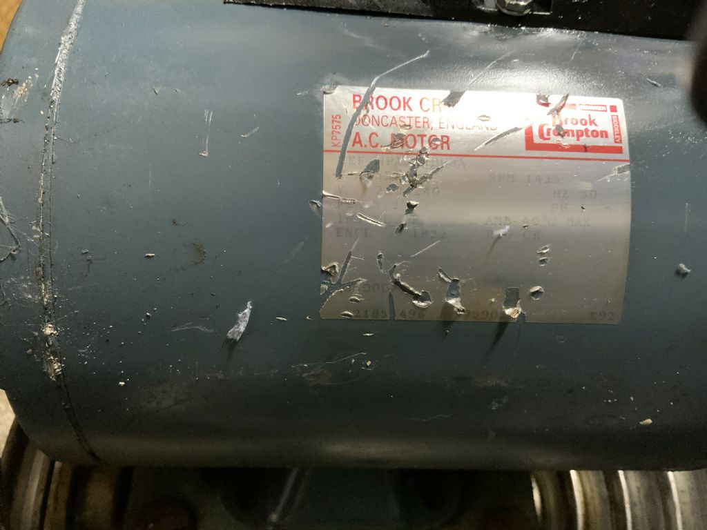

                                        old drive belt off now and doing bearings on pulley shafts. Label on motor is a stuck on one that is scratched up so can’t see the HP of it. Will post a pic. Old drive belt to head stock was so soaked in oil could almost ring it out.12e4265d-9e9d-4f15-a87b-7abf572319a0.jpeg

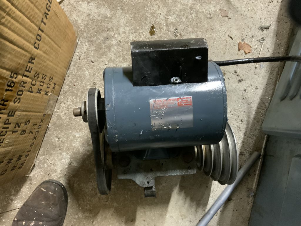

                                          2efc4165-bed7-43ec-8b6c-a71d63f5cb7e.jpeg6334bfe7-74a1-48e5-b969-136296596402.jpegMotor from the lathe. Cant quite read what HP it could be?

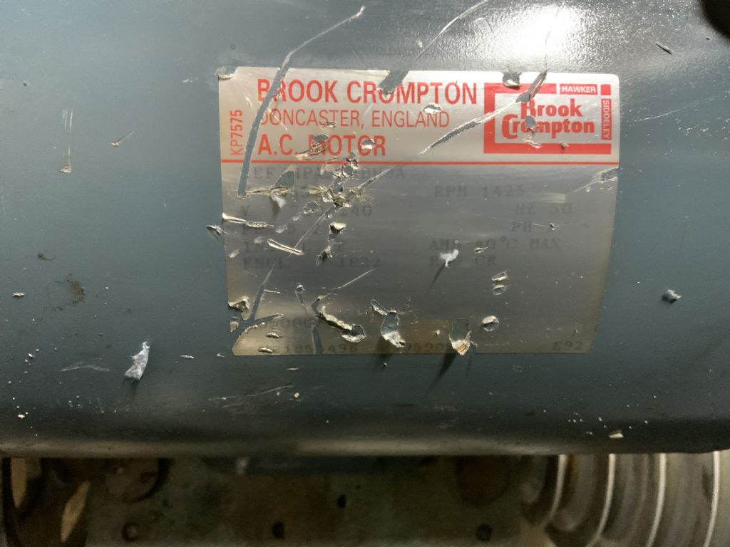

                                            MOTOR, can you read any of the numbers ? wattage – 550 or 750 ?, amps 5.4 or 7ish ? ,rpm1425 or 2850. I take it to be single phase ? The numbers are a rough guide. Noel

                                              looking at other Brook Crompton labels (KP7575), the power is marked in Watts on the left hand side of the second line of the typed printing.
                                              Unfortunately, the KP7575 is the part number of a blank label and doesn't help to identify the motor.
                                              Your label shows 240 volts 1425 rpm, single phase, IP 22 and 40degrees C max
                                              I think I can see the wattage marked at 550 watts which is a 3/4 Hp motor ?? as Noel said above.
                                              My Boxford AUD has a 3/4 Hp motor which is adequate, but lacks power for really heavy cuts but good for most of the time.

                                                  Looking at the first picture of the Heritage items.
                                                  At the back there is what looks very much like a Swivelling Vertical Slide for a Series 7 Myford.
                                                  Front left is what looks like a Rear Toolpost, with part of a "boat" type tool holder.
                                                  The Angle Plate at the back of the piocture looks to be a useful piece of eqyipment.
                                                  The centre of attraction looks as if it might be a Tailstock for Dividing Head or Rotary Table, but it looks as if it equipped for direct dividing. The gear might even be a 60T Myford one. Is there a chuck, even on a spindle, that would fit in place of the centre?
                                                  Are the gears at the far back changewheels for the Boxford?
                                                  Howard

                                                    Hi yes was confused why you would want a diving type device with a centre, makes more sense to have a Chuck like you say. There is a notch cutout I n the Centre with a grub screw lock something in. Yes the gears are for the boxford. Vertical mill slide is a good one to have. It was seized but stripped and found the dovetail locking side grub screws were solid and locking the slide. Managed to get them out all bar 1 and drilled that out, full clean and strip and re oil and works well now. Think it’s ok with only 2 of the 3 screws in. I don’t have a spare. The other bits of kit are confusing for sure. Definitely some form of indexing that can be locked.
                                                    hard to see the motor label, but will stick with it as it works. If I run out of power on it I will look to upgrade later.
                                                    can’t find the motor part number at all online so guessing it’s nit made anymore. It’s not the original motor for sure.
