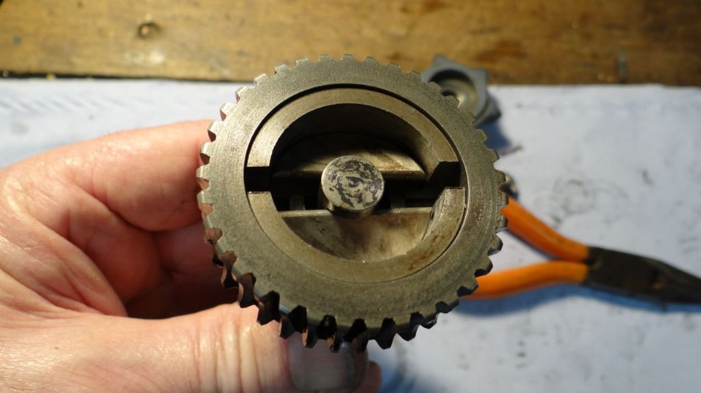

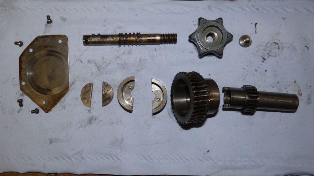

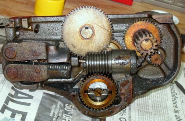

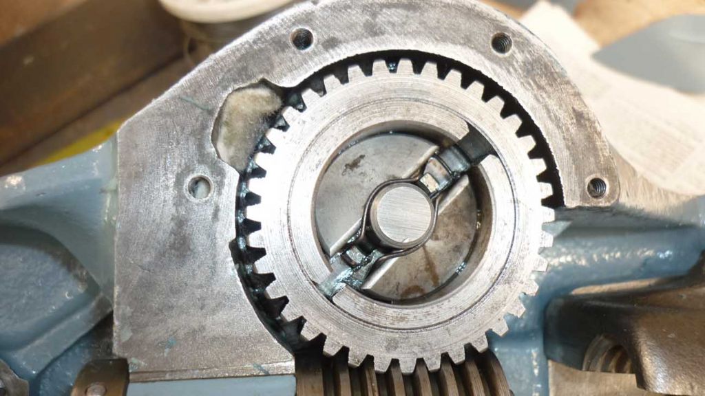

        Scrumpy
          @scrumpy
          Hi all have stripped the saddle down and I have found the problem the 2 half moon chevrons that fit inside the clutch are missing does anyone have any idea what size they are and what they are made of or who can supply new ones I think the number is 52 in the catalogue
          The left hand bolt in the end of the star wheel is also missing does anyone now what thread or who could supply me with one thanks

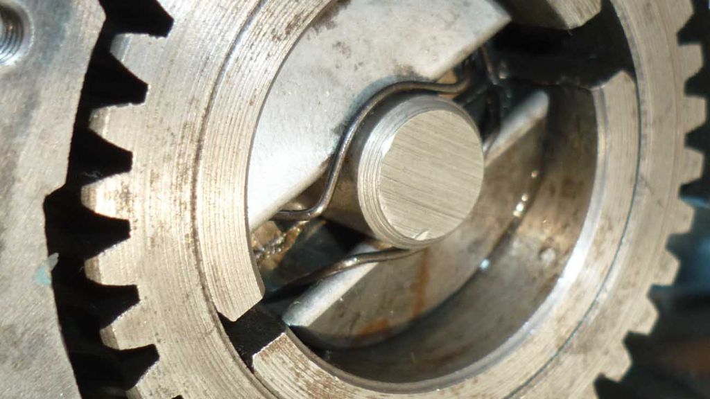

              #277166

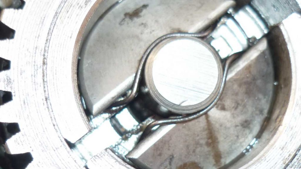

              mark smith 20
                @marksmith20
                On my 1964 Southbend there is a spring clip on the inside end of the clutch. Most peoples seem to be missing whenever i see photos of southbends, also missing from the 1942 one i have nearly finished putting back together., Does the boxford have such a clip?
                The clutch appears to work fine without it though.
                Edited By mark smith 20 on 11/01/2017 19:58:45

                      I don't think you nee to be too precise with them actually. The curve I just so the fit the hole and don't rattle too much. In operation the bit that does the job is the centre part of the curve that jams into the bottom of the clutch cylinder. If the diameter is too great it catch at the sides not the centre and if it is too small it will twist off line.
                      The diameter edge is rounded off to fit the groove in the central operating rod.
                      I think a few experimental cardboard ones will soon find the fit if nobody has one in pieces to measure.

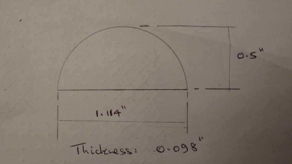

                      #277802

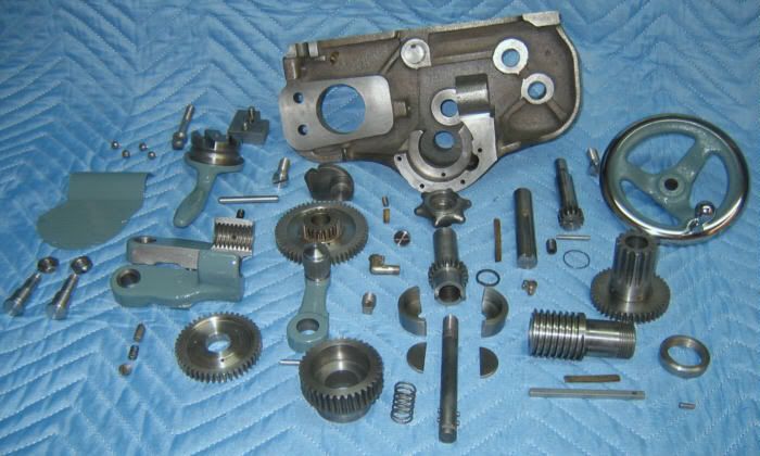

                      larneyin
                        @larneyin
                        Exploded view of clutch assembly
                        Exploded view
                        "Half moons" in position
                        Half moons in position
                        The half moons on my BUD are the same size as the "floor" of the clutch brake halves, i.e. when lying flat inside the brake shoes the flat edge is flush with the brake shoe edge
                        Here are the dimensions of the ones on my lathe
                        Half moon dimensions
                        The inside diameter of the brake shoes when in position in my machine is 1.180" which would be to OD of the half moons (near enough)
                        Both the straight and curved edges are well radiused as described by Bazyle
                        Hope this is of assistance
                        #277817
                        Mark C
                          @markc
                          I think if you make the OD to fit the clutch cups you will find it works OK. I think they are are about 1/8" thick (3mm) and as Bazyle mentions, just make them progressively smaller until they sit at the correct angle (by eye will be good enough)
                          Mark

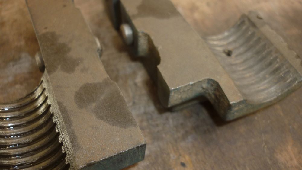

                            mark smith 20
                              @marksmith20
                              I`ve been meaning to restore the half nuts on my spare southbend 9A. Havent got around to it yet but once ive figuring out how to clamp the half nuts for boring out the old (whats left of them)threads ,it should be pretty straight forward. I`ll be using the method popular in the USA of making a threaded bobbin out of bronze and gluing and pinning it into the half nuts before sawing them apart..
                              Like sort of described here:
                              **LINK**
                              Edited By mark smith 20 on 15/01/2017 11:27:14
                              Heres a photo of the half nuts that need repaired ,they are in fact boxford ones but fit perfectly in the southbend.The proper southbend ones are on the right which are on my good lathe.
                              Edited By mark smith 20 on 15/01/2017 11:30:23
                              Edited By mark smith 20 on 15/01/2017 11:33:45

                              Scrumpy
                                @scrumpy
                                Lovely post I feel I would try to set my half nuts in my beaver mill and remove old threads but I would have a problem cutting the nut before splitting so over to a local machine shop I think
                                #277912
                                Scrumpy
                                  @scrumpy
                                  Sorry I should have replied to Mark no there is no spring

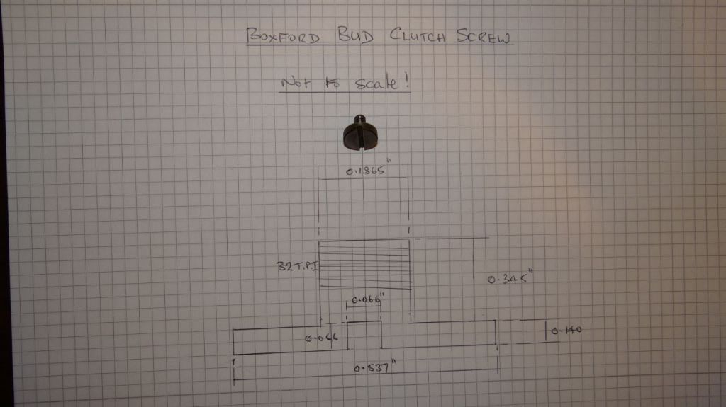

                                  Scrumpy
                                    @scrumpy
                                    Hi All I have been told by Boxford they have the clutch plates after all , last week these were not avalible but after another search they have found a set .
                                    Does anyone have any idea what size and pitch the left hand threaded bolt is thanks
                                    #278192
                                    larneyin
                                      @larneyin
                                      Hope this rough and ready sketch isn't too dark
                                      LH Screw
                                      Looks as though the thread is 3/16" x 32 BSF
                                      #278198
                                      Scrumpy
                                        @scrumpy
                                        Hi thank you so much it came out fine Derek
