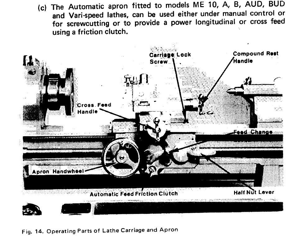

        i have been given a Boxford Cud lathe we think it comes fully fitted with lots af extras it has been stored for some 10 years on trying it works quite well except the travice will not work either cross or longitude you can close the nut for screw cutting the lead screw works both ways but no travice has anyone any idea what this could be and how I can fix it . I would like to change the belt but it looks like a major strip down is this so any help appreciated

            A CUD doesn't have cross feed. That's on a BUD. The CUD uses the screwcutting feed for longitudinal traverse. However you might have a BUD anyway otherwise it would be obvious there is no separate feed arrangement.
            If you have a 'star' wheel and a lever with a detent on the front of the apron in addition to the half nut engagement then it is a BUD.
            Feed is engaged by moving the lever up or down (it interlocks with the screwcutting halfnut lever to prevent dual operation) One is for longitudinal and one is crosswise. But you also have to gently do up the star nut to engage the clutch.
            DO NOT rely on the clutch to stop the saddle as it might stick and note if you ever try to strip the apron the screw in the middle of the star wheel is LEFT HAND.

                Same as Bazyl, disengage the screw cutting half nuts. Select longitudinal feed by moving the select lever upwards. Tighten the star screw tightly clockwise to engage the feed. If the feed doesn't work, strip the saddle down. It may be that the key that slides along the lead screw groove has broken / missing. Take heed to Bazyls warning about the star wheel screw . It is LH thread. Ie screw it in clockwise to remove the screw.

                          Have you tried tightening the black star shaped knob sticking out of the apron ?
                          It needs to be screwed tighter until you get a reliable feed. It's a slip clutch so that the saddle can be run directly onto a bed stop. Something I regularly do. It needs to be set tight enough to take a cut. To check slacken it right off (unscrew) and see if the saddle feeds along. It probably wont. Try a bit more tension. It might move a bit and stop etc, You might be able to stop it with your hand when it's very lightly set. When you actually come to turning just tighten it up more until it feeds reliably.
                          The 3 position lever suggests that it has both feeds. Both disengaged in the middle and saddle feed when it's in the top position. Hope I have that right. I hardly ever touch mine and it's currently in the top position for saddle feed which is all I use. This is an ME10 but as far as I am aware all are the same when the feeds are fitted.
                          You can find the parts diagrams on the yahoo group – very useful if you actually do need to strip it down. I'd suspect it's just lack of use and a loose clutch setting.
                          Oh – don't try a bed stop when it's screw cutting – it would be a disaster.

                            Does the leadscrew have a keyway all down the length? If not it may be a CUD with a BUD apron intending a conversion.
                            If the 3 position lever is put up or down not he middle neutral position the star wheel should turn when the leadscrew is turned. If not there is something up with the initial gears or the key that picks up the drive to the worm. The worm slides along the leadscrew and engages a brass wormwheel which might have been damaged n a crash.
                            If the star wheel is turning as above the problem is with the clutch which is a bit of an odd design and can fall apart if someone messes around and undoes the starwheel retaining screw then undoes the wheel letting the shaft move in too far. This can look like it is repaired by putting the star back on but the internals have fallen apart.
                            When removing the apron put a plank on the bed, prop up the underside of the apron with several small wood sheets, then undo the screws. You can then slide out the sheets progressively dropping the apron. This applies to most lathes and is more significant for bigger ones where you can't hold the weight in one hand while undoing the screws with the other but good practice.
                            One of the socket end grub screws is a lock for a second one deeper down the hole. Make sure you use genuine imperial unworn allen keys to avoid rounding the sockets.

                                If the feed clutch is in good order (and has the plastic black star wheel – the newer type that does not turn when the saddle moves) you will break things with it as it is NOT a slipping clutch. There are two different types!!!

                                      Bob, that is the old type – that will slip, the new design may not, especially if you tighten it up!

                                          Bob, I have both types and the early one needs to be tight or it will slip. If you tighten the later one as much it will not slip – or mine doesn't at any rate. I use a stop on mine and the first time I used it on the VSL (same as yours but with bigger spindle) it pushed the thing down the bed, which would have been a disaster if I was not watching at the time!

                                                  There is a sort of cup in two halves each of which is pushed outwards to engage the walls of the hole inside the wormwheel by two half moon shaped pieces . These are held at an angle against the shaft that carries the star wheel. Sounds a bit odd but you will understand when you find it. Somewhere on the web is a complete rebuild of a Hercus which is the same done by a guy in Australia.
