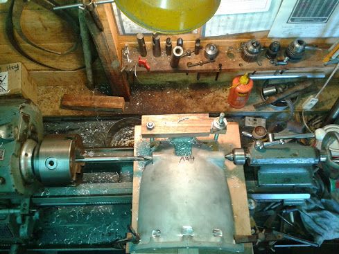

                      Hi Gordon, in-line boring is great if you can mount the cylinder block satisfactorily. This photo is of a vintage car clutch housing being in-line bored before through reaming 15mm diameter. on my Boxford Lathe The length of the bore was about 11" long, and the operation was completed with an extended reamer with a 'slip bush' to keep it aligned.clutchhousing.jpg
                      The photo shows drilling before line boring between centres. Note the simple mounting of the casting (aluminium) – just sitting on a sheet of plywood.
