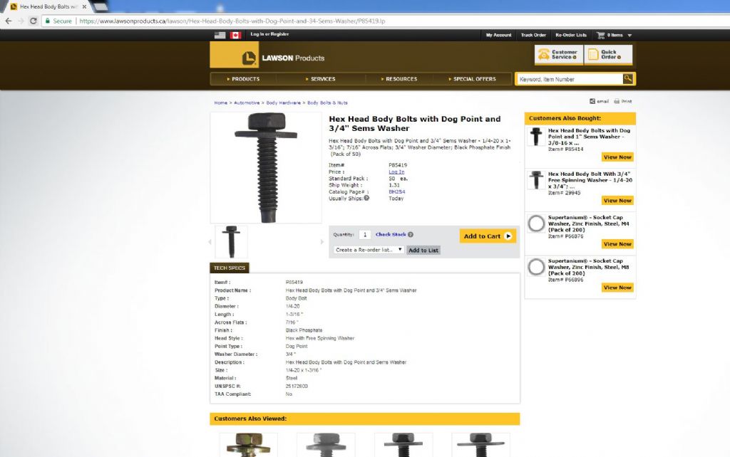

                                Clive it sounds like what you are looking for is a SEMS hex head body bolt with a dog point and captive washers. These are available at most car parts stores here in north America but not sure about the UK. You could call a dealer for your make of car, describe the year and make and where the screws go, and they can probably provide some. Failing that you could contact a manufacturer of these bolts like the one in the pic below and they will likely send you a few.
                                I would not mess around rigging up some other sort of fastener to hold such a heavy 3.5 mm plate on a car. Chances are this plate carries some significant loads if it is that thick, so it is wise to use OEM spec screws as originally fitted. If your rigged up screws ever broke while driving on a highway, there would be a big chunk of metal flying about under the car that could be a major hazard to your car and others.

                                    Clive B 1
                                      @cliveb1
                                      Thanks for all the info guys,
                                      I’ve had a quick look on the net but not found any screws, well certainly not M10 x 1.25 pitch with an hexagon head and in the UK.
                                      I know I could try the main agents but no doubt they will be at some silly price even if they have any, so I'll just get some 8.8 steel ones and for what it’s worth bung a couple of nuts on the thread as a register and file a dog point on them plus make sure there’s not a load of screw sticking up beyond the nut. when they are in place.
