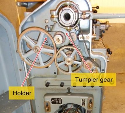

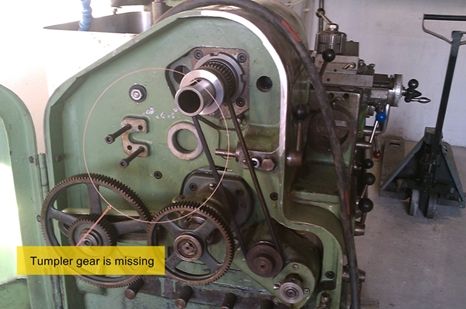

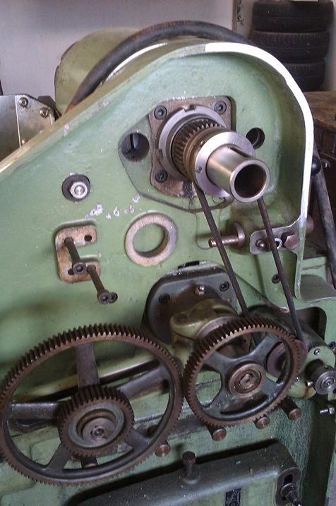

                    #140239
                    RK 2014
                      @rk201481933

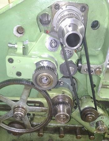

                      Hi guys,
                      I also have Boley 5LZ, which I bought recently and I am restoring it now. Could someone of you help me please to get the main dimensions of the tumpler gear, which is misssing on my lathe? I intend to manufacture a replacement of it. Also a photo could be also helpful.
                      Thank you,
                      Roman

                            Posted by RK 2014 on 10/01/2014 15:38:10:
                            Hi guys,
                            Thank you,
                            Roman
                            Hi Roman, do you intend to make an identical copy or something that is just functional.

                            #142173
                            RK 2014
                              @rk201481933
                              Hi Phil,
                              my idea is to make a functional replacement if the original tumpler gear, not identical copy as for it it is a casting necessary. It should be a case consisted of be two side steel panels holding the bearings of the plugs of the gearwheels. I can perform milling, turning, welding but not casting.
                              Could you make a photo of the tumpler gear of your Boley and send it to me via e-mail ([email protected]), please?
                              Thanks,
                              Roman

                                #142269
                                Philip Burman
                                  @philipburman66049
                                  Hi Roman, Email sent. It's 21mb. If it's too large I will send it as several mails if you let me know you maximum file size.
                                  Phil
                                  #142279
                                  RK 2014
                                    @rk201481933
                                    Hi Phil, hi Mike,
                                    thank you both for your help and for the photos of the missing tumbler gear! I believe it will be possible to fabricate a replacement.
                                    Roman

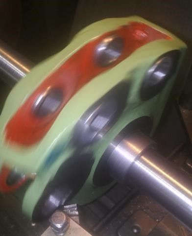

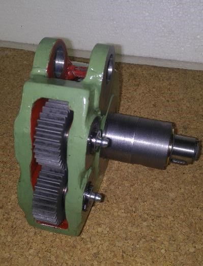

                                            Hi Robert, yes, I have few pictures of the missing tumbler gears which I have machined. Describe more your situation and needs, maybe I could help you. It is still in progress, once I will complete it I will share more pictures. Now two examples at least.img_20181124_211028.jpgTumbler gear
                                            #383986
                                            Robert Söderström
                                              @robertsoderstrom96062
                                              Wow, have got a new housing cast by a foundry? I am completely missing the tumbler arrangement (and gear bracket)on my lathe,collected it on friday, and although I searched high and low and found a lot of small pieces I could not find those parts I am very interested in any plans or info regarding the construction of it, I am guessing it consists of three gears? Gear connected to output shaft on center of rotation? Gears are the same module as change gears I assume?
                                              Looking for all info I can get on the part. Probably not going to cast a new housing, rather build it up in simpler manner with flat stock and standoffs etc.
                                              #383989
                                              RK 2014
                                                @rk201481933

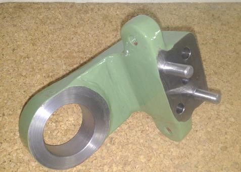

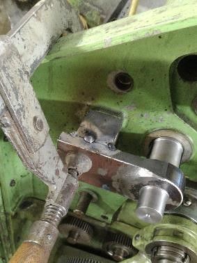

                                                The housing has been made of 7mm steel plates and two flanges. All together it is welded and later on machined. The small bores were reinforced to accommodate the inserts and keep the shafts.
                                                I can send you photos of the original tumbler gear by e-mail.

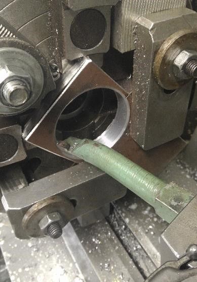

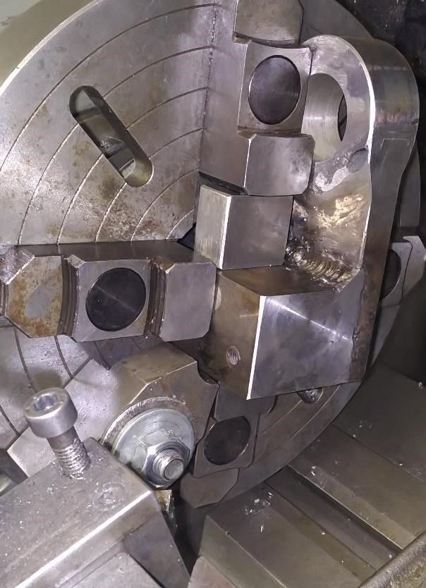

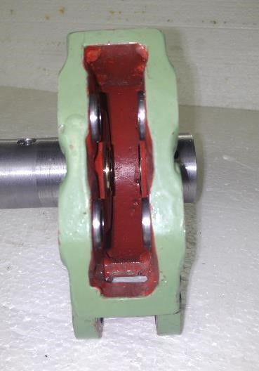

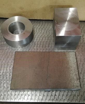

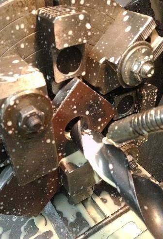

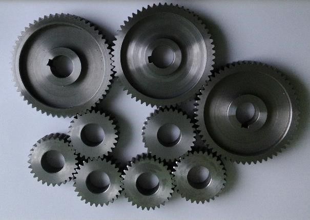

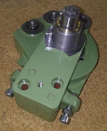

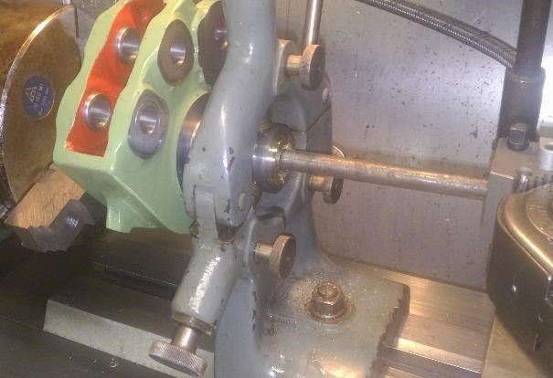

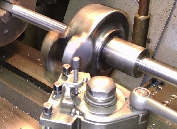

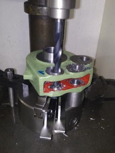

                                                  #392456
                                                  RK 2014
                                                    @rk201481933

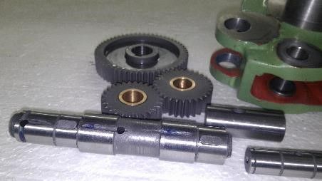

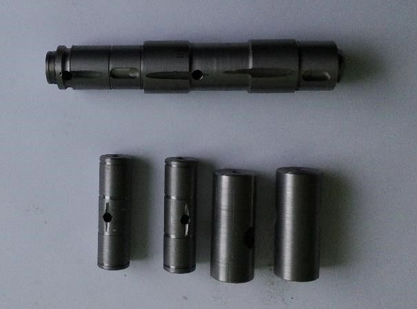

                                                    As promised below are few photos of tumbler gear manufacturing. The steel used for the wheels, shafts and spindle is 16MnCr5. They were cemented and hardened. The gear housing is from standard weldable steel. After welding the housing was machined on the lathe and the holes drilled and reamed on the milling machine to assure parallelism and the right distances in x and y axis.
                                                    Similarly I machined the holder, it is welded from three parts and finished on my lathe using face plate. All bushes are bronze, reamed after their pressing in to the holes.
                                                    Many thanks to Phil and Mike for their photos of the original tumbler gear parts! It helped me a lot.WheelsSpindle and shaftsHousingHousingHousingHousingHardened partsHousingHolderHolderHolderHolderHolderHolderHolderTumbler gearTumbler gearTumbler gearTumbler gear
                                                    #392476
                                                    Robert Söderström
                                                      Nice work! Very good to get some inspiration for my own build. Mine is probably going to be a bit less detailed but we will see what the future brings.
