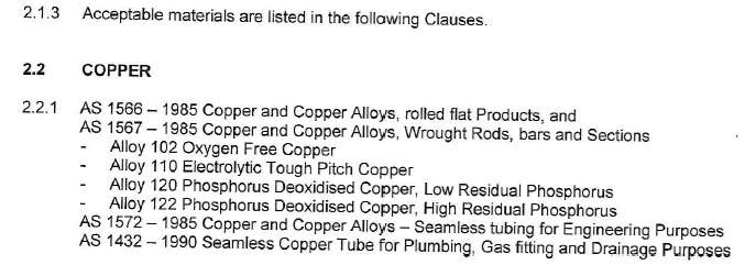

                                  Why would you want to add various grades of copper to your proposal when there is only one preferred grade for boiler barrels?

                                      I agree with your 3rd point, infact my argument has been and still is “boiler failures do occur but are never reported” therefore no one can say “there have not been any reported boiler failures therefore the design must be ok”.
                                      C101 (Oxygen-Free Electronic Copper – OFE): 99.99% pure, very low oxygen content, excellent for high-end electronics.
                                      C102 (Oxygen-Free Copper – OF): >99.95% pure, suitable for applications needing high conductivity and ductility.
                                      C110 (Electrolytic Tough Pitch Copper – ETP): >99.9% pure, good conductivity, widely used in electrical applications.
                                      Commercially Pure Copper: Contains 0.7% impurities, soft and ductile.

                                          Hi Jason,
                                          Interesting the AMBSC section 2.2 states accepted grades of copper are:
                                          Copper
                                          Fair point the overall topic is the use of YP, however if you followed the thread their are several topics being discussed, one being “there is very little evidence of boilers failing due to the tube being too thin” I’m stating that their is no data to substantiate this claim, lack of data does not indicate lack of issues, it could just as easily mean no one bothered to report them or their is no way for the public to know.
                                          #807086
                                            Nothing funny about it C106 and 122 can be taken as equivalent, just depends who’s designation the particular country uses. Anything else as I said check with who is going to sign it off. No point in wasting money and time on a meterial the inspector may not be happy with.
                                            As 99% of the membership here are UK base I tend to stick with what is accepted here. Including our test code.

                                              lezsmith
                                                @lezsmith
                                                Hi Jason,
                                                Thank you for the info, I’m not being funny about the grades of copper, to be honest most of my engineering work revolved around rolled steel joists and re-bar so I’m not as familiar with copper.
                                                I see Alloy 122 in the AMBSC chart and happy to take your word that C106 is the same, however it still leaves a big difference in that the AMBSC also accepts 102, 110 and 120. I’m trying to understand where the Australian, UK and USA standards overlap (if they overlap at all), here in Thailand the local codes tend to follow the USA standards and living and working in the USA I tend to be more familiar with ANSI.
                                                I’m assuming you refer to BS-EN-1254 and BS-EN-1057, if that is not correct please point me to the appropriate standards you use.
