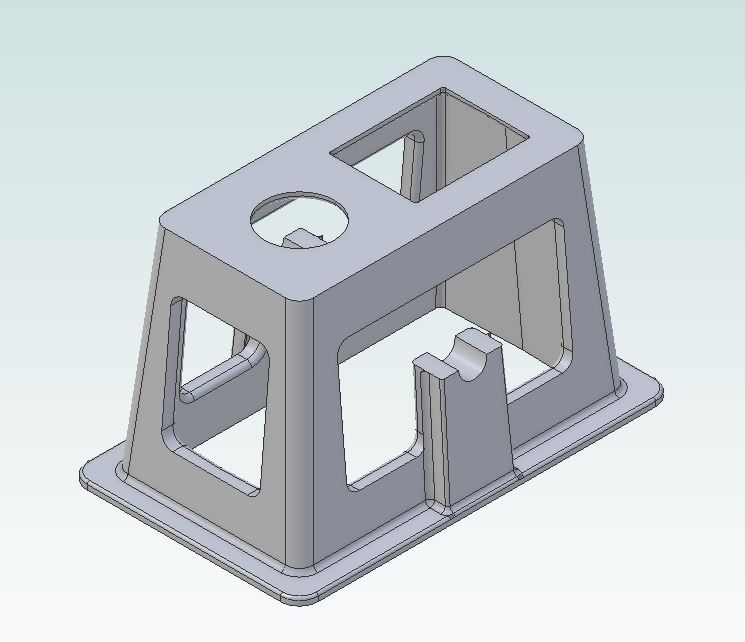

      Now that Dave (SOD) has unravelled how to draw his cotton reel here is one to think about while digesting all those Easter eggs. DC-1 may also be interested as he mentioned wanting to do some pattern making.

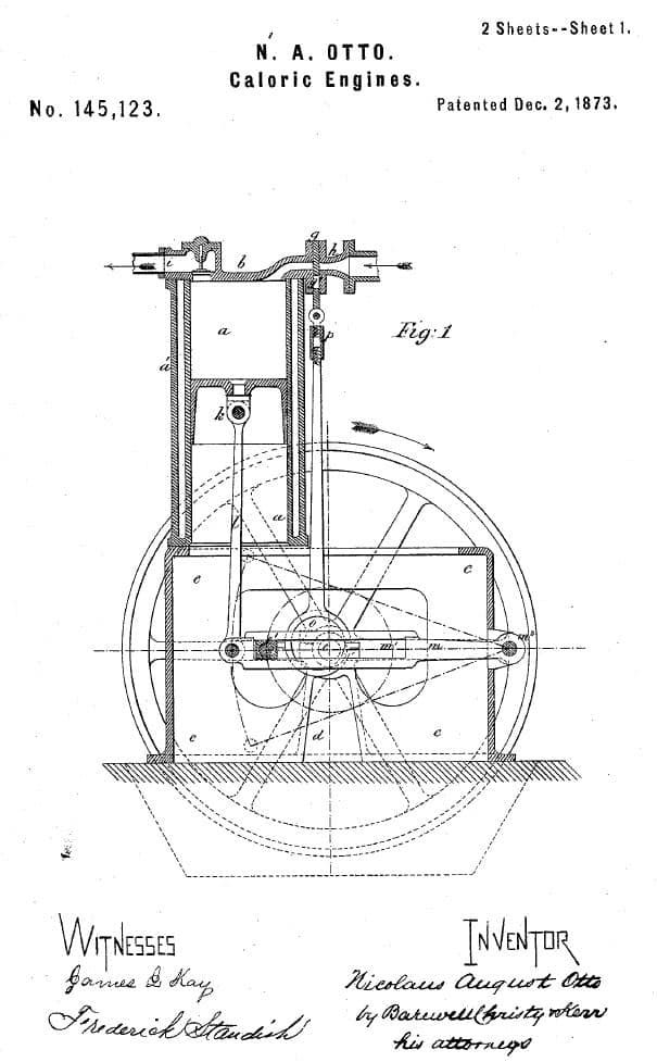

      Over the last week or so I've swapped a few e-mails and FB messages wit Graham Corry of Alyn Foundry fame as he had found details of Nikolaus Otto's flame sucker of 1873 and fallen in love with it. Some useful input also from Wayne Grennings and Linda Boots

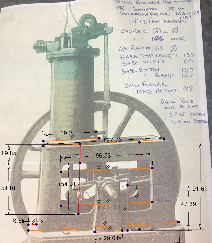

      I got another e-mail from him about 4.00pm yesterday asking if I could do a pattern and corebox for the base. together with this image and a note to say he has 7" flywheels that can be used so that will be what the drawing needs to be scaled to.

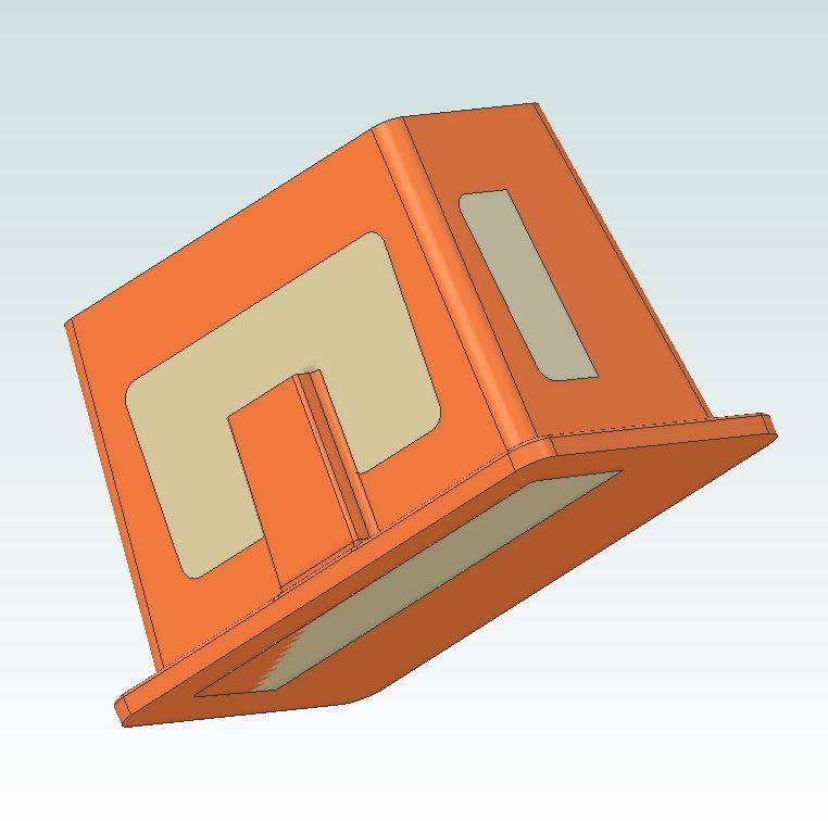

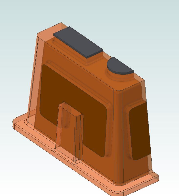

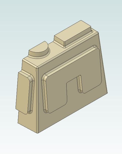

      Well it sounded more of a challenge than cotton reels so I fired up alibre and in an hour or so had the basic pattern and core worked out.

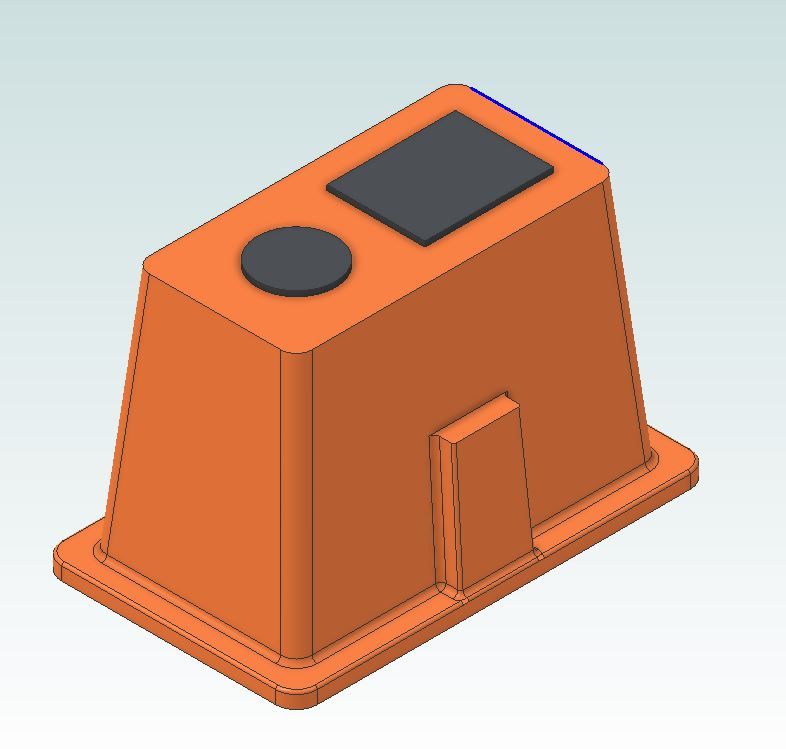

      Pattern
      Core half

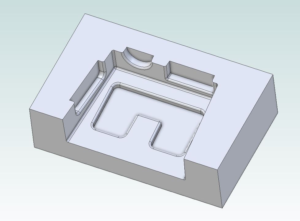

      I've played about with it a bit more today and now have the core box halves to mould the sand core in
      And this is the pattern with the core "removed" and the surfaces that had a machining allowance taken back to finished size. Still some small tweaks to do but just modelling the basic components to check geometry first.

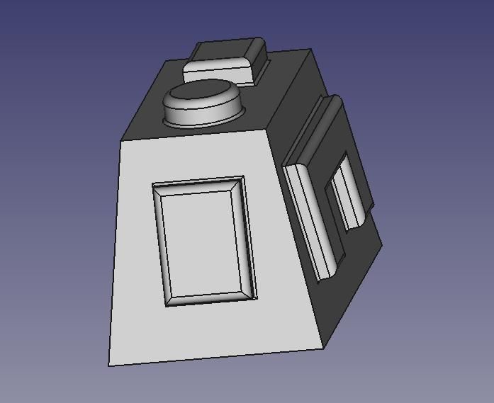

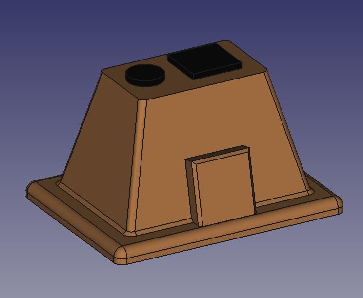

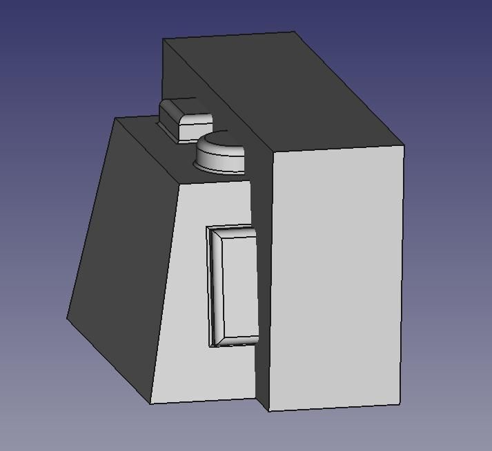

            This may be my nemesis! So far so good, though the way FreeCAD colours faces has me in me a tizzy:
            #594608
              Hmmm, the need to think about negatives and positives for castings has stopped play. I shall have to sleep on it!

                    Paul, there are basic sizes in the second image I posted which graham had worked out using a rule and calculator. I imported the image into CAD and scaled it to show the flywheel at 178mm (7" ) then any line I drew on top would give me a measurement.

                      It wasn't making negatives in CAD that had me confused. It's the thought process required to work out the shape of the mould needed by a sand core. Even though I have high confidence Jason knows his stuff, I'm still not convinced this is correct:

                        Despite not being able to see properly:
                        Less than half an hour – had to stop and feed the cat!
                        All done by eye, but I could go back and dimension it properly.

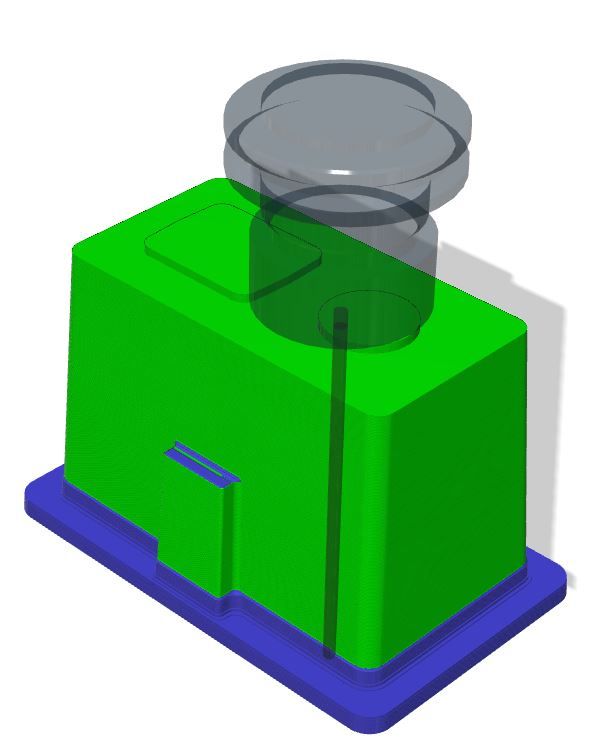

                            All the core features will have draft so should come out of the core box OK.
                            Dave, yes you do need to understand the casting process to know what the core needs to be made like so that it will do what you want.
                            Basically the pattern will form the cavity in the sand. The core is then place inside this cavity. It is located front and back you the two large projections touching the surface of the cavity and the same at one end. To stop any risk of it moving end to end the two projections on the top of the core that form the round and rectangular opening are longer so that they go into the two registers created by the black core prints on the pattern.
                            This shows the core inside the pattern and you can see the protruding features come to the faces so iron can't flow into the holes in the base casting
                            This has the pattern set to transparent so you can see the core in place
                            And finally a section along the ctr line showing where the metal will and won't flow. We decided to go thicker than scale to ensure a good pour. The top and bottom surface swill be machined back to leave 3mm thickness and if desired the walls can have a tickle with a die grinder to make the edges look thinner.

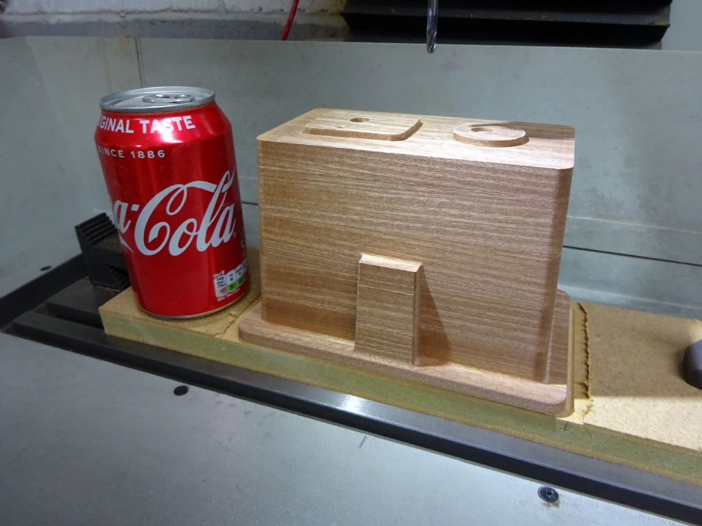

                              Well to avoid my screen turning red with collision warnings in F360's simulator I has to set quite a bit of tool stick out, 115mm to be exact particularly as it was only a 4mm dia ball nose cuttersurprise.
                              Pattern looks to have come out OK though and all tools intact smiley
                              Core boxes next on the list but only about 50mm deep needed.

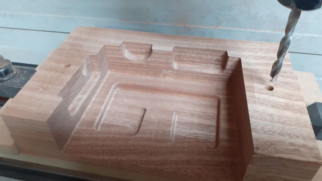

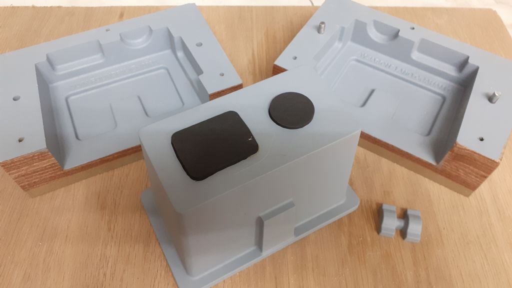

                                      One half of the core box having been machined, last op was drilling two 6mm holes for dowels, HSS Lip & Spur drill
                                      And bot halves complete with the base pattern and the small item at the bottom is a pattern for the pair of bearing caps. Should be off to the foundry tomorrow.

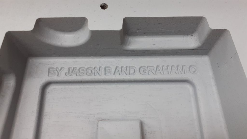

                                        I don't think I have ever seen anyone put the lettering in the core, and not by CNC either.
                                        Saves having a two-piece pattern.
                                        Reversed lettering I guess.
                                        Edited By PatJ on 28/04/2022 20:33:14
                                        #596253
                                          No the lettering is the right way round, it will be in reverse when you look at the core produced from the box and that will then leave the cast impression the right way round.

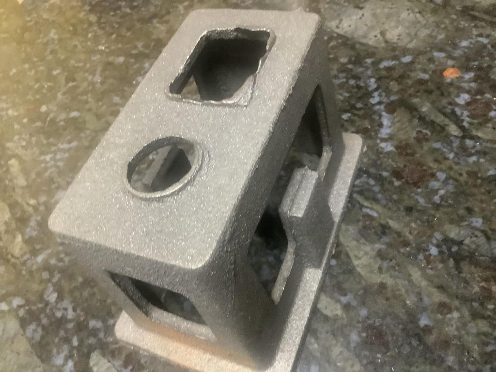

                                                My castings turned up today and I'm quite pleased with how they came out particularly as it was my first pattern with a core. External surface finish could have been a little smoother but I think that is one of the problems with airset as they don't seem to sieve any fine sand on first and just ram it up in one thick layer which can leave the sand surface a bit porous so the iron replicates that. These are the bits from my patterns
                                                The bit of writing that was a last minute addition turned out quite well, easily read yet out of sight for most that will view the model.

                                                  You can improve the surface finish if you can get them to spray on a layer of ceramic mold coat.
                                                  It is generally alcohol-based, so you spray it on and then burn off the wet part.
                                                  Works wonders for surface finish.
                                                  Great job.
