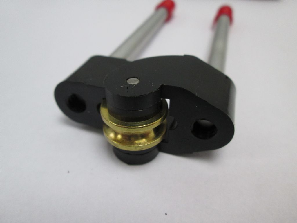

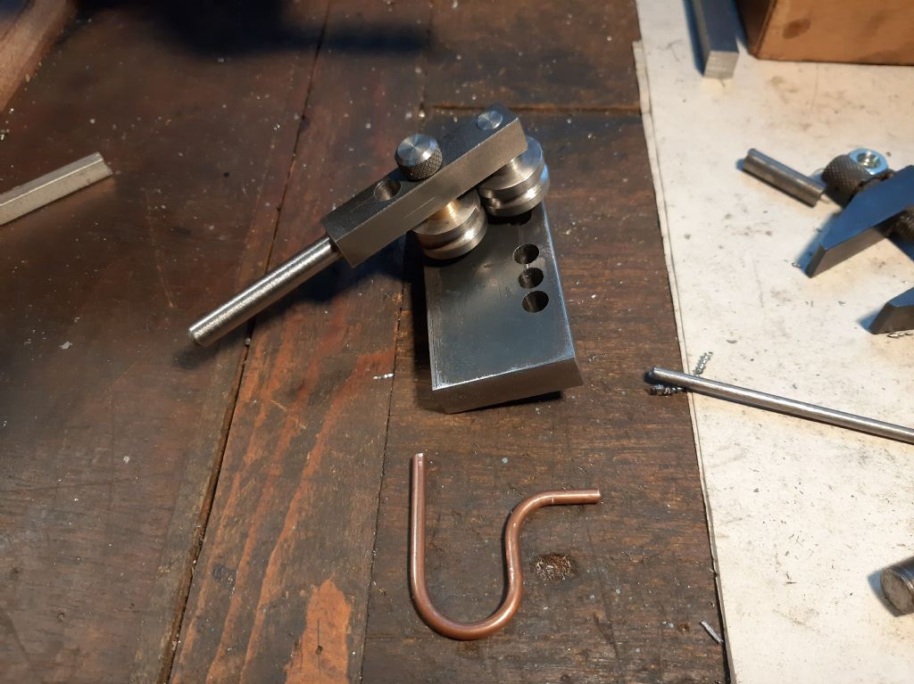

                        I also needed to make some tight bends close together on 5/32 tube. I bought the Dubro and its former wheel groove diameter is 11mm, so 5.5 mm +5/64" cl radius. The disadvantages of the Dubro are that it needs 12mm or so of straight tube before and after the bend and its plastic body means that it will only bend annealed tube.
                        I then wondered how I could make the simplest possible tool and came up with this:
                        Took half and hour to make and although restricted to 90 degree bends, it works a treat on un-annealed tube. Groove diameter of the former is 7.5mm. Make sure the groove is deeper than half the diameter of the tube so the tube is positively prevented from going oval during bending and the groove in the clamping block needs to be shallow enough that the tube is solidly clamped when in the vice.

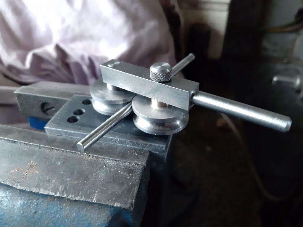

                          I'm really pleased that I made the pipe bender in the last MEW.
                          Not that difficult to make and gives really neat bends.
                          Made some 1/8" formers yesterday and then made my first component part.
                          No prizes for guessing what it is?

                                    Steve there is a thread on here for pipe bender I have made.
                                    Search for Derek browns pipe bender MEW297 and you will find it.
                                    There are numerous drawings in the thread but a read of the article would help if you intend to make it.

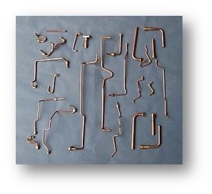

                                    Fowlers Fury
                                      @fowlersfury

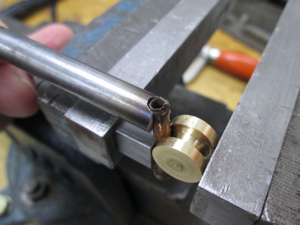

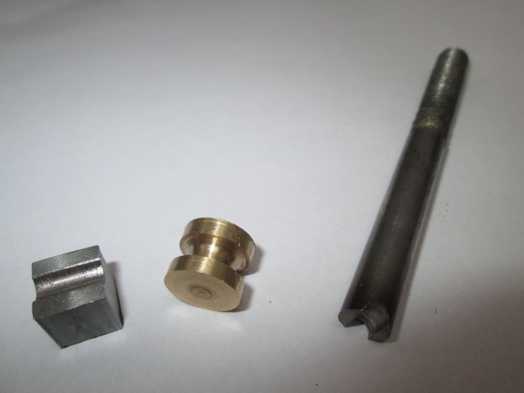

                                      Have you ever looked at "David Carpenter's website"?
                                      Some while back there was a short construction series by "Artisan" on making a tube bender.
                                      As you'll see above, he made no claims for originality. I made one to the design and am very impressed with how well it works, producing tight bends without kinking or other unwanted distortions.
                                      Artisan showed examples of bends his device had produced:-
                                      David Carpenter has transferred most of his older articles to DVDs now which must be a bargain at GBP 7.90 each. Just check on his DVD section on the website.
                                      I made a few alterations to the design such as a stronger baseplate and also discovered an easy and quick way to make the many rollers. I'm happy to provide details if you decide to go this route.
