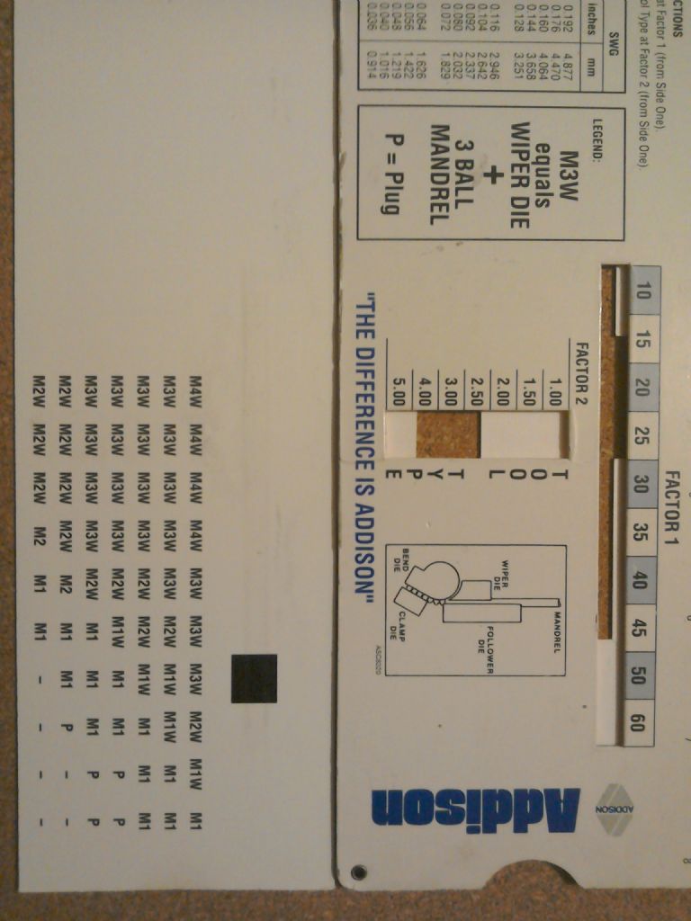

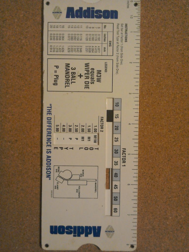

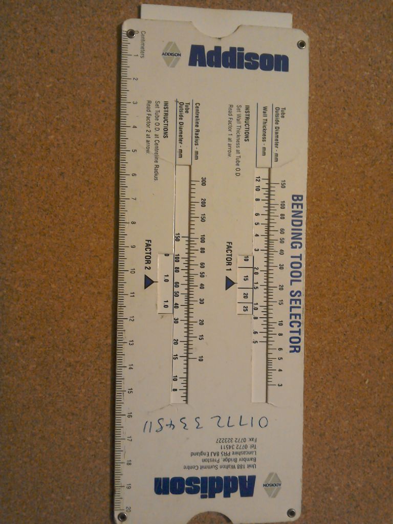

                    There are rules for the tooling needed for CNC draw benders that allow selection of necessary tooling. The larger the OD to wall thickness ratio the more likely you are to need support inside the tube. Also the tighter the centre line bend radius is to the OD the more likely internal support will be needed. I have a cardboard computer (think slide rule made of cardboard) for this purpose. You find factor 1 which is wall thickness to outside diameter figure. Then factor 2 which is the centre line bend radius to OD. On the reverse side you set the slide to the factor 1 position and look down against a window to see what is against factor 2. This tells you if you need a wiper die, plug or ball mandrel and if a ball mandrel is required how many balls.
                    For example 3/4" 16swg tube has a factor 1 of 15 (they are coarse figures for the factors). With a bend radius of 3D (2.25&quot the factor 2 value is 3. The result is the table says this bend needs a plug mandrel but no wiper die. Reduce the bend radius to 3/4" and it says a one ball mandrel with wiper die.
                    This works for stainless steel but I don't know how applicable it is for copper tube, the bending tool selector does not say anything about material.
                    Martin C

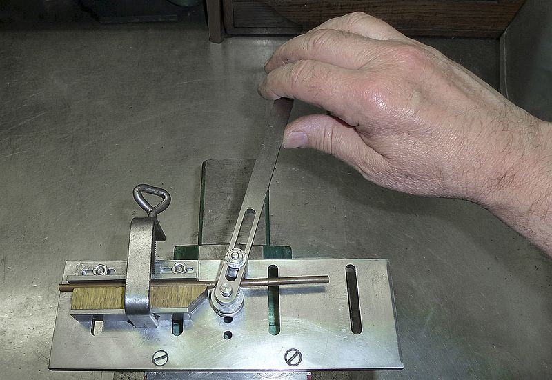

                      Re. your "It seems a good point to fabricate a mini tube bender" and "mag articles on the subject but I do not subscribe".
                      You could wose than look at David Carpenter's FREE ! website **LINK**
                      There have been two designs over the years, the first being **LINK**
                      But the easier one to build, producing accurate, tight curves in small Cu pipes was published by "Artisan". Unfortunately David seems to have moved the article to a DVD now (requiring payment) but I have the pdf and this image is from that, hopefully not infringing copyright:-
                      This is mine and have always felt it worth the effort of making in that my pet aversion is seeing poorly-formed bends in wavy pipes on otherwise excellent models.

                        img_20171110_165519.jpgimg_20171110_165500.jpgPhotos of the cardboard computer I have for selecting CNC pipe bending machine tooling.
                        Martin C

                          Posted by Fowlers Fury on 10/11/2017 14:36:57:
                          Thanks for the second link. That is a lovely piece of kit & worth stopping the build just to make it. I did intend to make something more akin to yours but with a smaller fence to allow closer bends.Looking at the instructions there are quite a lot of bends to make in an engine & one can get better seating on the joints if everything lines up first time rather than being a tad out & trying to force something into line.
                          I also fly RC planes & bending piano wire etc is easier with a neat bender
                          Looks like I will have to make the bender & just make a few wheels & see how the first few bends go
                          Cheers

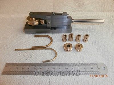

                                I​ made a small bore tube bender from a set of drawings, just can't recall from whom without looking in garage but …
                                The two examples are 1/4" & 1/8" copper tubing.
                                George.
