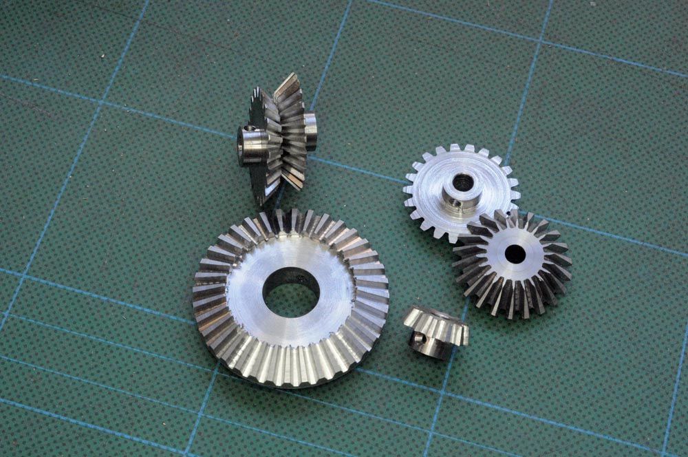

                        Thank you all for the input. The consensus seems to be to start with the bedplate and work my way up.
                        Andrew, I have actually started with the governor drive gears- mostly as a test of my fading intellect(?) to understand the manufacture of parallel depth bevel gears:
                        They will need some trimming
                        Tug, the castings are all bronze so the Swarfega can stay in the tub.
                        I do have the "build log" by Stan Bray and, frankly, whatever qualities Mr Bray has as a journalist, I am less impressed the quality of the work he showcased in ME.

                        Anonymous
                          Posted by Roderick Jenkins on 11/08/2021 14:58:02:
                          That makes you one up on me; I've never made parallel tooth bevel gears. sad
                          Andrew
