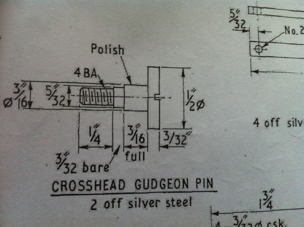

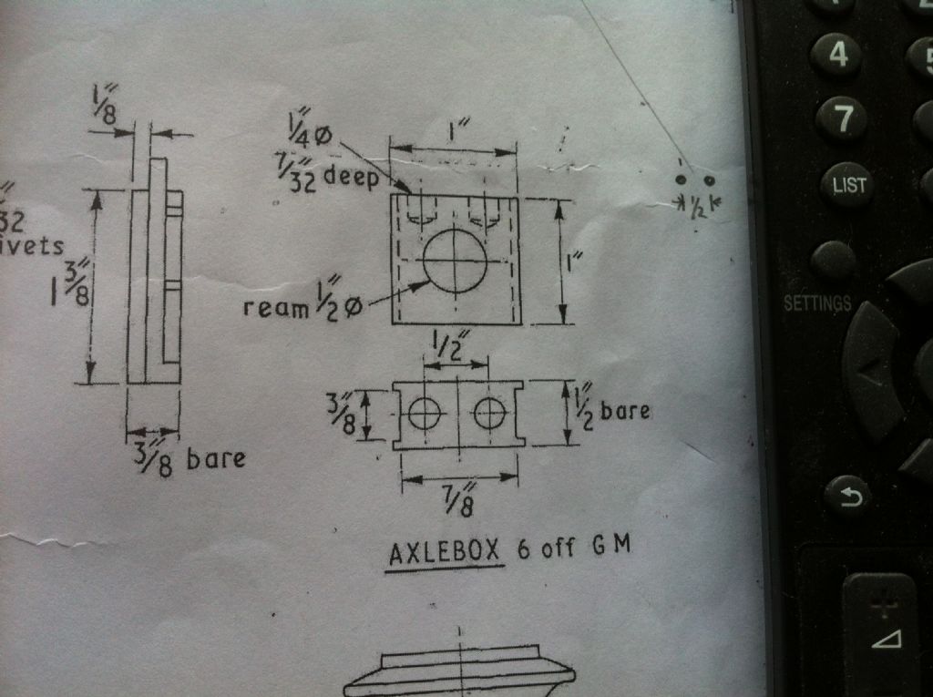

        Would someone give me a clue as to the meanings of legends on some drawings I am reading:
        ⅜ bare.
        3/16th FULL.
        .240 = N.S.
        I am sure i will come upon many more terms that will need explaining.
        Many thanks
        Martin

            Often used on the older ME drawings.
            Bare would be +0, -0.002" eg just undersize and definately not oversize.
            Full would be +.0005, -0
            NS probably non standard but if you can say what the part is and what it fits to could then be sure.
            The best thing to do with these references is look at what the part mates with. If its a press fit in a hole then it will need to be full, is a running fit then it will need to be bare. But just make one part to fit the other as the mating hole may be under/over size.

                These terms were used frequently in UK many years ago when precision measuring was not at everybody's disposal. Bare being as near to size as possible Full tending towards oversize and Free for a loose fit. Colin

                    The legend 3/16 Bare is attached to a gudgeon pin for a cross head so would I be guessing right that you make the shoulder the exact size as the con rod small end's width so allowing the nut to tighten but leave little slop, maybe see if I can grab a shot of what I am talking about and post it here. also on the horns and axel boxes.

                      I bought a set of castings for a robroy from the well known auctions site and among the bits were no horn guides of the gunmetal type but honking great cast iron ones so I have ordered some from Messrs Blackgates to pick up at the show next weekend. In the box of tricks I found what I think are the crossheads but they are gunmetal not MS as per the drawing. WHEN I get round to butchering this part would you advise making MS ones as they have to run on case hardened steel slide bars.
                      Many thanks as always.

                          The 3/32" bare is so that the nut will tighten down without bottoming on the 5/32" dia
                          The 3/16" full is so that teh part is not trapped between teh screw head and the part with the 5/32"" hole
                          John not much point in giving a H7 tollerance when the chap making the part back in the day is using a pair of callipers set with a ruler. As I said at the start look at the parts and fit one to the other.

                            You are right about looking at the bits it connects too. Thats cleared that one up. The axle boxes would need a bit of slop in the horns I am guessing.
