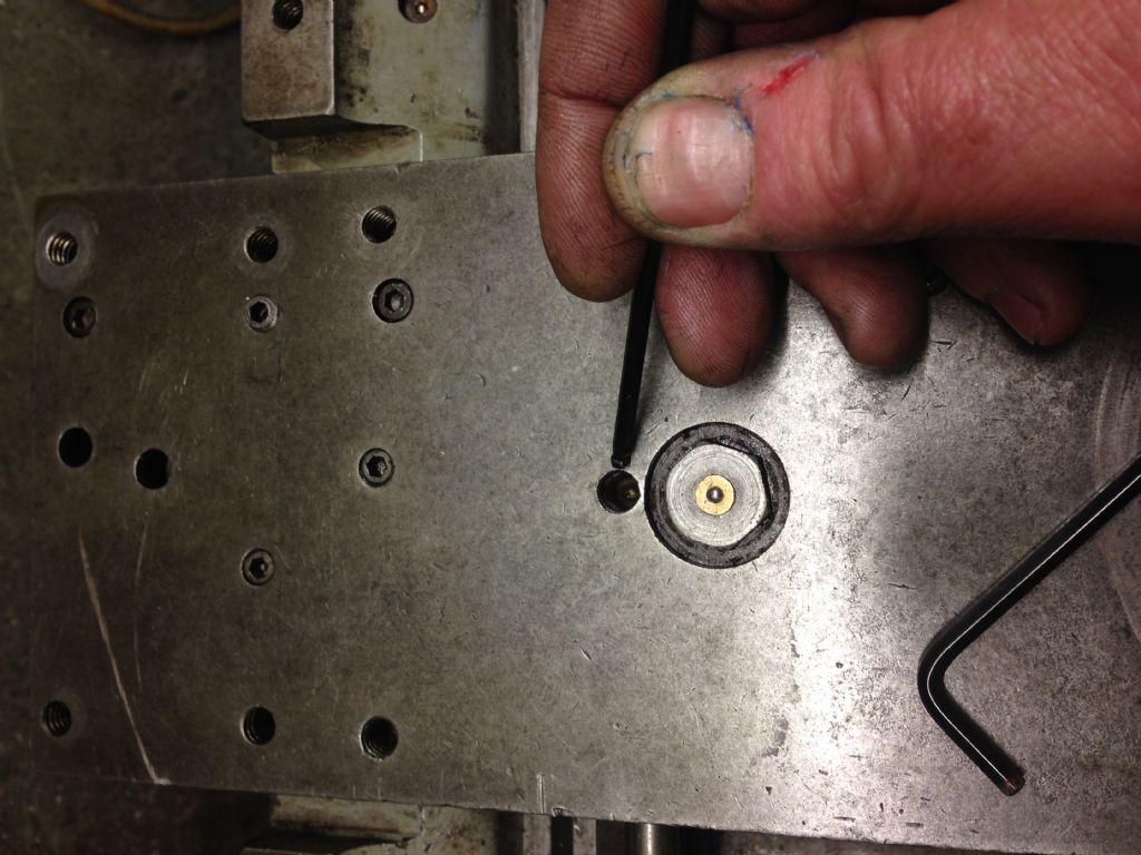

      Hi chaps I have a problem? I can hold the crossslide and move it backwards and forwards by hand, I would say in the 40thou department, I've had a look and there is a bit of play in the nut on the lead screw so I may have to make another one but does anyone know what the hole in the cross slide is for in the picture, it has a very small hole in the bottom for maybe a ball bearing but not sure, whatever should be in it is long gone, the hole is threaded by the way.
      Thanks Alan.
      I forgot to load the photo I'll add it in a mo.

            Hi Alan,
            Most lathes have some movement in the nuts of lead screw and cross-slide screws but this does not cause a problem because the nut is only loaded in one direction. 40thou in an old lathe is not uncommon. It is good practice to always back off the cross slide prior to moving it into the forward position for machining the part.
            Paul.

                Hi Alan
                My Bantam cross slide doesn't have the hole you are pointing to, nor does it have many of the others pictured, just those at the side for fitting the cross slide stops when using the rotary capstan limit function.
                Perhaps a previous owner has used it as a boring table and the screw holes were for holding a casting for boring/machining. Alternatively perhaps a tooling sub plate has been used to make the lathe more versatile.
                Emgee

                                Alan, no hole in my Bantam either, but maybe you could pop another oiler in it as it is over the lead screw, this will keep dirt out and oil on the screw. Could this hole have let c***p in the hole which wore out the lead screw nut?

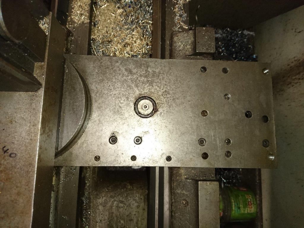

                                    Don't know if it helps, but here's a picture of the cross slide on my Bantam (Mk2) which has various holes in it but not the one you've picked out.
                                    Indication might be that the hole in question is an aftermarket feature?
                                    HTH Simon

                                      ..Thanks for the replays chaps this has been bending me head so to speak, I was at the girlfriends last night and when Watching the telly it suddenly dawned on me the there wasn't enough backlash in the dial to cause me such a problem, so I got back this morning changed and went in to shed of dreams as my son called it lit the heater and then had a look at the bantam, there is only 10 thou of back lash on the dial but you could grab the crossslid itself and move it back and fort at least 60 thou, I remember a long time ago that I looked at the nut that holds the dial on and though what's the small nut in the middle for ? Now I know, what a bast–d there I was thinking how much of a PITA it's going to be making a new nut for the lead screw and all it took was a five sixteenth spanner and away you go, parts of a treat again the only thing I can think of at some point it must have come loose, I ground a new parting blade to size to fit in the tool holder honed the end up and away I went it even parts of using the power feed now what a result, anyway thanks again for all the advice and kind offers of help, just need to scrape in the top slide now and then good to go .
