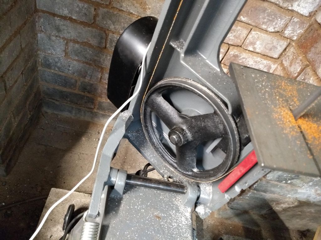

                                            Not a good weekend for mechanical saws!! So far, one Naerok blade break, one Hegner similar, one Axminster blade came off the wheels – fingers crossed, the trusty old Kennedy carries on regardless. The query is re. the Axminster – there appears to be a 'tyre' only on the drive wheel – is this correct? also, that 'tyre' is spongy, very loose fitting and appears to have absorbed cutting fluid (WD40 for ali). Any comments, please, from members who are familiar with the Axminster or similar 4.5" saws?

                                              That tyre is what drives the blade and prevents it slipping. Should not be using oil with that type of bandsaw I think.

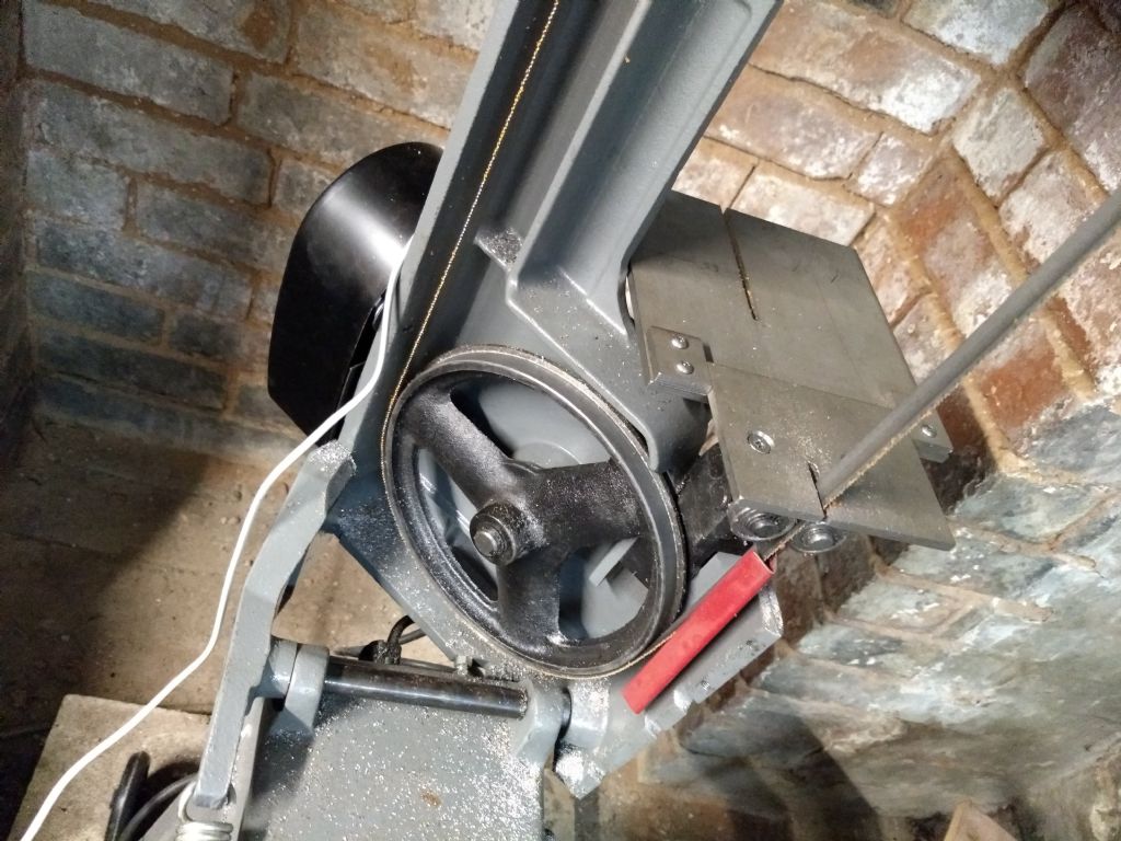

                                                I have the Axminster 4.5" – it's about 25 years old. Neither wheel has a tyre. Here's a couple of photos of the drive wheel – one with the vertical table in place and one with it folded away for horizontal sawing.

                                                    Just an update on my bandsaw problem (or one of them, at least!) I ordered a replacement for the Naerok from Trucut (as recommended). Slight delivery delay but now received and fitted and working well (fingers crossed!) Its other problem, the breakup of the 'tyres' was solved by utilising an old leather belt, slitting it lengthwise to correct width and glueing it in place with inch length scarf ing at the join. Used one of the modern 'glue everything' clear variety with cyano at the joins. There are SOME advantages to getting old and FAT!!
                                                    Now to deal with the Axminster – tyre or no tyre??
