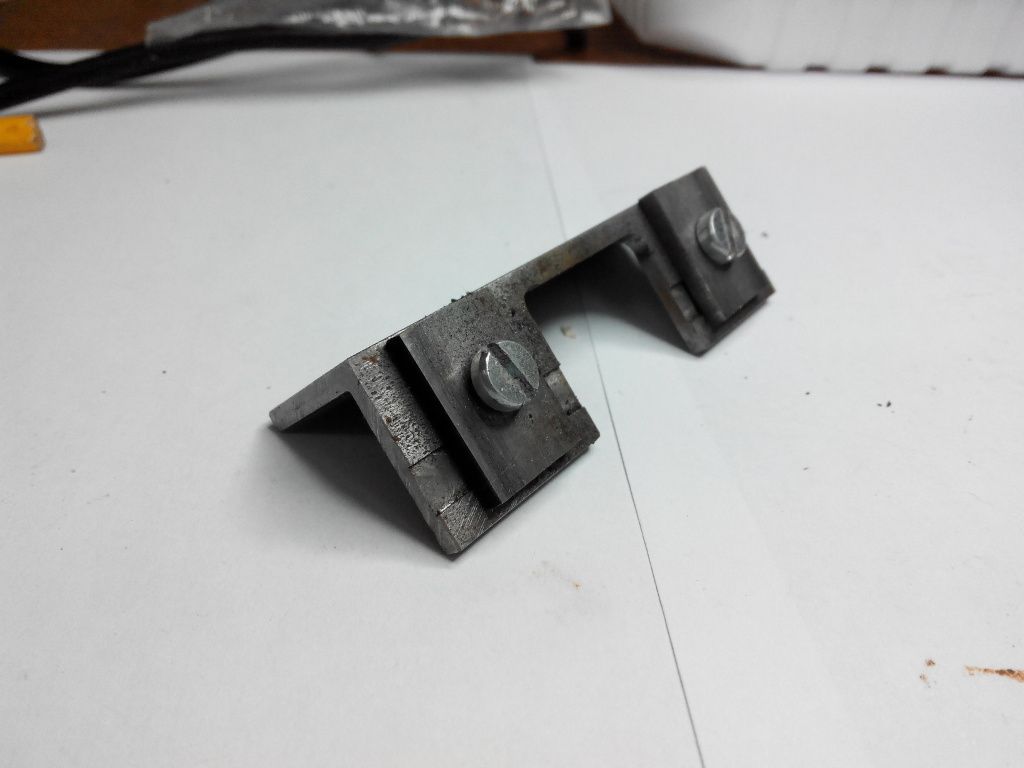

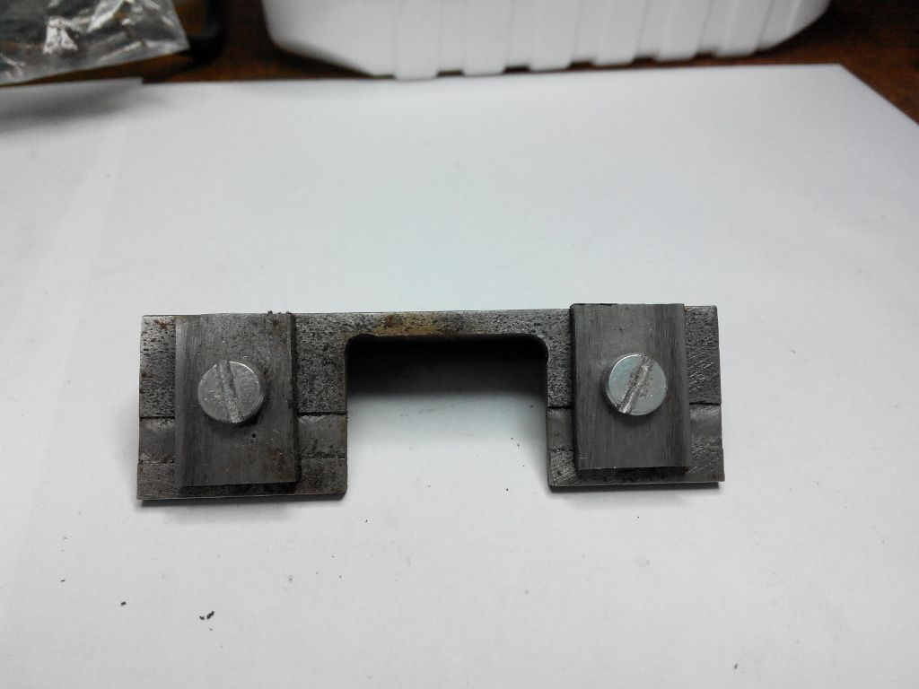

                                        Russell Eberhardt
                                          @russelleberhardt48058
                                          Here's the very crude jig I made over ten years ago. Used for silver soldering scarfed joints and, like Doug, never had a joint fail. I flux the joint, place a very small bit if silver solder o the top and heat from underneath so that the solder is wicked through.
                                          Russell

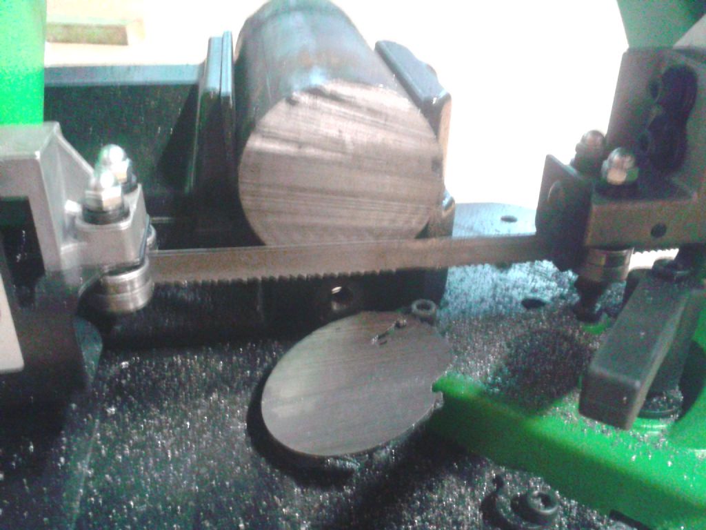

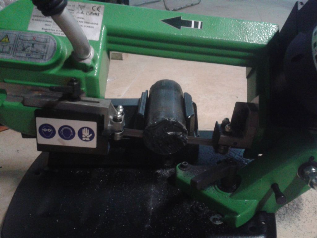

                                              ChrisB
                                                @chrisb35596
                                                As promised, I had a try TIG welding the blade, set at 20A I put a blob of metal and then filed it flat. First impression looks good. Gave it a test cut on a 2.5" dia round bar and cut it without any problems. So far so good…time will tell if it's a good repair or not, will still order a couple of blades just in case!
                                                #344642
