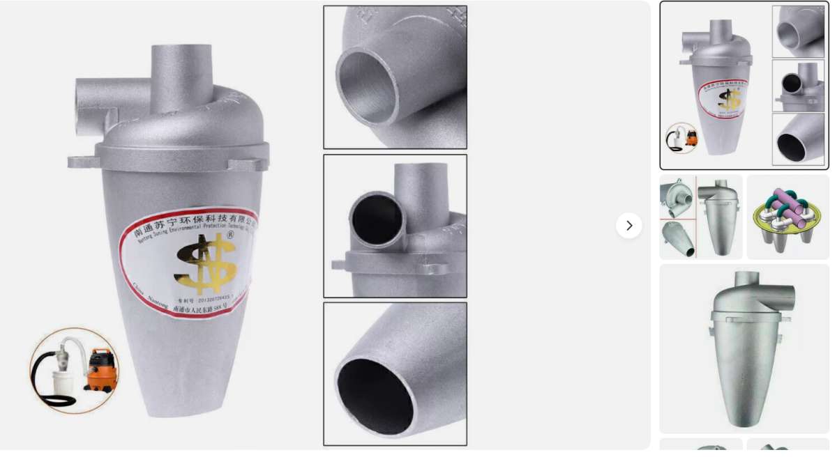

                    Previously I used an original Aquavac, but it was on its last legs.
                    However, I had it coupled up to my grit blasting cabinet to keep the air clear inside.
                    It’s a similar issue to ash as the waste dust is very fine, I use a coarse filter in the cabinet, essentially made of white Scotchbrite. It’s not an abrasive and designed as a coarse air filter in commercial air handling units.
                    To deal with the fine dust, I have a plastic tub, ex bird fat balls, with a clip on lid, which houses a vortex dust extractor. The fine dust gets dumped in the tub and the vacuum’s filter stays clean.
                    This is a photo grabbed from eBay, where is you search for “Cyclone Dust Collector” you should find several similar offerings. I’ve one of these cast metal ones and recessed it into the tub, rather than sitting on top as per this photo.
                    Maybe you could just use your current vacuum, and one of these as a pre-filter.

                            fully concur with peak4 buy a parkside vacuum and make yourself a cyclone collector. I have one in my workshop and one for work, the work one collects sawdust, MDF dust, brick dust etc. I haven’t changed the bag or the filters on my festool vac in 15 years just a quick clean every 6 months or so.
