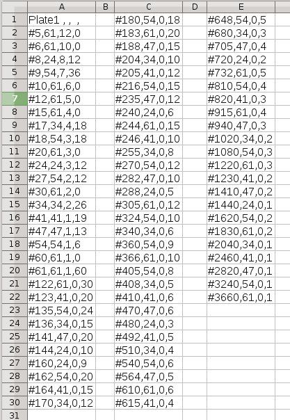

                                  I just had another hour or so on the macro. Much of it was down to OpenOffice not retaining things like cell (x,x) = what ever and I didn't really want to use their object orientated substitutes as feel that the don't belong in Basic. MS have added some too but less typing and they have retained the Basic way.
                                  It's a bit like working in sticky toffee. I can format the results in the spread sheet but I just want some tables so may just use it to write out a text file and then import into a word processor as it only takes minutes to format tables.
                                  The output shows why I am not keen on columns of divisions on the left and can can't do on the right. It only outputs what can be done.
                                  The #'s and , are for reformatting it in a word processor if I do it that way and it goes division, plate hole count, turns, holes. Looking at an export to a pdf it looks like I might get the results from 4 plates on one sheet so next bit will be to format the division, hole count, turns and holes into separate cells. On the other hand it would be much quicker to make a small change and just copy paste the result into a WP.

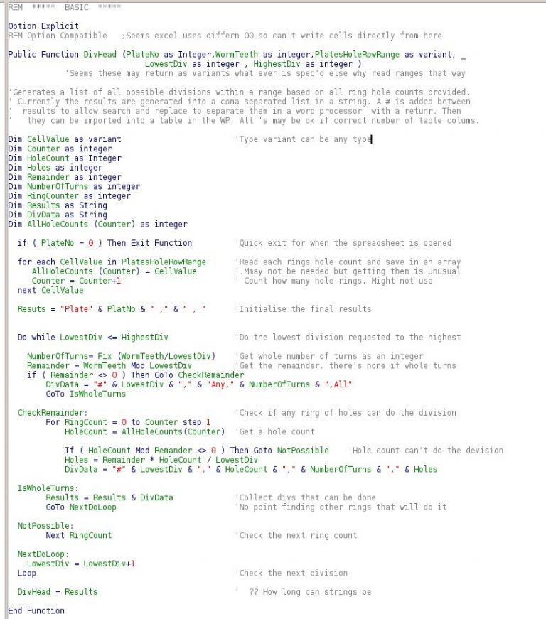

                                    Sorry to be late to the party but I have another variation on this theme. I have a program that works out how many complete turns plus how many holes in which ring on which plate you need to cut x number of teeth.
                                    It is written in python using tkinter for the GUI so should run on most systems. I am happy to make the code available and if there is sufficient interest I will give it a proper configuration screen (at the moment it defaults to my HV4 rotary table plates)

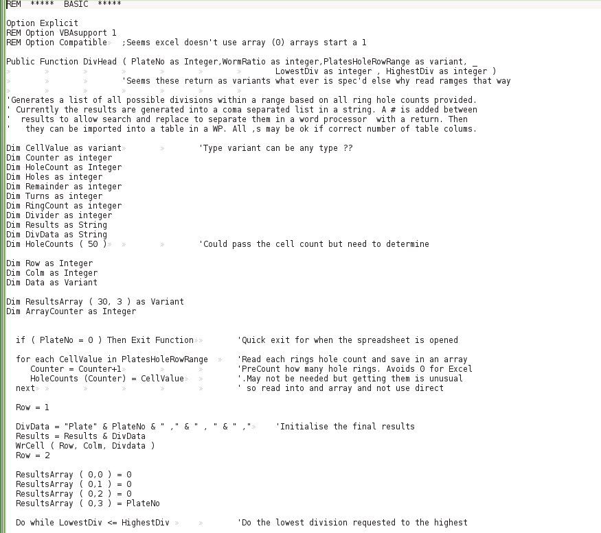

                                      I'd be interested Roger. Linux generally comes with Python or is easy to add. I'd expect Windows to be even more straight forwards. The only complication maybe that either Python 2 or 3 could be required. My Linux install does both. Both versions are on Python.org.
                                      I've spend a number of hours on LibreOffice Calc spreadsheet macro's written in Basic. Limited info about but plenty on Excel. What I found is that MS have retained things like Cell (x,y) = something or the other but Calc Basic hasn't. It needs a lot more typing and the functions look rather intimidating. The documentation is extensive but for a casual user probably far to much to remember. I did find one decent page eventually that shows some use of it rather well but as far as I am aware it's the only one.
                                      **LINK**
                                      As I periodically try and do things on spreadsheets and find that the normal spreadsheet functions wont do what I want I intend to write some macro's so that I can have things like ReadCell (x,y), ReadRange (x,y) and same for write. A few others will be needed as well. A memory aid should fit easily on a single A4 sheet.
                                      blush Seems MS has done the right things for once. Left the Basic like stuff in Excel macro's in Visual Basic. They have also added the other type too. The OS people seem to have just done that and screw casual users. Macro's can also be written in C or Python. This way I suspect that exactly the same core of code is used on all of them.
                                      If some one is used to using VB there is an option to make xxxxxOffice macro's compatible. Just add
                                      Option VBAsuport 1
                                      to the top of the file. Not sure how well this works and have now learned xxxxOffice Basic syntax so not keen to find out. It would mean more web crawling. I've already done to much and I doubt if compatibility is complete.

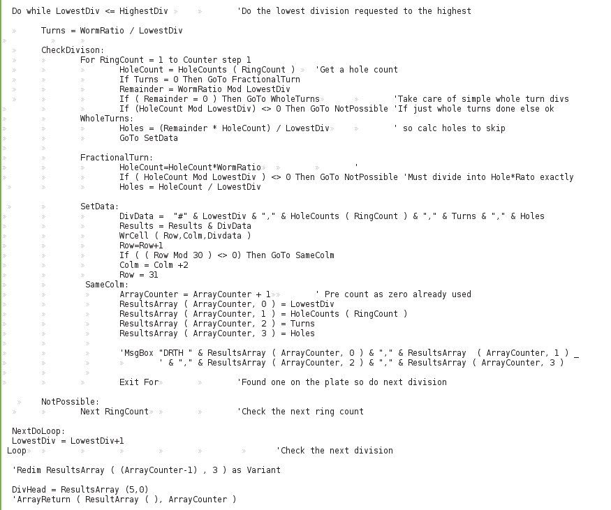

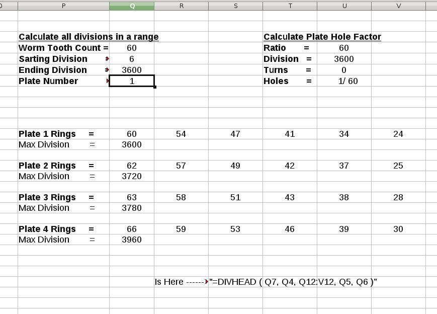

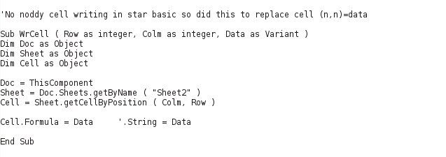

                                          I doubt if anyone is interested but this so far is my way of doing ir. In Basic there is no need usually to declare variables and there will be some I could do without. It's all done in integer. One point on that – on the Turns = line it would be better to use QUOTIENT or FIX if decimal was being used. FIX in one Basic I have seen rounds up though rather than down so best check. I'm saving the results in a string array ( aka Text ) format and as an integer array at the moment. There are some bugs in my LibreOffice that prevents arrays from working as they should when the function has finished running.
                                          The sheet looks like this at the moment but more to be done. It'll probably be activated with a button.
                                          Top left is the spread sheet way of getting a factor for any division. The function call is in quotes 'cause I kept having to delete it when playing with the integer array.
                                          This is the sort of thing needed in a macro to avoid having to use xxxxOffice's Basic functions. .Formulae could be .Integer, string and etc
                                          Variant seems to mean any type so could be that as well but it may not convert to what ever it is automatically.
                                          Several photo's as Neil's size limits are miserable. The code ones are in order.
                                          Edit smiley Yes I do know I could bury things in nested if then else's and do without some variables but I wanted to leave it clear. Turns out it has a case statement as well but syntax is missing from the doc's.

                                                  It works for me Roger. I had to install python3-tk to get the TK graphics extension. I wondered initially and then realised I hand't changed the worm wheel to 60 !
                                                  angryWhile messing around checking mine I noticed a problem with number of turns. It looks like integer division rounds either up or down based on x.5 or maybe even bankers rounding. Turns are worked out correctly at times but some come out 1 higher than they should. Easy to fix by using multiply and decing if the results comes out high. It doesn't have quotient. Looking at some of the integer functions they return double. Too much trouble to do it properly. So much for Option Explicit. There can't be any actual type checking at all at this level.
                                                  I've come across this sort of thing before. I did do a bit of commercial work for a while. Ugggg. One of the jobs was time sheets processing. The compiler I used stated "works at any base in integer so that there are no rounding errors". So did it in base 60. Eventually some one decided to tot up all the numbers by hand and found that there were minor errors. There is always some one like that around. If the compiler did really use integer calcs there wouldn't be any discrepancies at all. Binary is integer so there is no reason why there should be. They must have been using float under the hood. I made sure only integer went in. Have to on this sort of job as people might put in any old thing including function keys and control this and that or anything else they can think of or do by accident.

                                                      No problem with yours Roger. I'm using it on Linux under KDE4. I've only put a few through it but all have been fine.
                                                      The problem is my speadsheet and Libre Office Basic. Not an ideal place for this sort of thing but I thought it's worth getting to grips with how as when I have used them before I have been hampered by only having the spreadsheet functions available.
                                                      Floating the two that are causing the problem and then truncating them should work for me. It's only causing a problem when I calculate turns as I need to divide. They are declared as integer. The rest of the logic uses Mod which does do what it should.. I think I will use Ask OpenOffice to see if there is some undocumented compiler option. I expected integer divisions to truncate as no Quotient provided. That way along with mod fraction type work can be done easily and exactly. I don't know. Looks like compiler writer are getting lazy.
