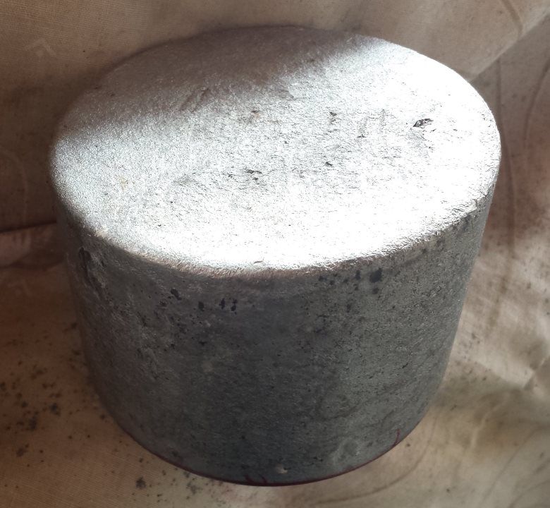

      I melted some aluminium down and the excess got poured into a can. It shrank enough to enable me to get it out and i have a round slug approx 80mm diameter and 50mm tall.
      Nice simple project to make using a lathe? Possibly the mill when i get it. Maybe a few weeks away yet though. A few bills to pay before i fully decide on which one. (unless there are bargains at the Doncaster show)?
      Suggestions for a simple project where accuracy is optional and additional parts are minimal.
      2109 Lathe, small drill press, 4×6 bandsaw and a few other bits. Never soldered but i do have various gas torches. I also have a 3D printer.
      Suggestions please.. (not rude ones, the missus has already suggested a use for it)

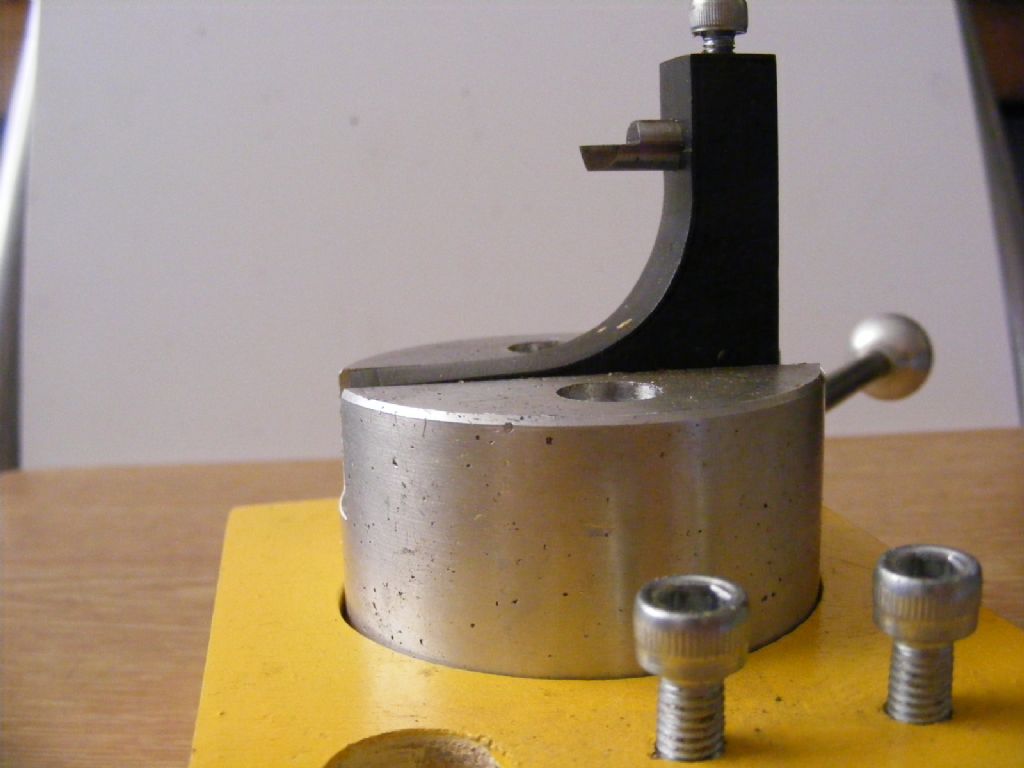

              I made my first ball turner with just such a piece, see:
              I have since made two other ball turners and the first one , shown above, I gave to someone in the USA.
              Mike

                    Dave, the toolholder was made from 12 mm x 50mm steel bar crudely cut to shape by chain drilling and then filing.
                    The 6 mm hole for the tool was drilled using a drill in the lathe chuck once the toolholder was champed to the base. This ensure that the hole is on the lathe axis.
                    The tool was a piece of 6 mm silver steel shaped with a file and then hardened and tempered.
                    Cutting the slot in the aluminium base was achieve by mounting the the base on an angle plate attached to the cross slide and then milling the slot using a 12 mm end mill.
                    Lost foam casting does produce a small amount of smoke and flame when the aluminium is poured. However, the amount of smoke and flame is small. Most of the polystyrene melts and goes into the sand and does not burn. I think it would pose little nuisance to neighbours.
                    I hope this information is useful.

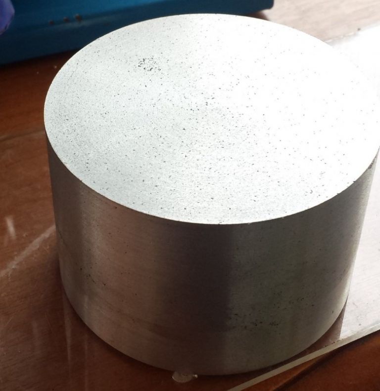

                      Just had a closer look at yours and expected mine to have all those pock marks in the casting but after just a small skim to get it all fairly true, most of them have gone. How do you get a cleaner casting without those marks?
                      I do not remember using any flux or degassing so maybe there is the answer?
                      I have a small corner garden with 3 properties bordering it. May have to have a test on how much smoke/fumes it produces. Someone mentioned using PLA plastic to do a similar job, not seen much info on that though.

                        Dave, I have just uploaded some more pictures of the ball turner to my album "Ball Turner".
                        The slot is not angled. As stated earlier the hole was drilled with the toolholder clamped in base block. This ensures that the ball is exactly on centre. The tool is filed to half diameter. This puts the tool just on centre. The tool is held in the tool holder with an M4 screw. On one of the pictures you can see the screws in the base that clamp the toolholder in the slot.
                        Regarding the pock marks, I have to say that I made this very shortly after I started aluminium casting. The aluminium was melted, skimmed and poured. Nowadays, I would add "Low Salt" as a flux, stir, and then carefully skim the dross before pouring. This gives much cleaner castings.

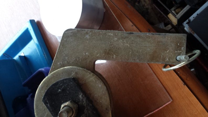

                            Uploaded a couple of pictures myself (slug) and i think i have found a suitable toolholder, the bracket from a caravan stabiliser. 12.5mm thick.
                            Before
                            After
                            Toolholder?
                            Apologies if the picture are messed up. My first attempt at pictures on here.
