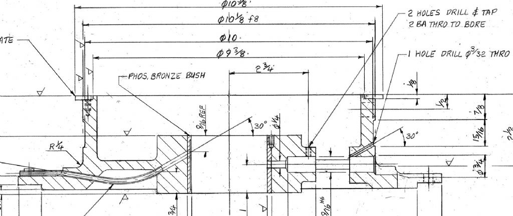

              Focusing on question 2, and specifically the Bill Hughes Allchin design, I would greatly like to hear from anyone who has built and runs one of these engines and to find out how they lubricate the differential pinions (aka compensating center).
              The drawings show oil holes for the pinion shafts, these appear to be lubricated through the two driving pin holes in the wheel hub. However I can see no way of getting oil to the pinion gears themselves short of blindly squirting it into the gap between the winding drum and the toothed driving plate.
              Any help is greatly appreciated.

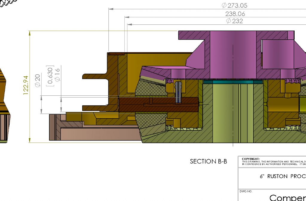

                Hi Steve,
                The compensating centre should be lubricated and as stated above, oil will run thru and would need regular application which is how the drip lubricators work and grease + dust makes a grinding paste. However the diff gears on the full size traction engine which I drive uses grease. Built in 1926 and travels hundreds of miles each year and still going strong, often on dirt roads.
                The drawings for my Ruston show holes in the casting for oiling the pinion shaft (from oil which is in the cavity behind the winding drum) the and a pipe for transferring oil to the axle. (someone on the TractionTalk web site may have a better answer for your Alchin)
                I have modified the design, replacing the screw which locks the pinion gear shaft with a long grease nipple. This now lubricates the gears and axle from a common point while locking the shaft.
                Edited By Paul Lousick on 10/10/2016 23:47:42
