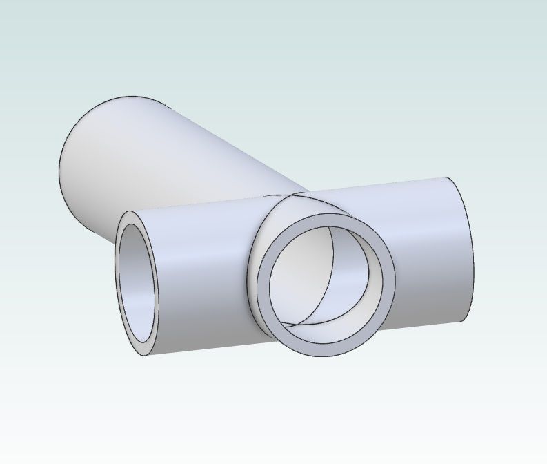

              John Hinkley
                @johnhinkley26699
                Lee,

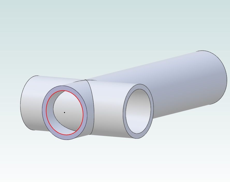

                I suppose it all depends on what you are trying to achieve. For example two crossing tubes:
                Clearly, they "block" each other off. However, select one end of each tube in turn and create a sketch on each end with the circle the inner diameter in red below and extrude cut that all through.
                And you end up with the cruciform as shown below.
                I have, perhaps, not chosen the best size combination to illustrate my point, but you get the idea. As Ady1 says, there's usually a workaround.

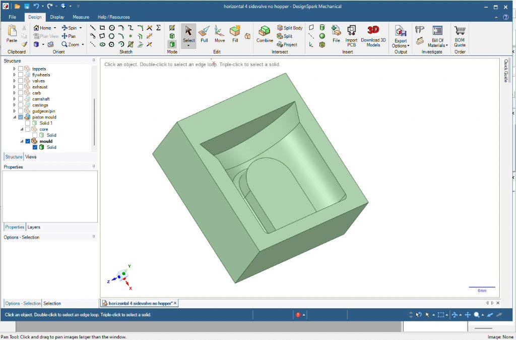

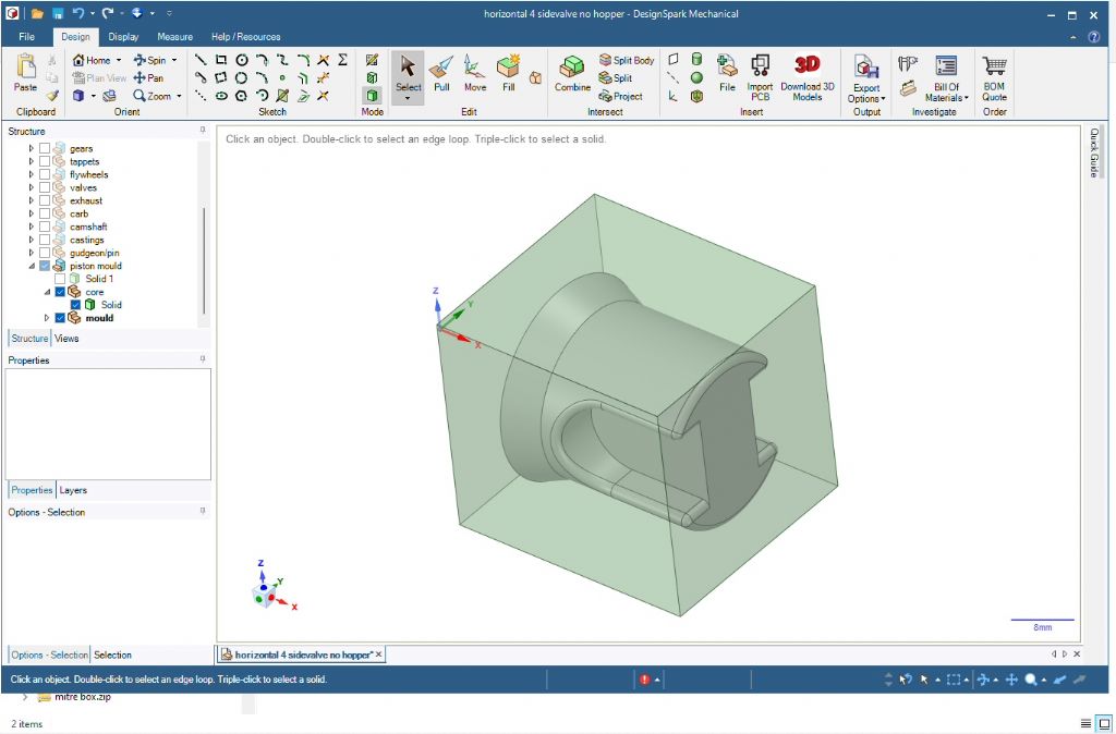

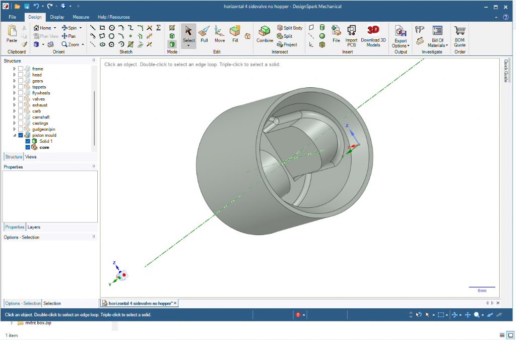

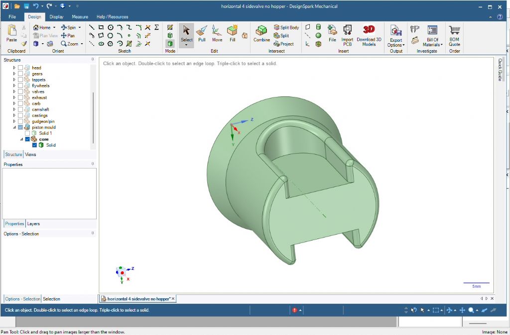

                      This is an example of my method of making a core box, or core mould.
                      I want to make a core mould for this piston. The piston is grey because it is inactive.
                      I create a group called "piston mould" and in that group a body called "core". I select the end of the piston and start a new sketch. I use project to sketch to create a circle the dia of the inside of the piston, and then extrude that sketch to the other end of the piston to create a cylinder. I then cut the piston body from the cylinder to get the core. The piston body isn't destroyed! The chamfer isn't something I would cast in the piston, I would delete it from the piston body before cutting.
                      The core is green because it is the active body.
                      I then create another body called "mould". I've made it transparent to make the core visible.
                      The core is then cut from the mould, and the mould split into two.
                      I can then add locating pins and flanges for bolts to the core mould and then use it to create a sand core.
                      I use this method to make most of my core moulds unless they are very simple.
                      The above process took about 5 minutes.

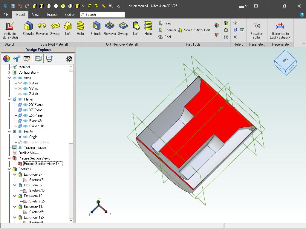

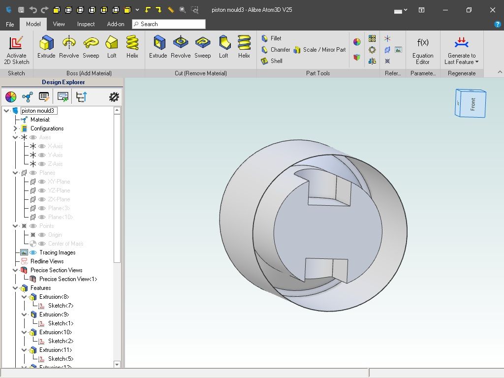

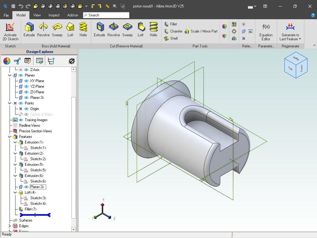

                                    The Alibre Atom route I found was you need the original part so I built the piston
                                    They have a function called shell so I hollowed it out to 0.1mm
                                    Then I filled in the original piston body space and this is the half section which can be mounted into a bounding box. Took me slightly longer than 5 minutes though lol
                                    No doubt things would improve with more practice
                                    Edited By Ady1 on 12/05/2023 03:36:16

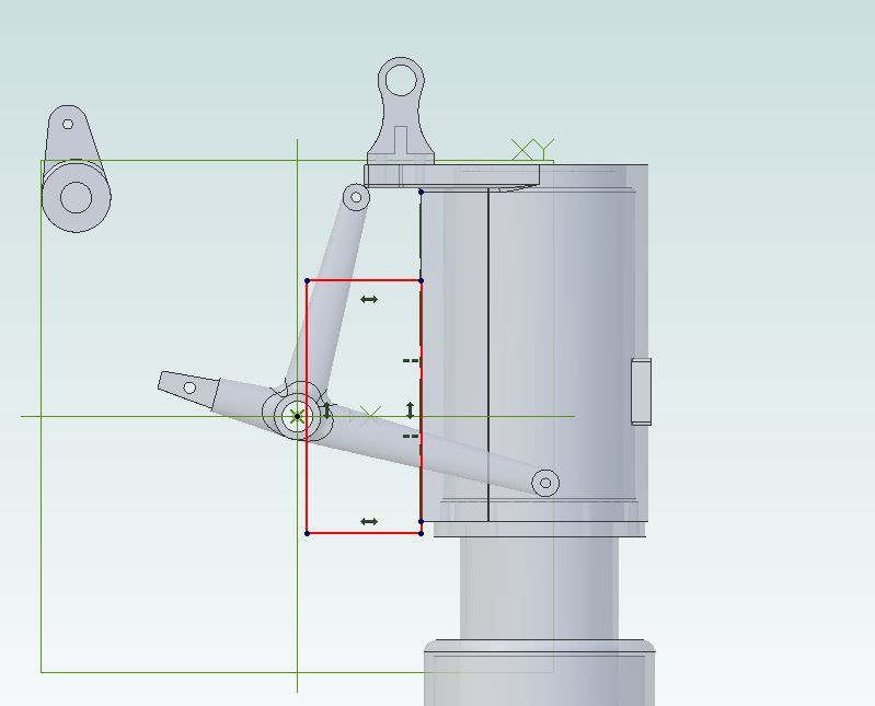

                                                    The way I split something in half when doing a pattern is much like I showed at the end of the video of your core box. Simply sketch a rectangle with one side through where you want to split the pattern and cut away one half, name it pattern right, go back and edit so the rectangle sits the other side of ctr and name that pattern left.
                                                    As for constructing a part using refs from another part or assembly when you have your assembly up on the screen click add new part rather than insert design. You can then draw directly over the assembled parts and use project to sketch to pick up any refs you want. I'm assuming this can be done in atom, I can do it in pro.
                                                    Example here, drawing the rectangle and have used the vertical edge of the cylinder as my ref (green broken line)
