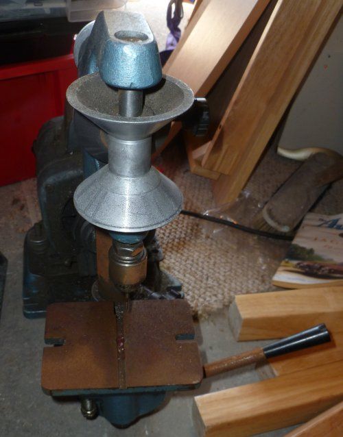

            David Clark 13
              @davidclark13
              Hi There
              There is an easy way to reverse a tapping machine.
              It is a rubber cone drive between metal cones.
              When you press the table up, the tap goes forward.
              When you lower the table, the tap goes in reverse.
              You can also use two flat plates instead of the tapered cones and it will also work horizontally.
              regards David
