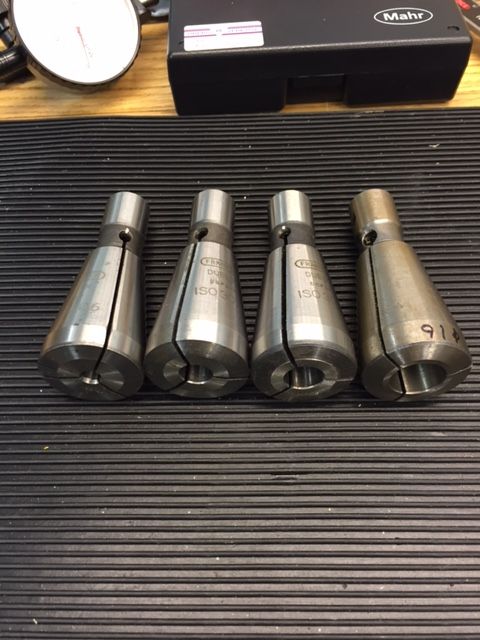

                Arnljot Seem
                  @arnljotseem72268
                  Thanks for the great response to my question. This really is a helpful community.
                  I just wanted to share a picture of the direct-collets for the ISO30 taper that came with the mill. The great advantage with these is the ease of use, rigidity, and extra headroom. Sometimes however, it is an advantage with some distance between the spindle and the work piece, so that is when the ER holder comes in handy.
                  These direct collets go on ebay for close to €50 a piece, so rather expensive. Fortunately, I have 6,10, 12 and 16mm, so I really only need an 8 and a 20 to cover my immediate needs.
                  Thanks for all the help. I'll let you know how things work with the new collet holder next week.
                  Edited By Arnljot Seem on 01/09/2016 20:30:45

                      #253730
                      Ian P
                        @ianp
                        Posted by Arnljot Seem on 01/09/2016 20:29:51:
                        I have not seen that type of collet before but I can see its eminently suitable it is for toolholding close to the spindle bearings etc.
                        I'm curious though about the design reasoning why it has only three slits. I thought two cuts across the diameter would be simpler/cheaper from the manufacturing point of view, but would it grip any better with four tines?
                        Because there is so much metal in each tine the slit has to be extended to the thinner part of the collet so it has a chance of flexing. As the curved bore of each tine is not going to flex or conform in any meaningful way to the cutter shank, the cutter diameter has to be spot on. Cutter shanks are usually very accurate so its not a problem but it seems to me that one sawcut and two tines would work just as well.
                        I have no real reason for asking this question other than idle curiosity.
                        Ian P (Love the Schaublin mill!)
                        #253759
                        Roger Head
                          @rogerhead16992
                          Posted by Ian Phillips on 02/09/2016 21:00:13:
                          I'm sure someone will write a full-page response to this, but the answer(s) are simple.
                          1. A simple diametrical slit will only provide a two-point grip of the cutter, hence no positive location of the cutter axis. (An infinite number of circles can pass through two points, only one can pass through three.)
                          2. This type of collet is only intended to grip one specific diameter cutter. Trying to hold something that is even just a few thou larger or smaller is exceeding the design parameters. As you will have observed, the design of wide-range collets (e.g. ER-series) is dramatically different.
                          {edit} Just re-read your post Ian, sorry, point (2) isn't relevant to your question. However, point (1) is, especially when chasing accuracies at the tenth-of-a-thou level.
                          Roger
                          Edited By Roger Head on 03/09/2016 02:08:05

                            #253772
                              Posted by Ajohnw on 03/09/2016 07:48:49:
                              It's interesting to compare the cost with R8's and ask just what do these offer over them.
                              They fit machines with int 30 spindleswink
                              Appart from that they offer all the afvantages of any other finger collet
                              – more likely to be concentric as there are less surfaces between spindle taper and tool
                              – Less protrusion so more rigid and allows larger work/longer tooling to fit in the space available.
                              Ian I was surprised you were curious about 3 slots when all other finget type collets like R8 and MT have 3 slots as well as 5C etc, I would have been more curious if they differed from the norm and only had two slots
                              #253776
                              John Haine
                                @johnhaine32865
                                Ian said 2 cuts across the diameter, which will make 4 tines.  (Oops, no, just re-read, sorry)
                                I have made an Int30 taper on my CNC'd Super 7 to fit my Novamill (though not made into a collet). If you have access to a CNC lathe I'd be happy to supply the Gcode. I must say I'd like some of those direct collets so may have a go at making some!  I'd make 2 saw cuts at 90 degrees to get 4 fingers.
                                Edited By John Haine on 03/09/2016 08:49:28
                                #253779
                                  Posted by John Haine on 03/09/2016 08:43:58:
                                  … I'd make 2 saw cuts at 90 degrees to get 4 fingers.
                                  John,
                                  May I suggest that you read-up on 'Kinematics' before making your final decision.
                                  There is always a tendency for things to settle at three-point contact; so it's often better to just accept the fact, and design your device accordingly.
