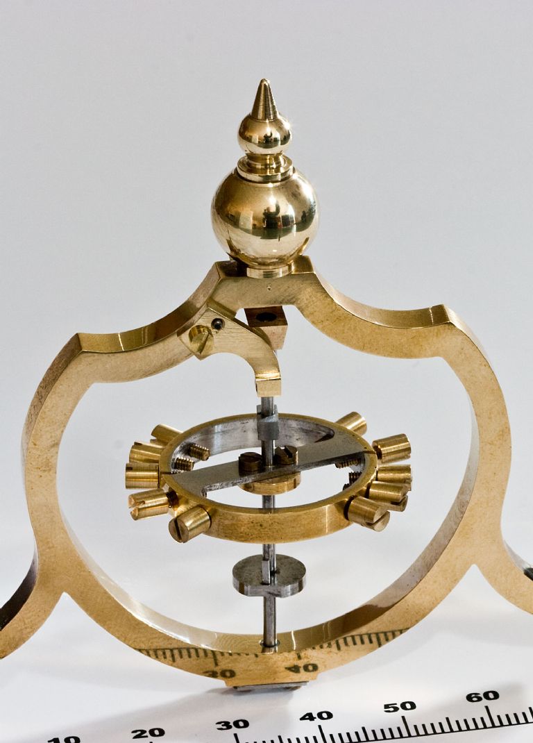

        Inexplicably overstepping the thread character limit, I was obliged to split my last offering.
        In answer to your suggestion John H, that … the designer might have started with the balance and designed the train to suit?… this did pass through my mind on occasions. In Part 1 of the five-part Model Engineer article he abandons the idea of using platform escapements as looking like an afterthought rather than an integral part of the design.
        Mr Stevens appears to have based his escapement design along lines similar to already established principles of escapement. On Page 268 in the third edition of Model Engineer (17 March 1972. Vol 138, issue 3437), he refers to methods in the late W.J.Gazeley’s book …“Watch and Clock Making and Repairing”.
        Whether he developed his own set of balance wheel and balance spring details is unclear. I imagine he would have to. He certainly chose to use flat-section spring wire for the balance spring, whereas I switched to round-section wire, driving myself into a gloomy backwater and many failed attempts at producing a suitable (just passable) balance spring.
        In contrast, the (bimetallic) balance wheel design provides timing screws around its periphery.
        The Cage
        Despite the bimetallic facility however, I have never tried to adjust the beat for variations in temperature. There were other imperfections that I wasn’t willing to fix; for example, the fusee/main spring calibration, versus the sensitivity to power variations of the English Lever Escapement.
        More to come,
        Sam

          This thread has invited a useful selection of entertaining comment. I trust others have been similarly amused. Thanks Michael for your watchful eye on detail, and your attention to the motion ratio aspect Bazyle.
          On that score, it’s possible that he thought the design less cluttered when Mr Stevens was considering the motion’s 12:1 ratio. Instead, and with minimal stress to contend with (thanks for your input there John), he used a wheel with 72 teeth meshing with a 6-tooth pinion, the only solid pinion in the clock. However, this choice shoved the smallest of the pinions over to the side, thus requiring a 1:1 pair of wheels to bring the movement back to centre.
          Dave’s chosen description of a clock and its variants while delving into the depths of atomic clocks and GPS was quite unexpected. Thanks for that Dave.
          We’ll probably never know whether Mr Stevens started with a known (oscillator) source of timing, e.g. a variant of a platform escapement, or the alternative … a fixed stack of crossed out wheels and lantern pinions, each identified according to traditional terminology.
          If the former, then I would imagine (as Neil suggests), he may have experimented with varying sizes of balance wheel or, as is quite feasible, calculated variants of the wheel’s 2nd moment of area. In the original article, brass was the material specified for the balance wheel. Whereas, having read somewhere (Gazeley’s book, perhaps) I digressed making the rim bimetallic (brass on steel). As I recall, the suggestion was 2/3 brass fused onto 1/3 steel. By the time I was into about the fifth attempt, having produced one without clearly visible blowholes in the brass, it was nearer 45/55.
          Alongside this, he may instead have chosen to calculate the section properties of the wire, in particular the MI (moment of inertia). Classified in Wikipedia as a chronometer helix … **LINK**, the spring was supposed to be of flat section wire, giving the spring substantially greater stiffness in the vertical direction. Ideally, it would appear to ‘breath’, whereas my switch to round wire stood little chance. Wobble would be a better description.
          In hindsight, it appears to matter little if the beat is 0.89266667 secs or 1.00000000 sec so long as we have the time (to wonder).
          Sam

                              Bazyle, I think you may have cracked it!
                              Here’s what happened in a similar vein when I was making the wheels of Mr Stevens’ clock.
                              My second hand ML7, bought in about ’65, came with a dividing head and three indexing plates.
                              The design for both the great and the maintaining had 96 teeth. I set up the 40:1 homemade dividing attachment selecting the appropriately drilled index plate. As with the other gears, I used a single-toothed fly cutter made from hardened silver steel. All seemed to be going well until I decided to check that the result was correct by dropping into the first groove I had cut.
                              To my dismay, that didn’t happen.
                              Instead, the first tooth began to disappear as the cutter traversed the edge of the wheel. It was too late to do anything but start all over, but not until I had discovered the source of my error. Either I had miss counted the number of holes during indexing, or I had made a mistake in the arithmetic. Then I discovered that I didn’t have the correct number of holes in the index plate either, so I ended up machining a new wheel with 94 teeth.
                              The Great & Maintaining Wheels
                              It was fortunate too, that `give or take a couple’, the number of teeth on the great wheel is not critical in the actual operation of the clock providing that the depth of engagement is taken into consideration. They simply transmit power to the gear train. The only real damage was to my ego.
                              It is now clear (if you know what you are doing), that the rest of the ‘going train’ wheels don’t have to conform exactly to the number of teeth specified.
                              Thanks Bazyle!
