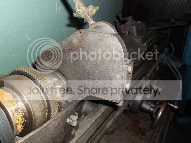

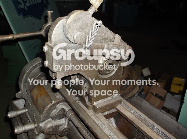

Seen on an ad for an old South Bend lathe. Not so much a rear parting tool as an overhead parting tool. The ad calls it a cut-off tool, although it looks like it puts a good bevel on in the process. It apparntly works by pulling on the handle at the top (almost out of the pic) and the eccentric cam action would give quite a nice firm tool delivery but with good "feel".
I wonder if used with a conventional parting blade could it have an application in the home workshop? I wonder how a cross slide mounted version might work? Quick action, or quick disaster?
An intriguing bit of kit, nonetheless. Looks to be shop made, on a production/capstan version of the 10 k SB. Certainly food for thought.
