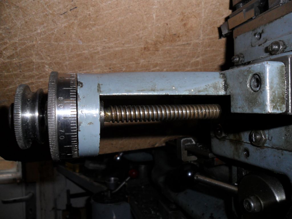

                Hi Alan
                I made myself a set of zeroing dials for my ML7 and my vertical slide.
                I am no expert, but I found it quite easy to come up with a design and to make them myself. the only testing part is marking the graduation around the side, but with a little bit of enginuity I managed this using a 100 tooth changewheel and a homemade locating spigot attached to the lathe.
                There is a photo in my album, and if you would like any more details pm me and I will try to help you out
                Regards
                Colin
                #81432
                Alan Worland 1
                  @alanworland1
                  Colin, thats a nice dial you have made there, food for thought!
                  Alan

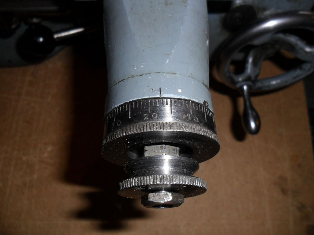

                    #81515
                    Nobby
                      @nobby
                      Hi Guys
                      This adjustable dial I made for my S7 Mk & bracket etc .
                      Regards Nobby
