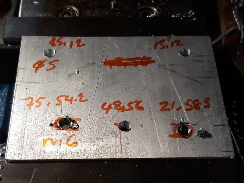

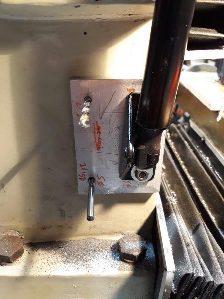

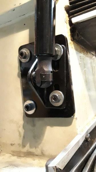

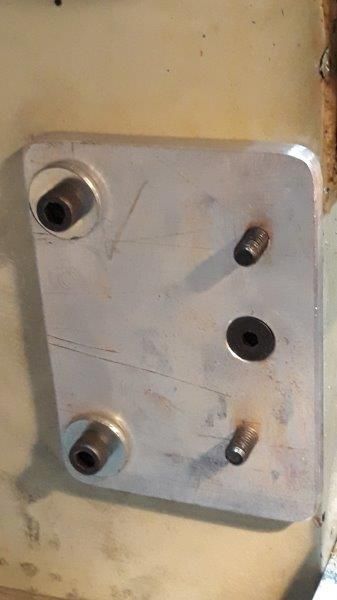

      So I added a 850N Gas strut to the left hand side of the X45 clone Z axis to make it easier to wind the head up and down.
      Made a couple of brackets to attach the end of the strut. The Strut is just one from an Auto parts store. It is 10mm shaft and 765 mm long with a 480 mm compressed length. So is 285mm max stroke. I set the strut when the top of the casting was 10mm above column . Max I could easily wind the head to.
      When I made the plates to hold the strut ends, I drilled the holes 5mm the tapping diameter of the M6 for the casting. Then used the plate as a pattern to drill and then tap the casting. Later drilled to 6mm on the drill press. To hold the strut, I tapped M6 and counter sunk the holes for the M6 screws to be flush on the under side of the plate. These were done up tight to create a stud for the strut to be attached to.

          I just checked the spindle to table max height, and it is at the max the manual says it should be. So I am happy that I have not lost any height in the addition of the strut. It is no issue to wind up and down the head assembly now. It used to be a lothesome job by hand. May get all enthusiastic and add an electrical power feed to it next.

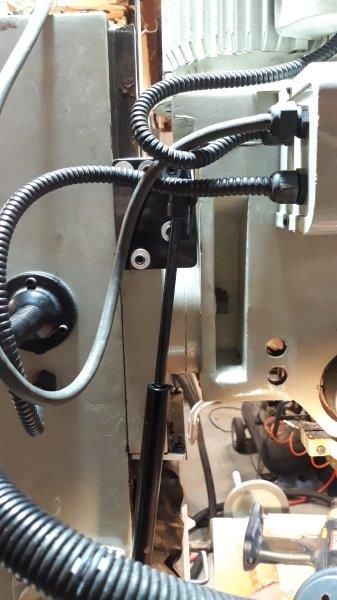

                Good idea but i havent any room to do that on mine. Cables and Z axis dro in the way.
                Its been 9 years since the transfer box broke on Super Lux and not paying £244 back then for the privilege minus motor.

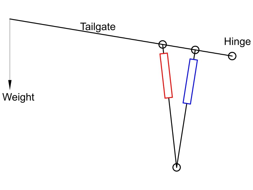

                    Posted by Simon Williams 3 on 22/04/2019 17:05:10:
                    I don't understand the force indicated on what I take to be the plastic wrapping for the strut in Nm? Am I missing something?
                    Rgds Simon
                    Offered as a suggestion!
                    I think the force needed to operate the strut is given as a torque measurement because they're most commonly sold to support car tail-gates or boot lids.
                    The diagram shows a tail-gate applying a weight to a gas strut. More force would be applied to a strut mounted in the blue position than one mounted in the red position. So choosing the right strut depends on the weight of the tailgate and the struts position along its length. As the tail-gate is hinged, a turning force is applied to the strut and, like a torque wrench, it's expressed in Newton metres.
                    I won't attempt the maths needed to translate 850Nm torque into the equivalent weight of an up down milling head. My maths is terrible at the best of times and I've got hay fever. 85 Newtons is roughly 85kgf, or 190lbf.

                      SOD – Dave – thanks for the explanation, but it still doesn't wash. There is no torque applied to the strut, only a force acting to compress it. The strut of course provides a force reaction to this compression; the magnitude of this force can be measured in Newtons, lbf, Kg (wrongly, but at least it's understood), poundals (if we must) etc. etc. All are dimensions of force, not torque.
                      Maybe it's just a typo. (Occam's razor!)
                      Thanks as always

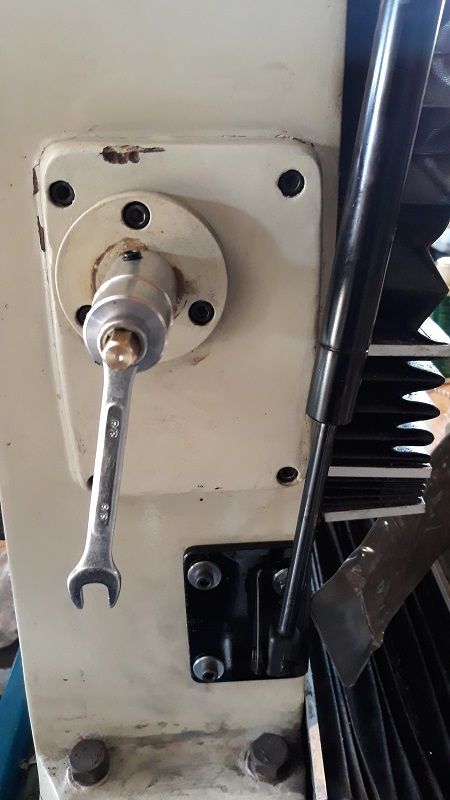

                              Some struts are adjustable in their pressure, and have a pressure bleed off screw at the fixed end of the cylinder. It is about a M3 or M4 set screw.
                              I changed mine around and now have it correctly mounted. Also made 3/8 hex adapter to use with my battery drill or the 3/8 ring spanner. No need for the really long handle that can sometimes get in the way when the table is close to the column.

                                    I use a length of thin walled plastic tube over the strut on my benchtop CNC mill, it's just a bit longer than the rod and is a sliding fit over the housing so it drops into position to keep the strut clean but can easily be lifted to check everything is still spotless underneath.
