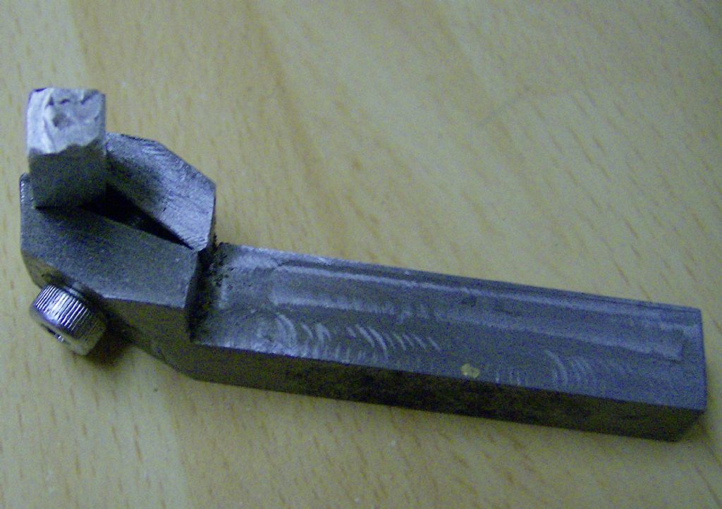

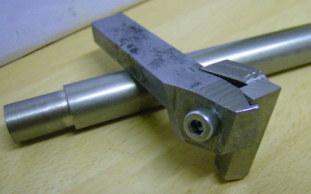

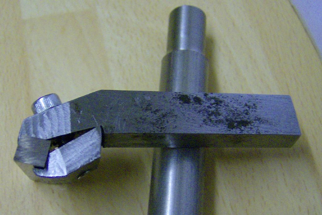

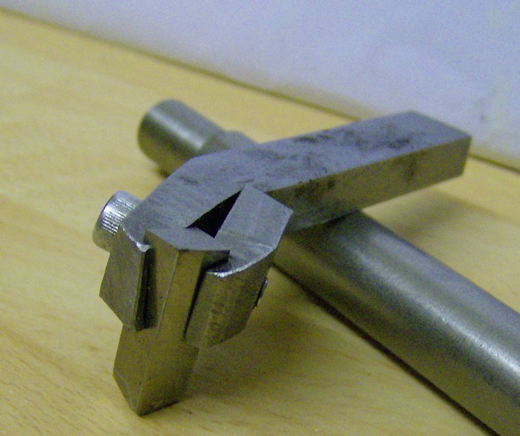

      After some thought and a frustrated attempt at making a tangential holder, I realised I could make one froma much smaller (1/2″ square) bar, as long as I didn’t mind angling the holder a little when cutting to a shoulder. Lot’s of brain ache in setting the angles (I used simple angle vice, set slightly skew-whiff to the X-axis of the mill and clamped the work at an angle to get a third degree of freedom. All done by eye! The cutter takes 1/4″ square HSS and took 1/16″ cuts in nasty stainless, giving a good finish with 4-thou feedrate. For size the clamp bolt is M4, cutter height is 5/16″ to suit my mini lathe.
      I need to file down the end of the clamp a bit more to give better clearance when facing – I realise I don’t need such a big lip to secure the bit anyway. So here are the pics:
      No drawings yet, but I could do some.

          Good show Neil,
          Welcome to the Tangential Tool Owners Club.
          Proper clamps look so much better than the original (well if not original, shall we say the latest round of interest over the last few years) designs from USA using just a screw.
          I have one general question, why is it that everybody who has one of these tools loves them but they are still not more widely known? When I used demonstrate them at MEX and Ally-Pally loads of people have come up and asked for details because they have never seen them before, little realizing that the idea is at least 130 years old. Perhaps some folks are just slow learners?

                I thinned down the end of the tool to 1/32″ and took a skim from the back of the clamp clamp is hard up against the whole length of the toolbit. It works for facing now.
                I managed a 3mm(!) cut in mild steel on the mini lathe, but only took a short cut as I worry about the motor working that hard at low revs.
                Geir,
                I’ve made a start on a drawing. It’s amazing, it HARDER to draw one than make one, especially if this is going to be a drawuing that can be followed.
                I discovered a large slab of 1/2″ steel in my bandsaw though. I fancy taking a 5/8″ strip off the end to make a non-cranked version. If I do I’ll photograph each setup.

                                Hi Chris – er… gentle reminder – that’s my home made one in the picture at the top of this thread
                                Ian – good point.With my design I found you can’t really turn above 2 1/4″ diameter, another 1/4″ or so would be handy. With plain HSS I use a right hand tool sideways to be able to go up to the full 7″ diameter, but you can’t turn very thick things that way..
                                I found a bit of 1/8″ HSS the other day, so I might make a small one as well.
